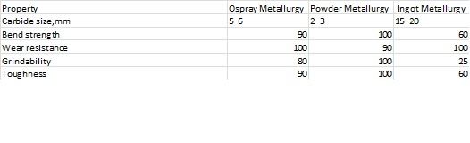

The advancements of Powdered have been well documented. From the following article it gives a nice summary:
Summarizing, the advantages of PM tool steels are a lot and they interest both the tool manufacturer, as well as the end user. In particular, for the End User:

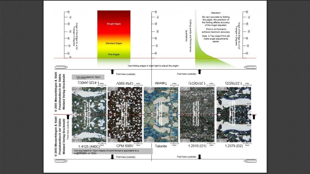

Now, let us put carbide size into perspective. Here is a pdf from metallurgist R. Landes showing the carbide structure of O1, D2, S90V and Tolonite. If one folds the PDF as recommended one will see that the smaller the carbide content the finer the edges can be and the higher the cutting quality and performance will be.
http://www.hypefreeblades.com/files/schneiden.pdf
Some pictures showing the carbide size of different steels:
12C27 in micro structure.

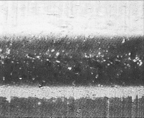

12c27 at the edge
Coarse carbide structure at the edge

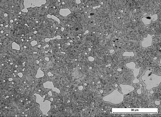

Here is N690, similar to VG-10.
Here we can see CPM 154
images
Here is normal Ingot 154CM
So given all of the above and the information I have read and have referenced many times I firmly believe that a high carbide steel such as CPM-110V, M390 etc cannot have the same toughness as lower carbide volume and size steels. Please provide referenced data or research papers if you do not agree, not materials pdf's as those are for marketing.

... R. Landes showing the carbide structure of O1, D2, S90V and Tolonite. If one folds the PDF as recommended one will see that the smaller the carbide content the finer the edges can be and the higher the cutting quality and performance will be.
Again, PURE carbide forms the FINEST edges, 200X finer than any steel can achieve. Images of poorly formed high/large carbide edges may suggest that it requires higher skill or better abrasives to achieve as fine of an apex (e.g. low micron diamond particles) but such high carbide levels do not prevent the possibility of achieving such fine edges or even finer edges since the harder carbides have the strength in themselves to hold a thinner apex than a softer matrix and martensite (provided you do not chip them out).

P/M steels like M390 provide high toughness, high strength, small carbides, AND much higher wear resistance than their low-carbide ingot counterparts. But they are also more expensive to produce.
