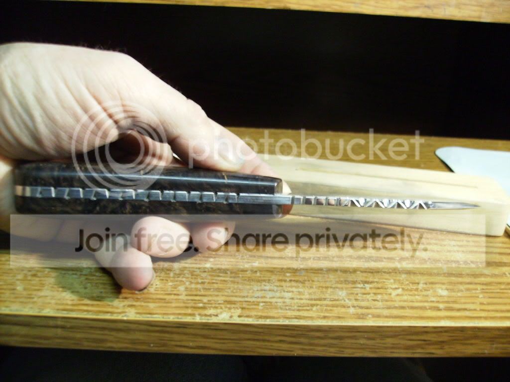

I forgot to mention the files mostly used are flat bastard, big flat mill, a couple sizes round a chain saw file for the ricaso. Iwould get 2 sets of cheap jeweler s files like 5 bucks a set. I dont file to much any more but i know i maybee should. here is a picture of my first knife i finished 2 months ago.cpm 154 stainless steel with a vavona burl handle and brass pins with file work.
