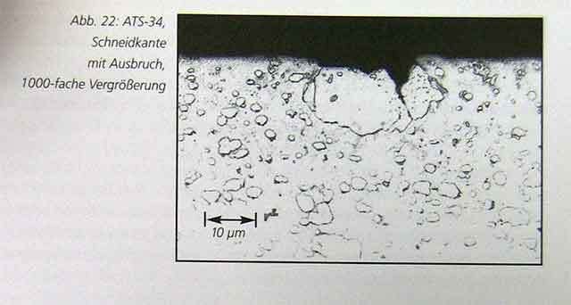

Yes, but generally unless the carbide volume is insane, you are measuring the steel matrix. Now if you are asking if there is a variance in the hardness due to the carbide aggregation of alloying elements which leads to a increased chance of tear out - possibly. You can do micro-hardness tests on precision instruments which may be what you are referring to. Here is an example of carbide tear out from Landes steel book :
The steel looks like this :
The big white things are the carbides. The book is "Messerklingen und Stahl".
-Cliff

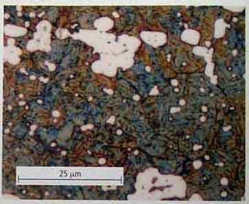

Cliff, while you are on the subject of carbide size, what are the carbide sizes in some other steels, such as VG-10, SV30, and ATS-34?

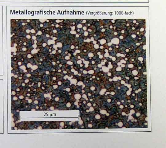

ATS-34 is shown in the above and has carbides up to about 25 microns in size. VG-10 I have not seen the measurements for but will be slightly smaller due to the reduced molybdenum, but since the Chromium is the major carbide former I would expect them to still be around 15-20 microns. S30V is much smaller due to the P/M process, less than 10 microns. Here is a shot of S60V :

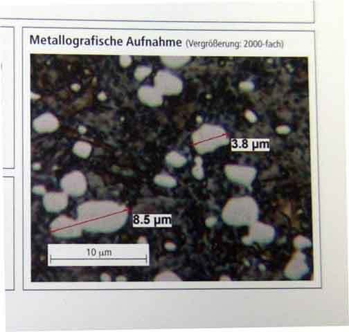

S30V will have a lower carbide volume so expect less segregation (clumping/intersectioning). Here is RWL34 (CPM154) :
Note the huge difference between this and ATS-34 (same steel, one is ingot and the other P/M). Note still though that there are many ingot steels with much finer carbides such as AEB-L :
So don't fall for the P/M line blindly. When the steel is of high alloy, especially high chromium, it will still have very chunky carbides, even if P/M as RWL34 clearly shows.
