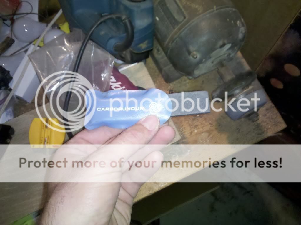

Actually, I found a Smith's tool and one of my dad's little grinding stones. So maybe I start with that... I do like the idea of trying freehand.

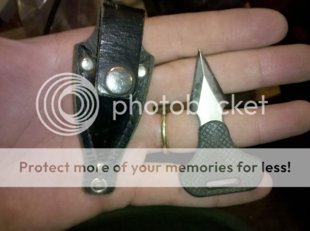

And finally, when it comes to a practice beater, what could be better than a gen-u-wine 80's Tijuana pushknife from the time before tacticlol was tacticool??!?
