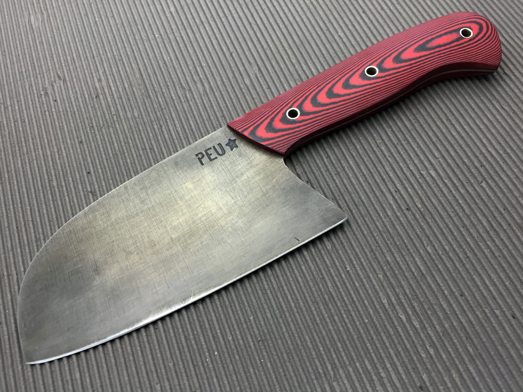

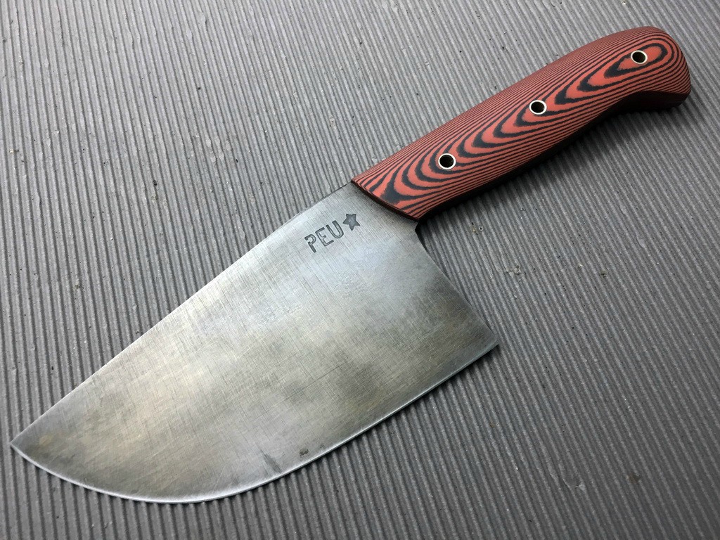

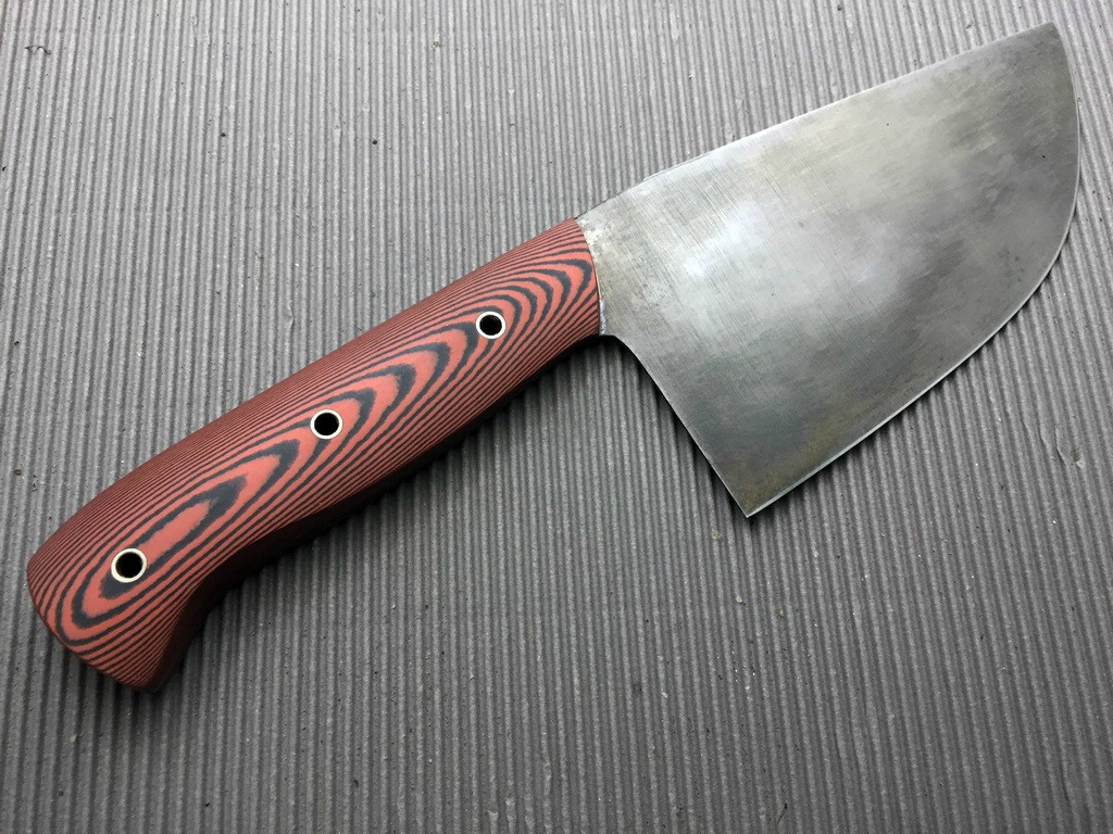

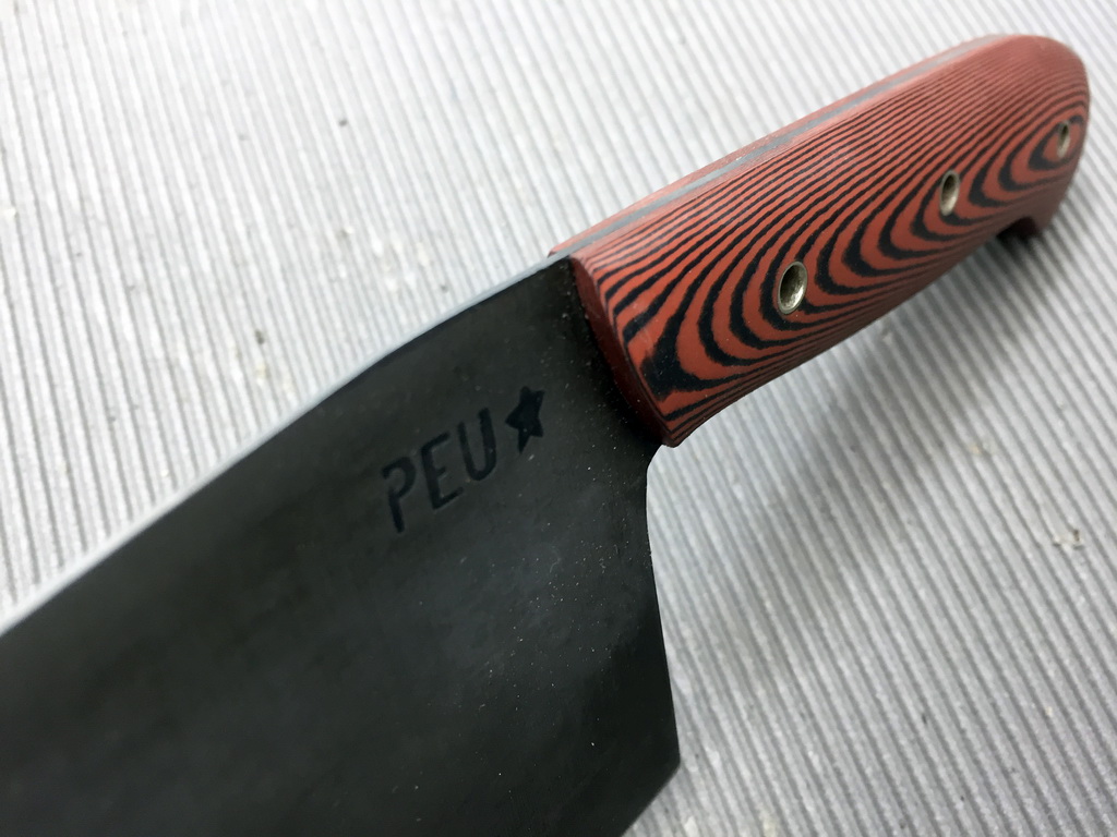

1mm thin blade, its razor sharp...

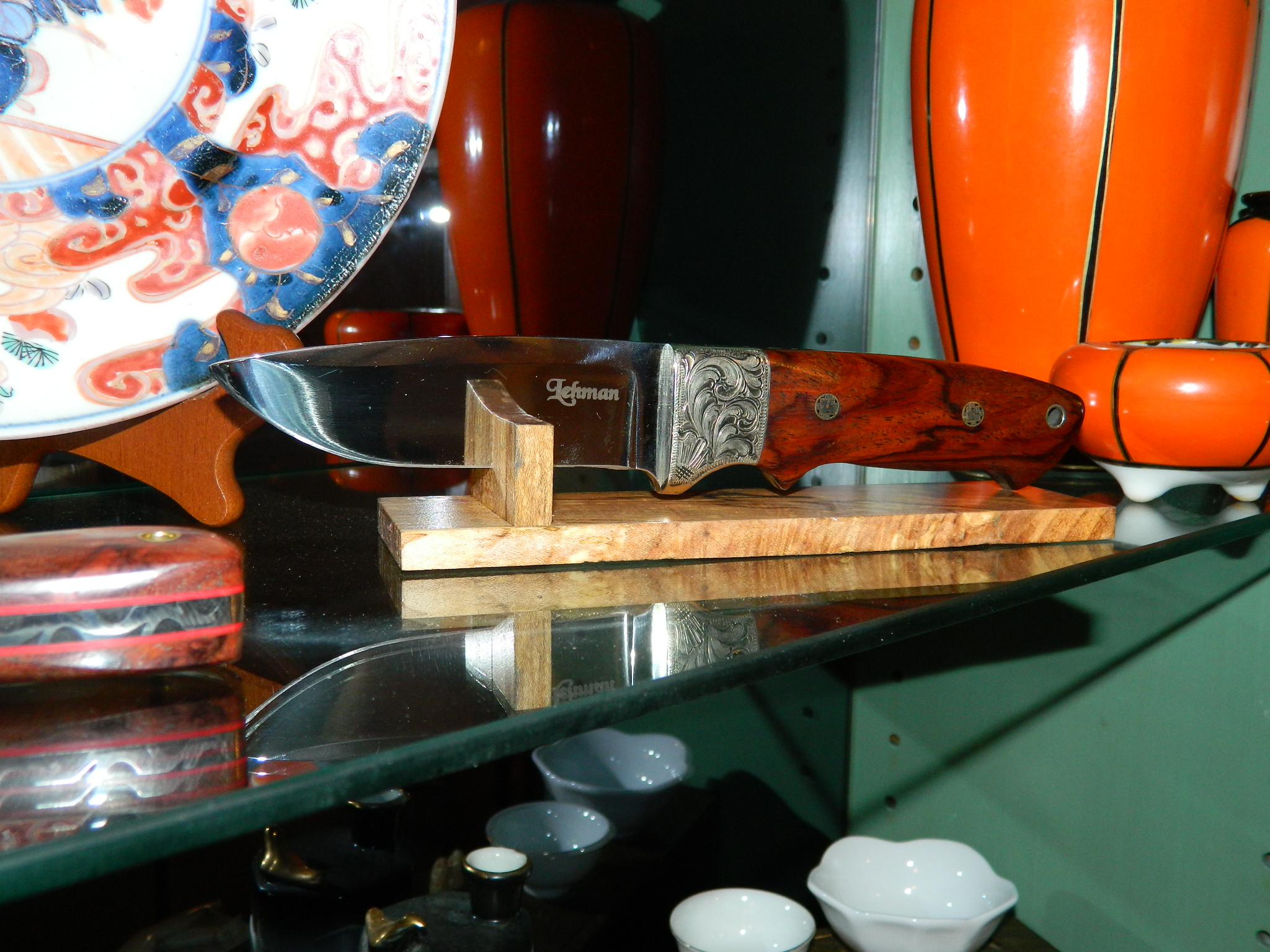

Mike, I love your knives. I make similar patterns based on Loveless drop point except I hollow grind mine. Beautiful!! Larry Lehman

1mm...wow, that is thin ( .040") I bet it cuts crazy fast.
Yes, very thin, I got some samples of unprocessed saw steel from Sandvik, made some tests, measured 64RC post hardening and 59RC after tempering, so it was good blade material.
Being so thin I tought its going to be a PITA to harden straight, but it was super easy, removed it from the oil and sandwitched it with my stainless setup with a 8kg weight on top (~17lb) came out nice.

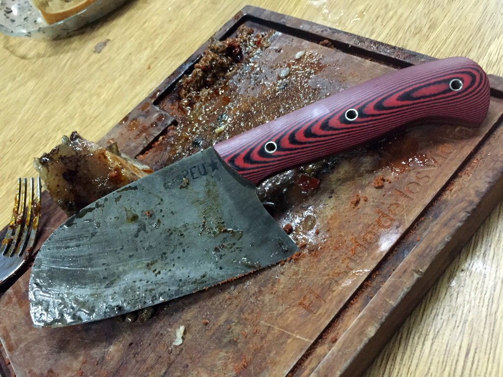

From the same sheet I did this mini santoku, also with paper micarta.
And I properly tested :D

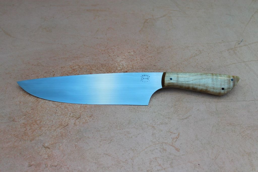

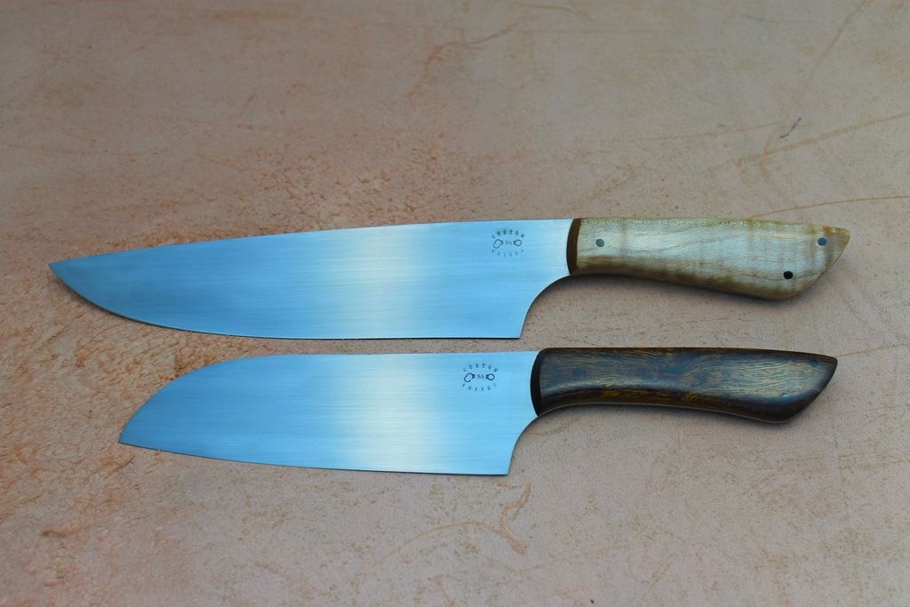

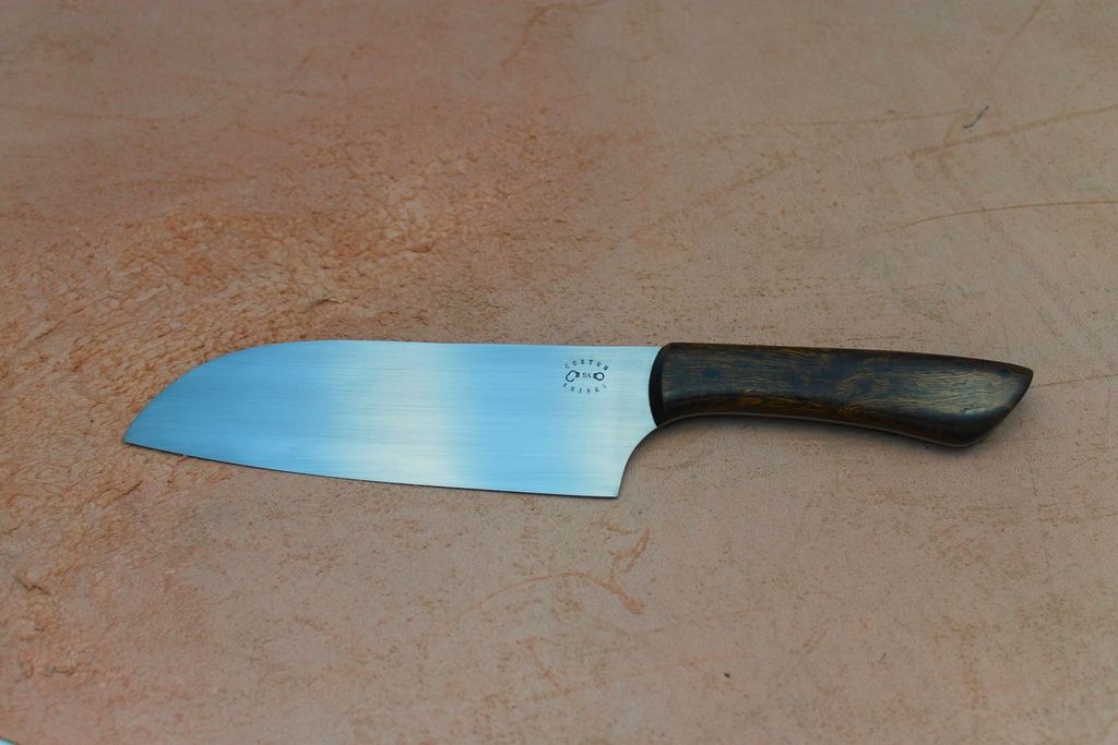

Here are a couple of kitchen knives for two of my coworkers. 15N20 steel, .065 thick, both with plungeless grinds. The chef has a wide curl maple handle, while the Santoku got a desert ironwood handle.
These are the first two out of my shop with the new etched logo (I hated that steel stamp) :D
After these two I'll be completing a couple of forged blades, and my first san mai blade.
