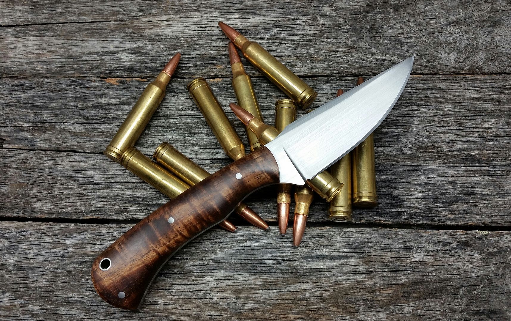

after finishing 12 matching steak knives i was ready for somethign slightly different
XHP koa boning/steaking knife
Butch,
Thats a beautiful and very functional looking Fillet knife!:thumbup:
The pattern in the Koa compliments the upswept in the blade!:)
Butcher steak/boning that thing is beautiful. I would love to be able to get tips like that. I always end up burning them up. Any tips?

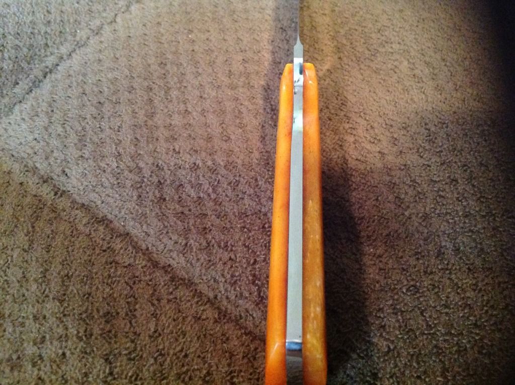

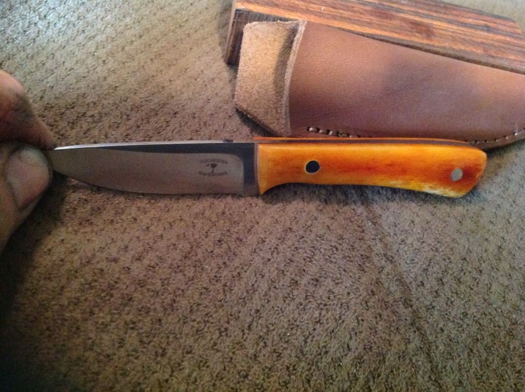

I think I'll call it the Black Diamond Rifleman's knife. An old black diamond file, through tang construction. Amber dyed elk antler, brass guard and buttcap, and a copper ferrule. All of the metal fittings were jeweled with an engraving pen.
Just have to etch my logo, sharpen, and make a leather sheath.
This is the last knife I'm making until after I move into my new place!
not ground to 0 but it was hollow ground with one of nates 48" platens
hot tip for not burning up the tip treat belts leik they are free and dont hog with finishing belts. also having a water spray bottle to wet the belt is a huge help (so long as the belts are rated for wet use
