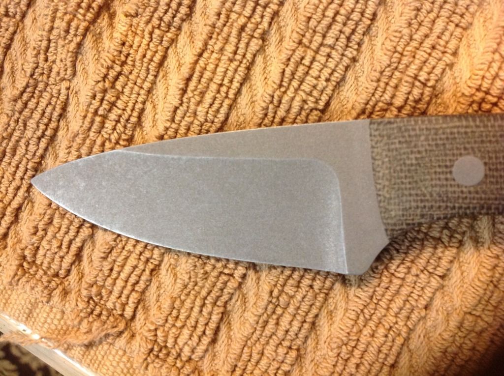

This is a blade I made a while back and wound up scratching it right up next to the front of the handle on the ricasso. It was too close to be able to fix. I had already removed these scales once after grinding through head of one of the corby bolts. Anyway, I wasn't taking them back off again so I decided to try bead blasting it. It was completely assembled and finished. I bead blasted the whole thing and then threw it in my vibratory tumbler. I think it came out very well and I like the finish. By the way It's 440c.

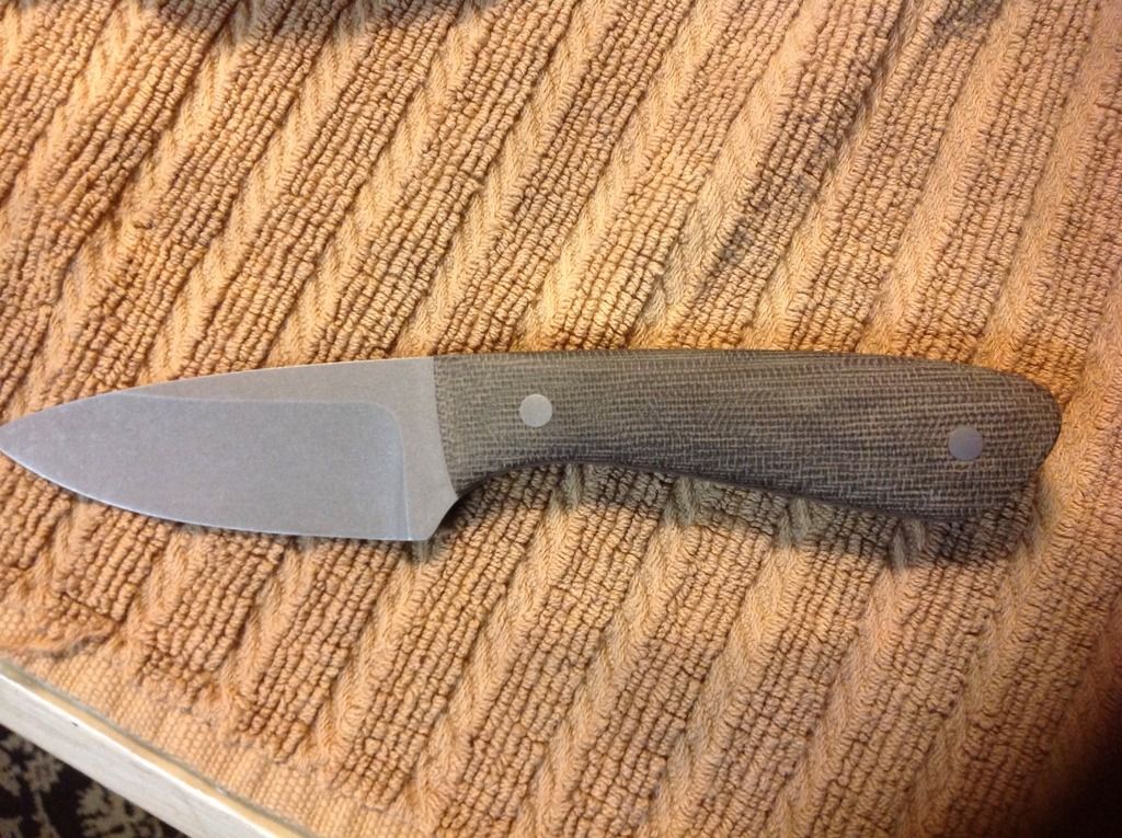

I re watched the Wheeler handle shaping videos for the Joe Bowies. I did this handle just today and Whoa Nelly! It feels awesome! Just used the slack belt and my 3/4" small wheel horizontally and then hand sanded and buffed. It feels amazing. I'ts so good I don't want to give it away but I promised it to someone for LAST Christmas so I guess I have to :)
I have another of the exact blade so I am going to do one for myself though.
Anyway, taking the time to go through those videos helped me a lot.
- edit - that front pin is not low, looks weird with my finger there or the camera angle or something.
