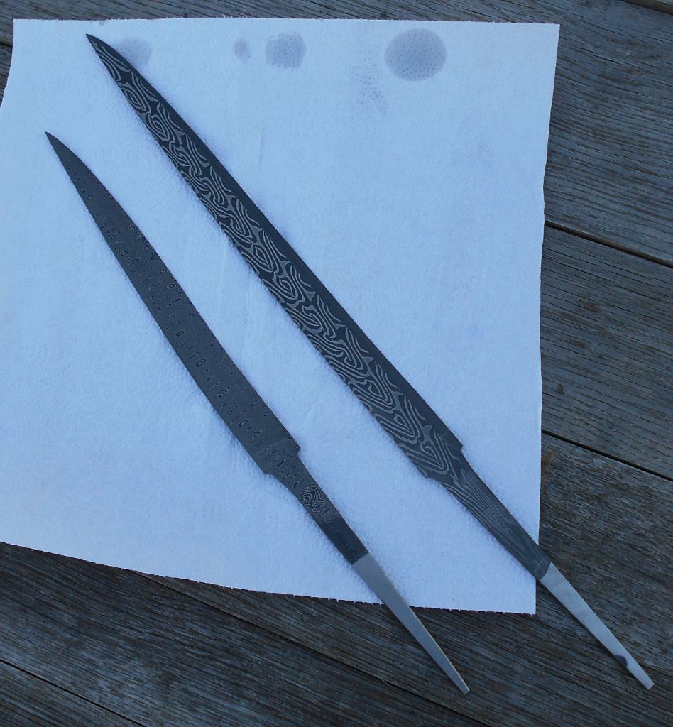

I think, somewhere back around page 8 of this thread I posted these after forging to shape, finished them up yesterday. Two patternwelded fillet blades, 8" and 11" cutting edges, the small is a 300ish layer ladder pattern, the longer one is viking style...:)
They are both 3/32" thick at the ricassos with some serious distal taper, and flex well (I'd call them a medium flex). They both picked up some negative sori in the quench but I'm happy with them even with the recurve. The customer wanted finish bare blades, he'll be putting the handles on them.
Now on to a patternwelded broadsax, my next project...

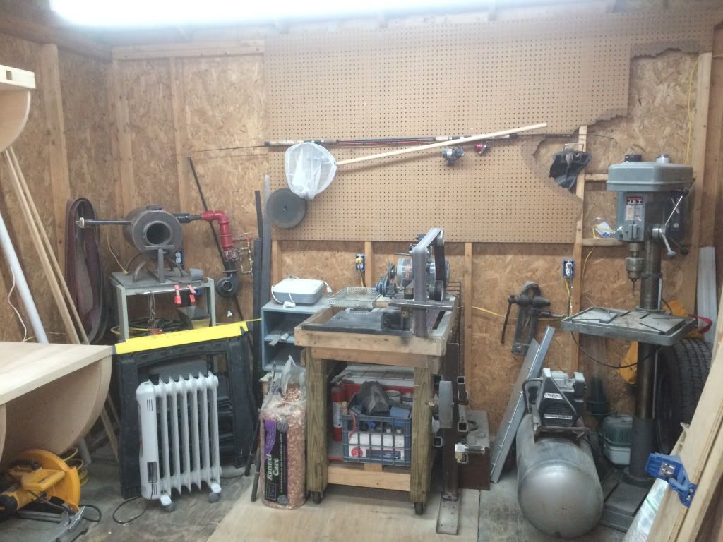

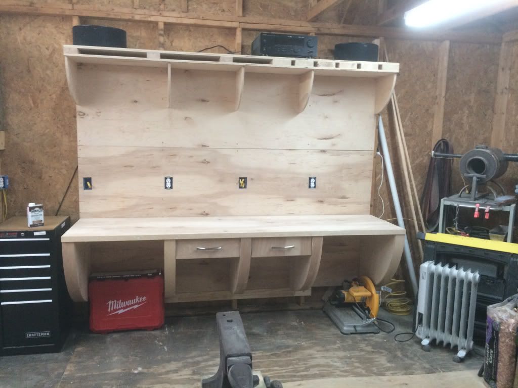

Hey guys,
I ordered a new grinder to replace my NWG and figured I'd build a new bench to hold it and a few other things.
I may have gotten a bit carried away.
I need to get a service providers membership so I can sell the NWG to make room for a LG power hammer.
