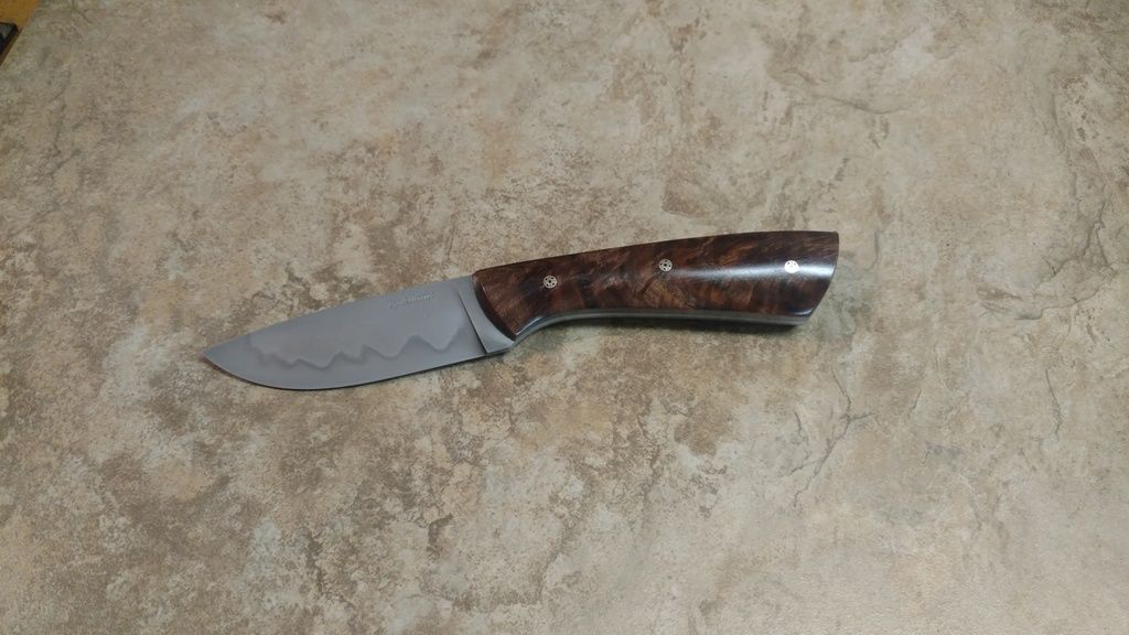

Guys , is it good or bad if blade after tempering still scratch glass ? I have no Hrc tester ...........
It is a very good starting point.
It does mean you have reached full hardness.
The unknown it's still the carbide and grain structures and if the high working hardness gets enough thoughness to sustain its intended use.
You should sharpen the edge and see if it cuts well without microchipping. Do it before installing the handle, so you can walk in through tempering temperatures until you will be happy with edge retention.
The brass rod test will tell you nothing you don't already know.

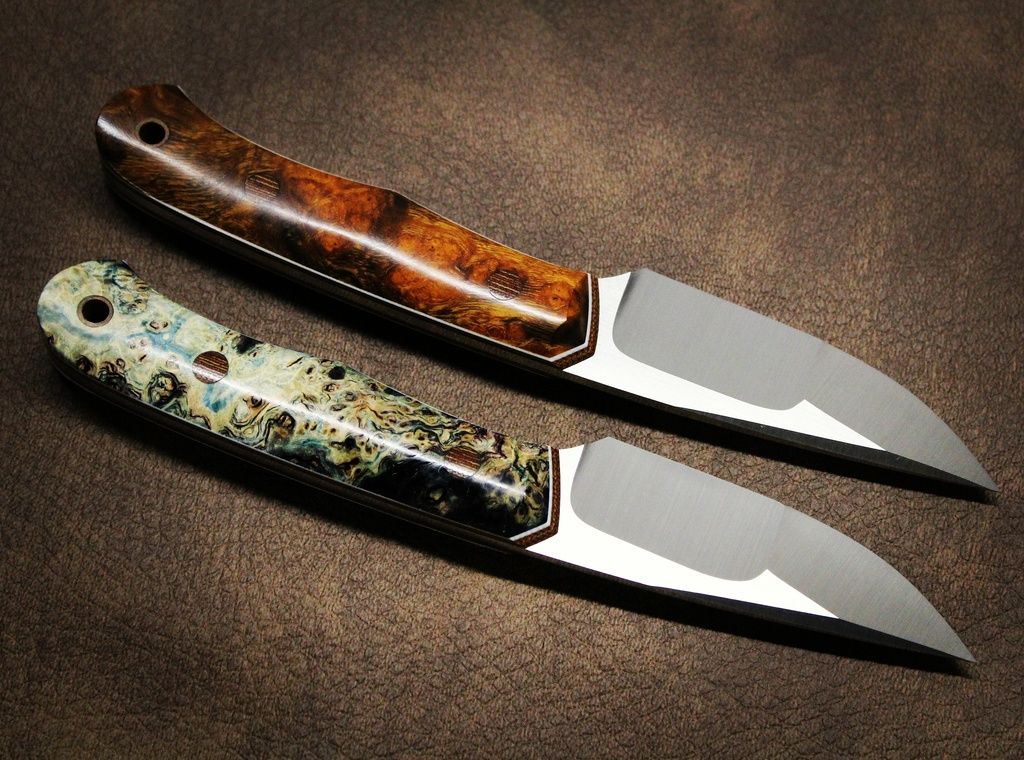

Beautiful, clean knives. I like very much the sleek and elegant shape of the handles
How many coats of what oil? Tung? Fantastic hamon!
Thanks! Tru-Oil about 14 coats.How many coats of what oil? Tung? Fantastic hamon!
