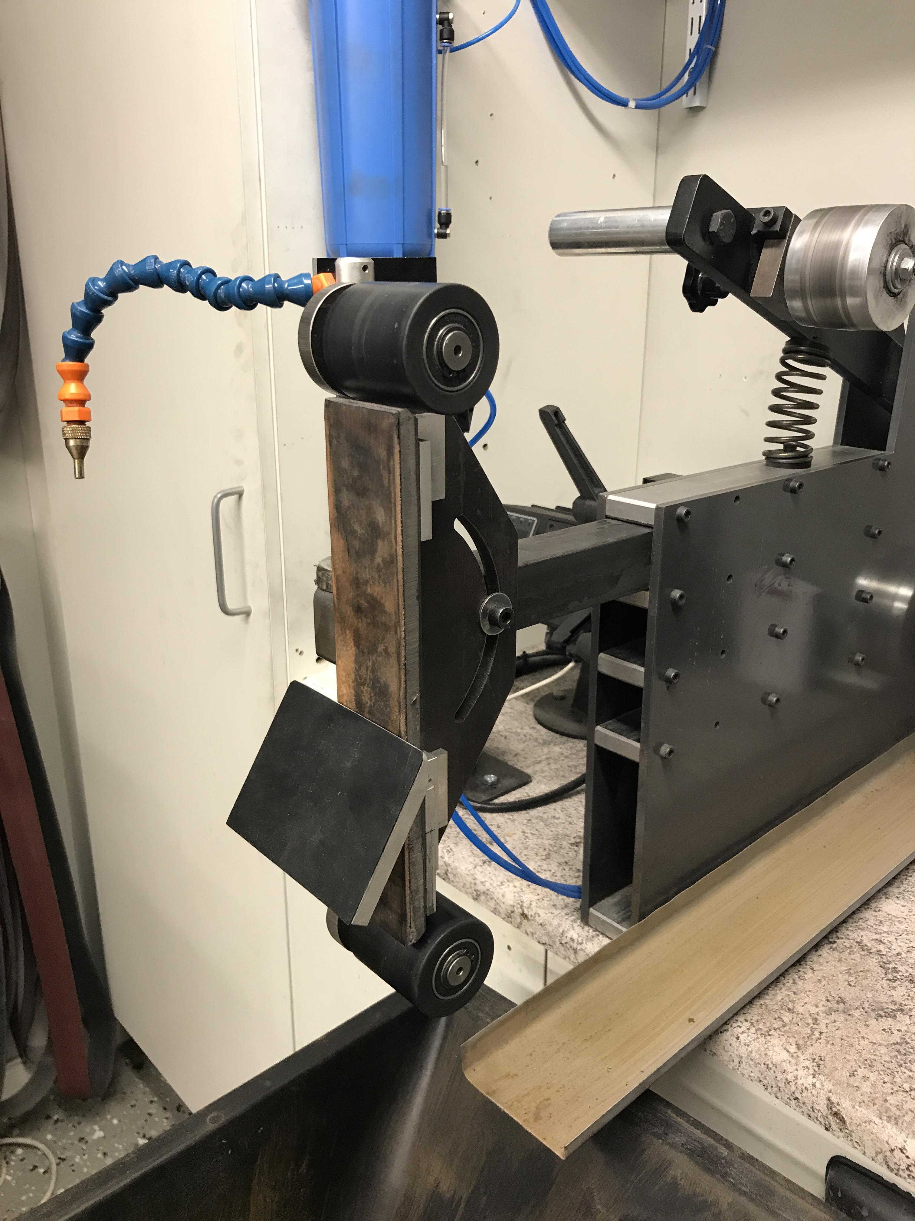

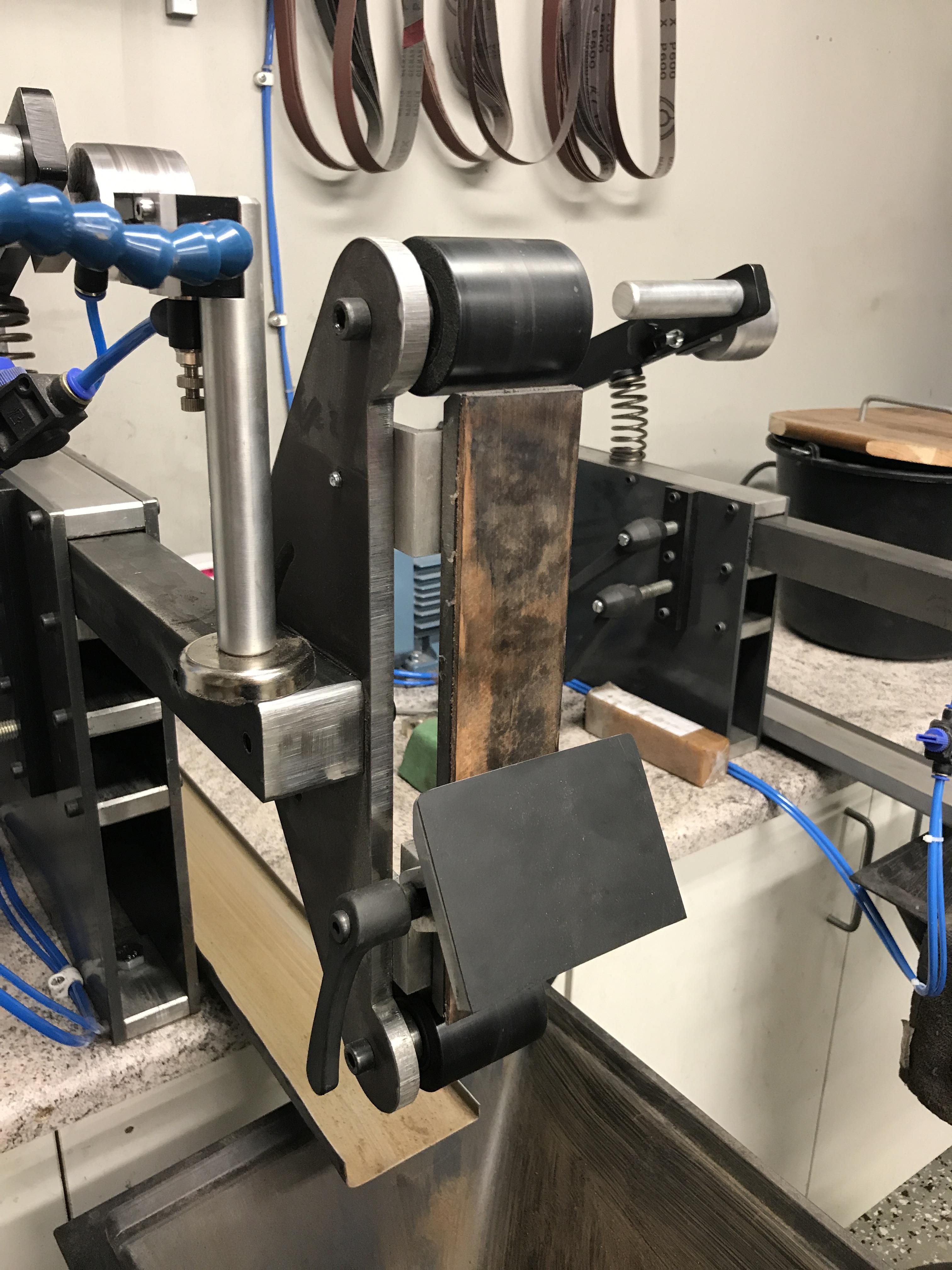

I just finished another flat platen, this one with a leather platen. It's for VS wet convex sharpening. It makes nice convex edges without rounding it like a ordinary slack platen.
Tried it out on a couple of blades, it works great! I create the initial edge with a 120 grit AO belt and then move to Trizact (the thin one which works wet). I strop on a thin belt (without abrasives) loaded with green compound. It gives me a really quick and nice working edge.
I use it for quick belt sharpening on my utility knives. For a more distinguished edge I use my WEPS with diamond stones and 3M lapping films.
Edit: I forgot to mention the workrest, it's for referencing the sharpening angle. I set it with an angle cube and then reference it for freehand.
