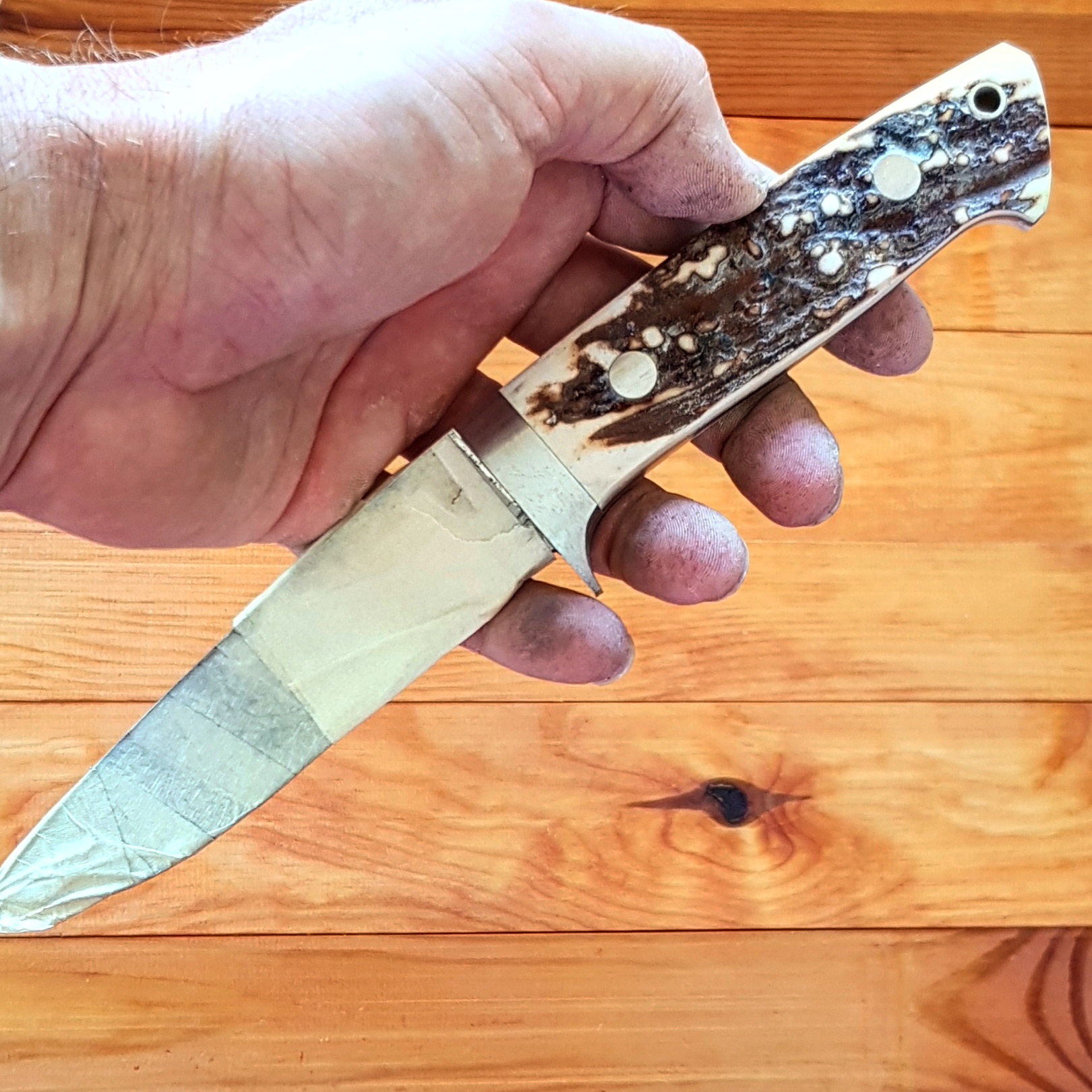

These were salvaged from an M9. I'm drawing them up today to make my own. Not sure if I will for this particular one or not. But definitely for future ones.
Thinking about doing it for this one in particular to make a custom shaped lug receiver, closer to the antlers natural shape.

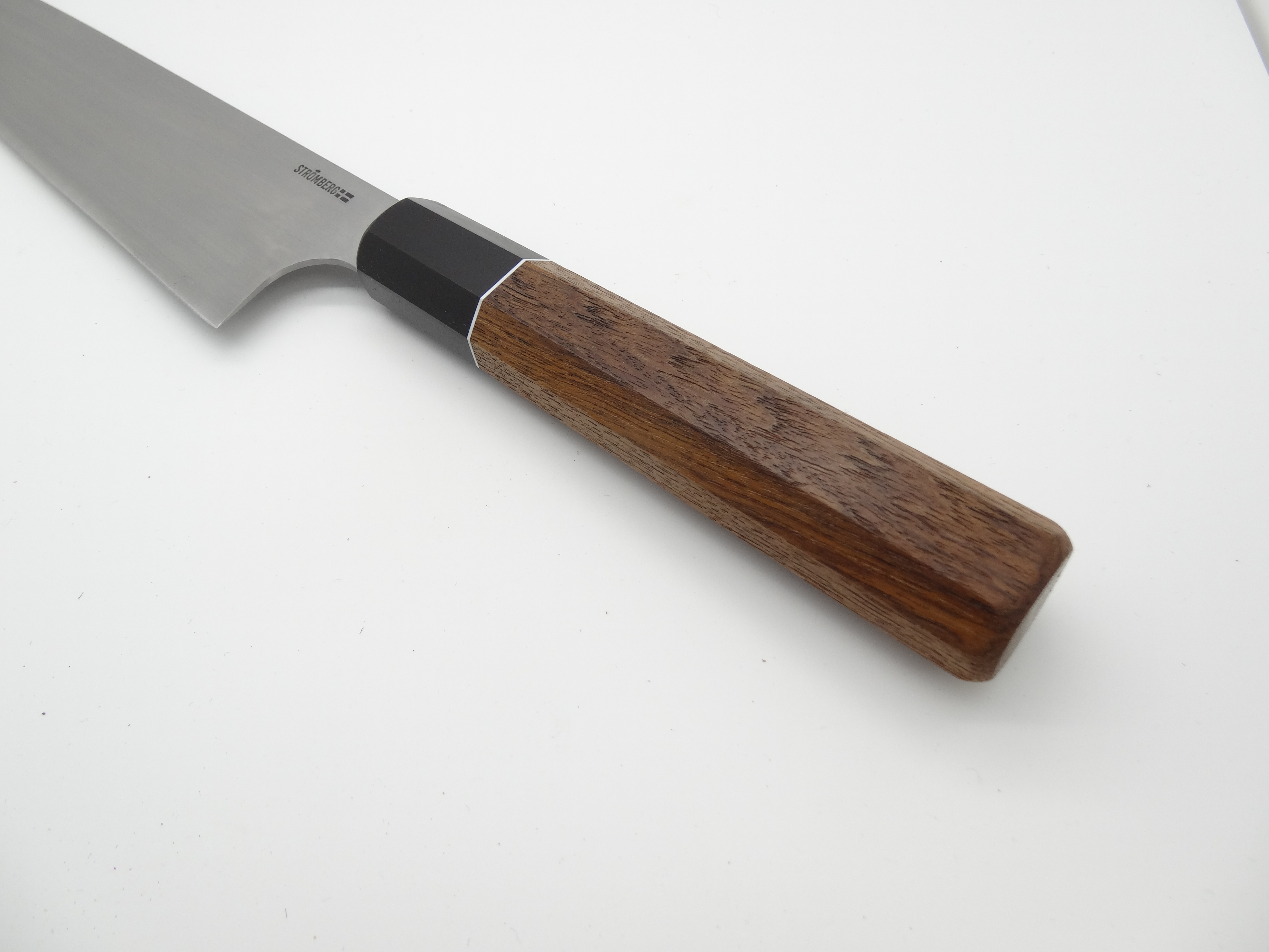

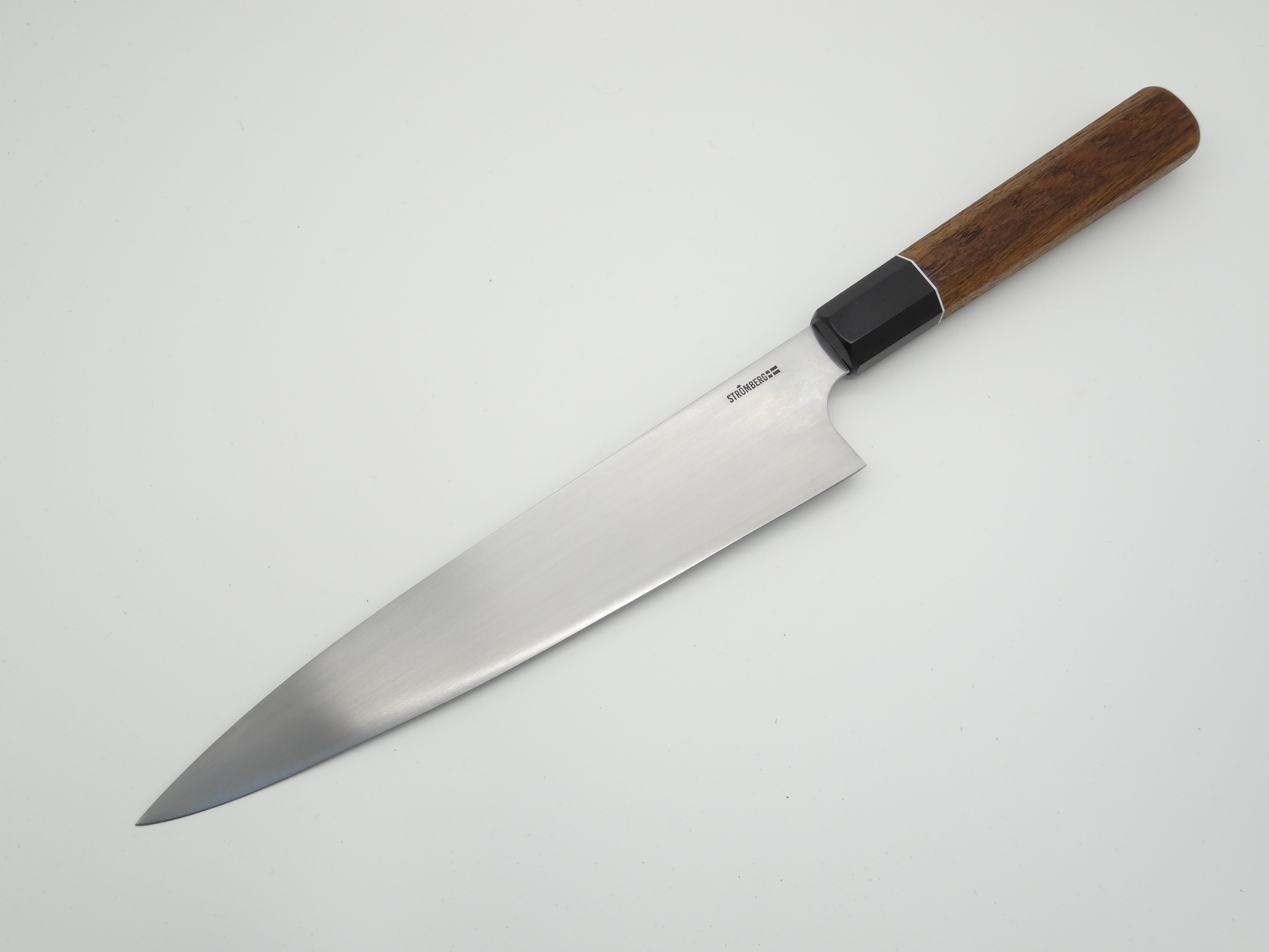

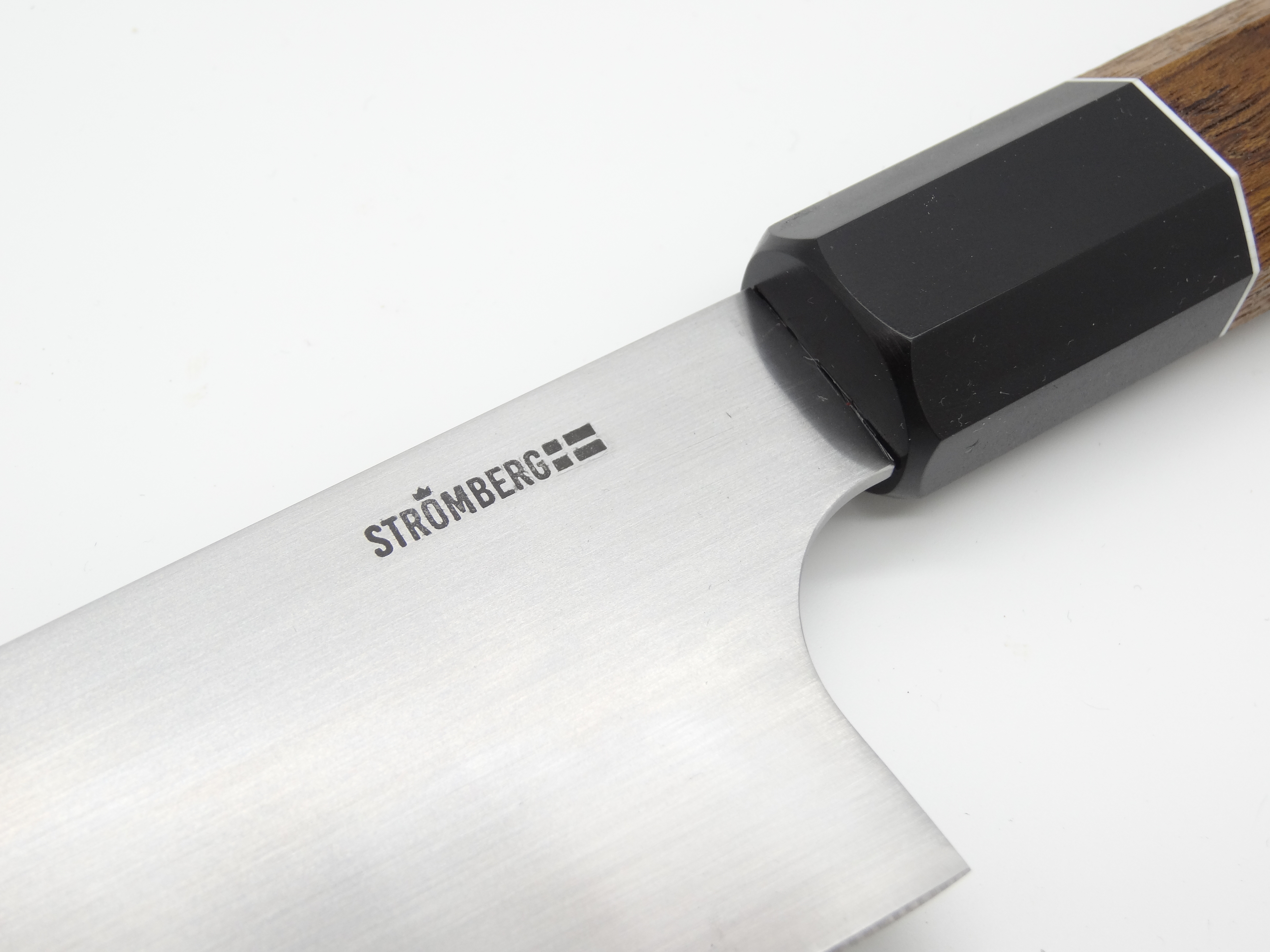

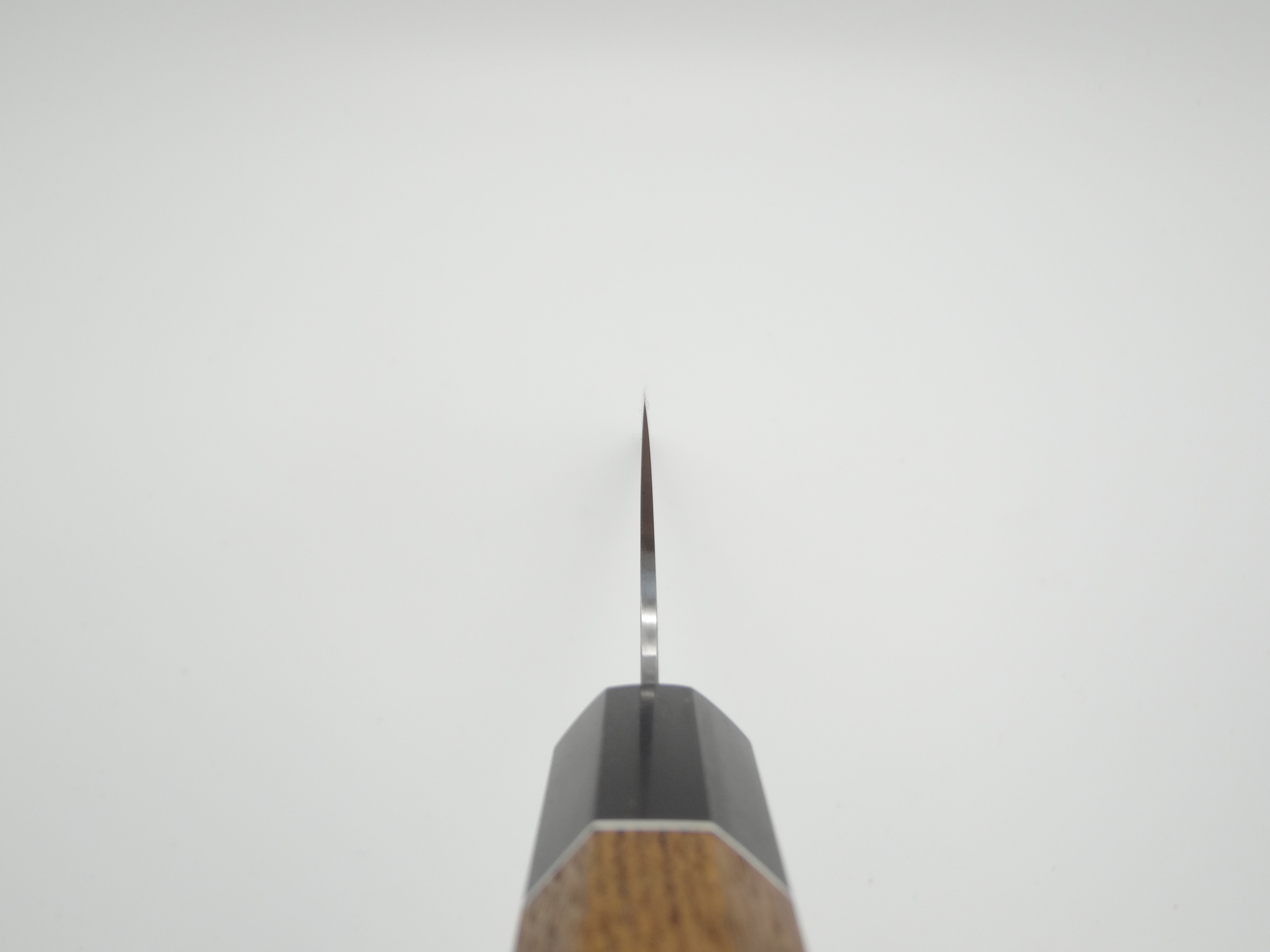

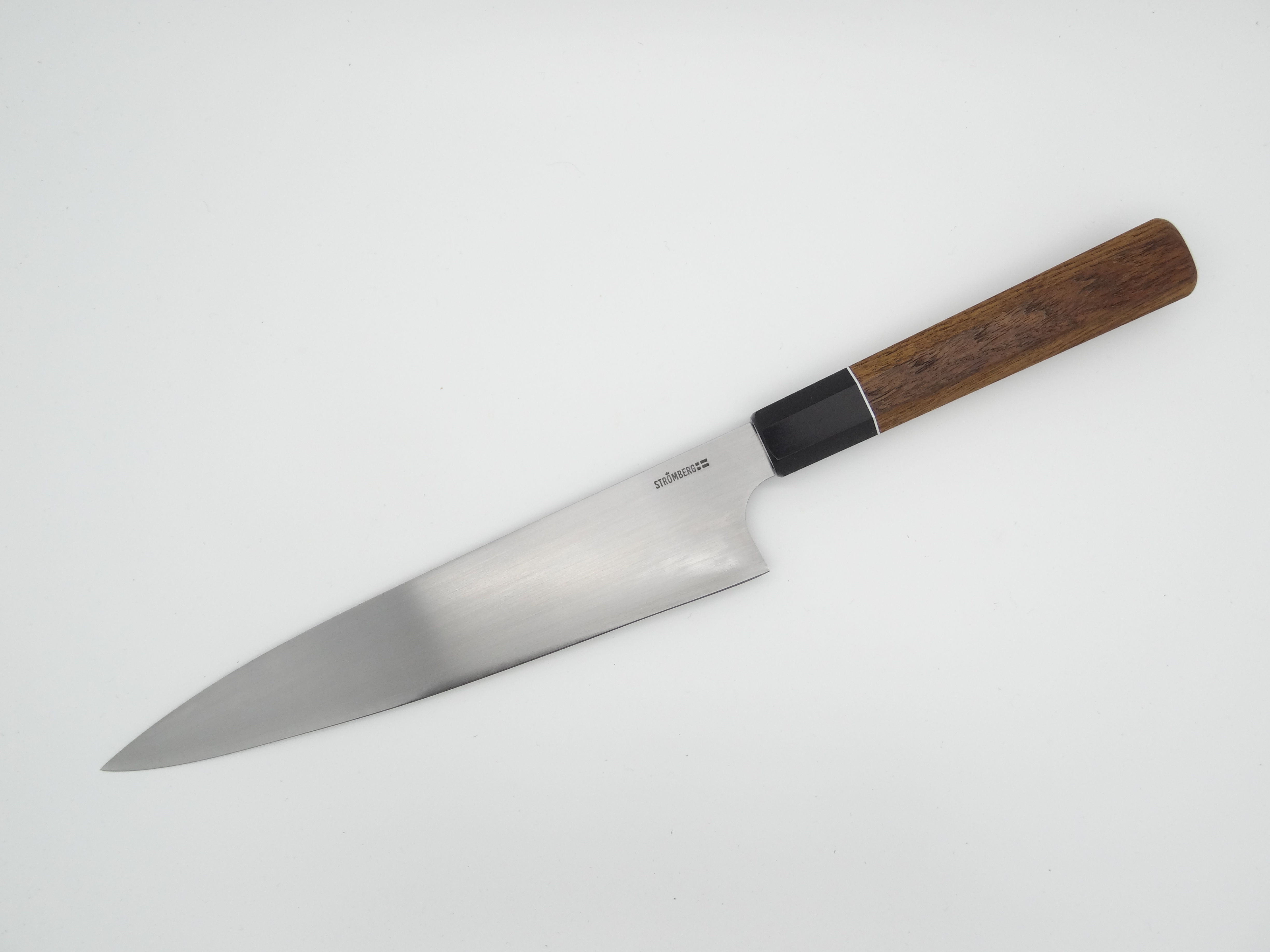

Here's my latest. It's a Gyuto 240 mm in O1 at 63 HRC. The spine at the heel is just under 2 mm and it tapers to the tip. It's a full flat grind combined with a convexed grind towards the edge.
The handle is Micarta and mahogany and has a slight taper.
