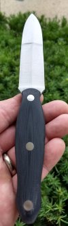

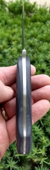

My brother asked me to make a knife for the local police chief. He said he "owed him a big favor", ( I can't wait to hear the story). Anyway. The idea is a last ditch kind of backup piece to be worn small of back horizontally. The blade is .196" AEB-L, ground hollow from ricasso to mid on a 6" wheel. The remainder is a flat/ saber to the tip. It's my first hollow ground double edge. He was asking about a straight up dagger, but I thought the practical cutting ability of the hollow ground section might add some utility. The tang is tapered and the G-10 scales are secured with Corby bolts. I still have some handle finishing to do, and may thin it down near the butt.

That's awesome! Having both grinds probably would help add some utility function, as is that thing looks just great. I like the idea of thinning the butt out a little bit, but not by much! What's it hardened to?

Thanks for the comments. Hardness is 59RC.
