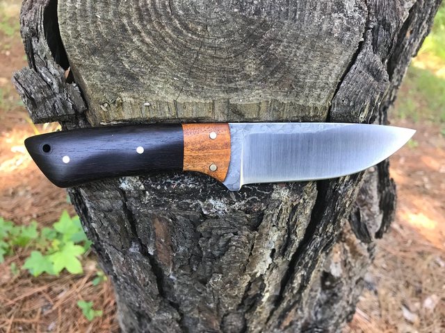

Knife #6
Give away, Birthday gift for a family friend.
Blade is a manufactured blade so I can't take any credit on the any of the metal work. All of my efforts are focused on handle construction and finishing. I have a long way to go.
handle material is Dark Myrtle, hardware is stainless, G10 liner olive drab
This was my first attempt at using a powered belt sander (HF special 1X24) and followed by hand sanding (150, 220, 500, 1000, 1200) and a quick buff (blue & green).
Finished with Danish Oil.
Lessons learned:
- First attempt at using a powered belt sander to shape the handle, aggressive little sucker even with 120 grit belt. light is the word of the day.
- During glue up, q-tips with mineral spirits aren't going to cut it. Need to find something sharp to get in the corner to clean the glue out.
- How many times do I have to tell myself, use flat edge/surface when profiling the handle?
- The last 5% of effort, can destroy the first 95% of work. Be careful what you set the knife on to finish up the hand sanding. You might just introduce some creative 'character flaws'.
- Wipe the finger prints off when taking pictures.
- Learn to take good pictures
Try popsicle sticks, and grind a sharp point on both ends. Soak in acetone and flip or regrind point as needed. Picked up this tip here (forget from whom, sorry! )

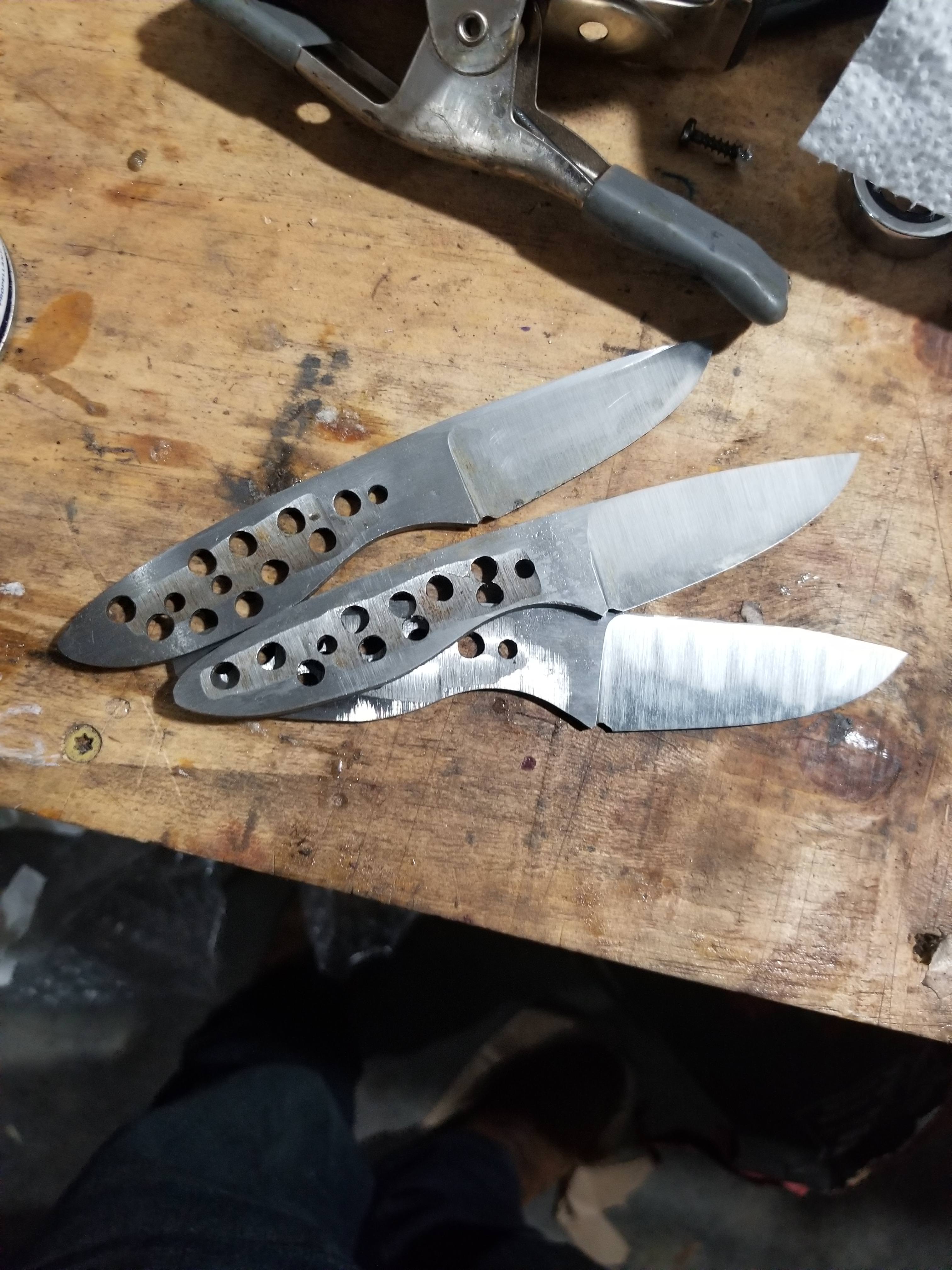

This is the first knife I’ve ever made. Just wanted to know some experienced knife makers critiques and advice. It was made from an old file. I used a charcoal forge. It still needs a heat treat, a little more fine polishing, an edge and a handle. Any advice would be appreciated. https://imgur.com/user/nateenwheeler2
How come some of you guys drill so many holes in the tang?
Better epoxy adhesion?
