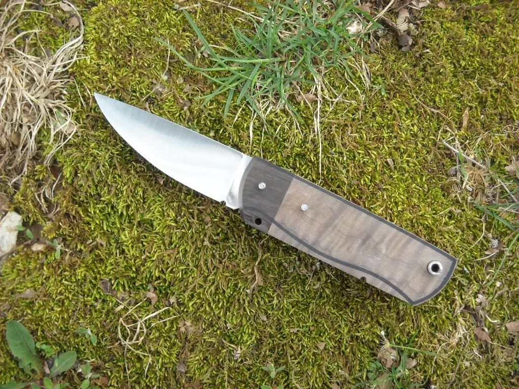

Yes, I couldn't seem to get it into focus. Oh well, like I said, hopefully I can do better when it's finished. This one is going to be quite elegant (if I do say so myself). I've already dubbed it the "Gent's EDC". I think Stacy would be quite proud of me with this one. It should cut and slice like a laser.

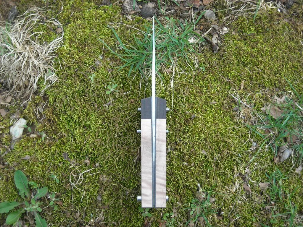

OK. Managed to get some "slightly" better pics.

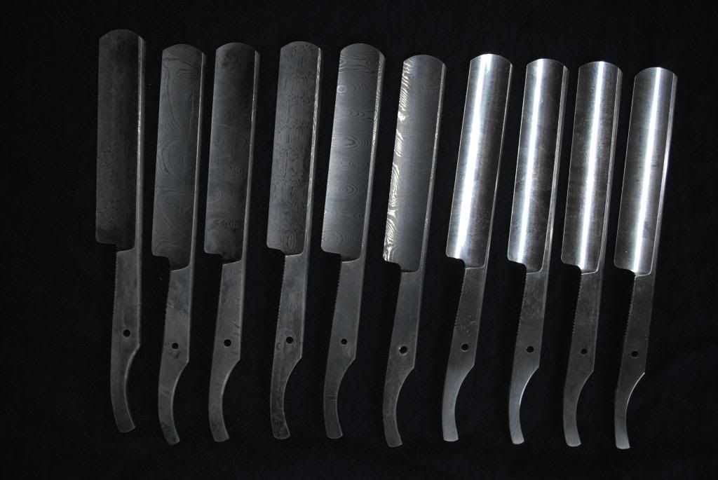

Another small batch of paring knives in 15n20. They are currently heat treated(pre HT in photo) and are awaiting the grinder.
