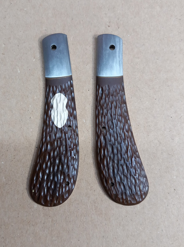

This slipjoint just didn't work out. But it did teach me a lot about tang geometry.

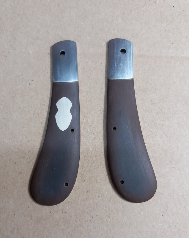

A good excuse to try one of "those" ideas; a paper micarta shield in a paper micarta scale and jig the lot.
I still like the idea but the shape of the shield should have been skinnier for it to work.
I'll finish it as a user for myself and make a new one with a better tang.

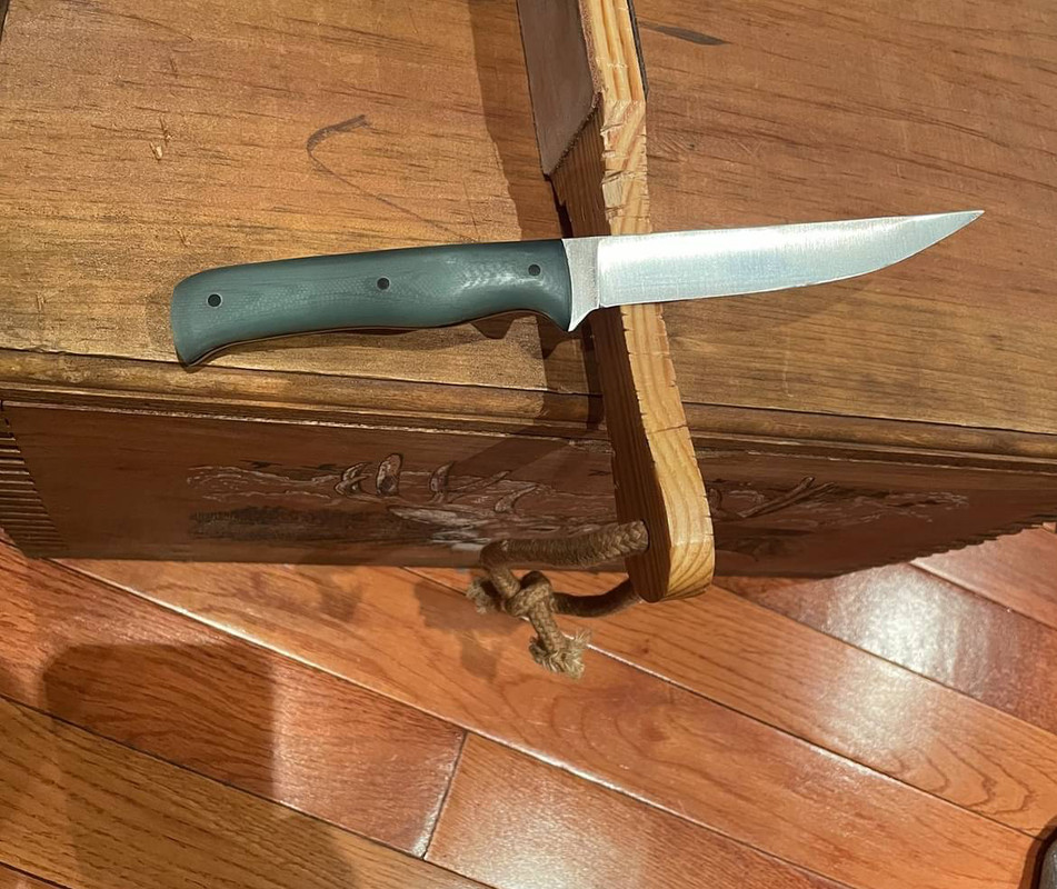

been pretty under the weather, but got some shop time in today. Slowly, but surely...
Just needs final polishing and sharpening. Has anyone done a differential edge, like 70/30 on a kitchen knife? Would that make it easier to cut even slices or would the edge be less durable? I grind to about. .015 before I sharpen so the edge has a little more support, I put a 15deg final bevel on my kitchen cutters.

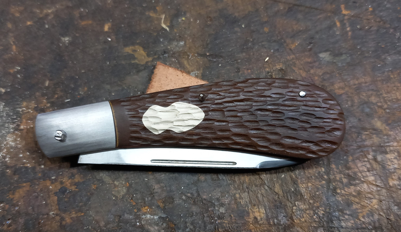

Farmers Jack inspired from a Henckels pattern in 1095 and hand dyed/jigged bone. I scanned, then made a drawing, then in the process somewhere I scaled the drawing a little shorter/fatter. So I am calling dubbing this a "compact" Farmers Jack
This was a lot of firsts for me. I would never have done it without encouragement of the Farmers Jack super collector wlfryjr wlfryjr .
-First double blade single spring
-First crescent nail nick with fly cutter
-First mill relieved liner
-First jigged bone
-First dyed bone
The blades clear with only offset grinding. There is no catch bit and there as no krinking involved.
