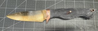

It’s supposed to storm tomorrow so I decided to rough the handle in today while I could keep the shop opened up. I wish I had started the palm swell about 1/4”-3/8” farther forward. It’s by no means uncomfortable but it looks a bit off. I ran the hardness down too. It was around 64HRC, now it’s between 60-61 HRC. Preliminary fit up looks pretty good. The flow is a little off but I knew it would be when I substituted the new blade in. I think I can get it pretty close though. I’ve learned a ton over the past week working on it.

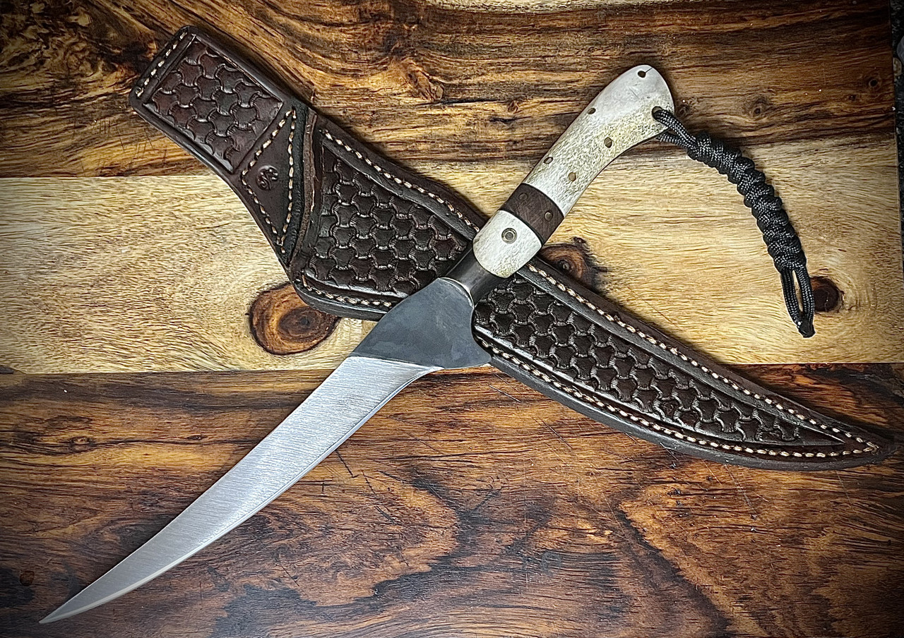

It’s been too cold lately for me to forge otherwise I’d try my hand at making a filet knife with an integral bolster. To me, those always make a filet knife look neater.

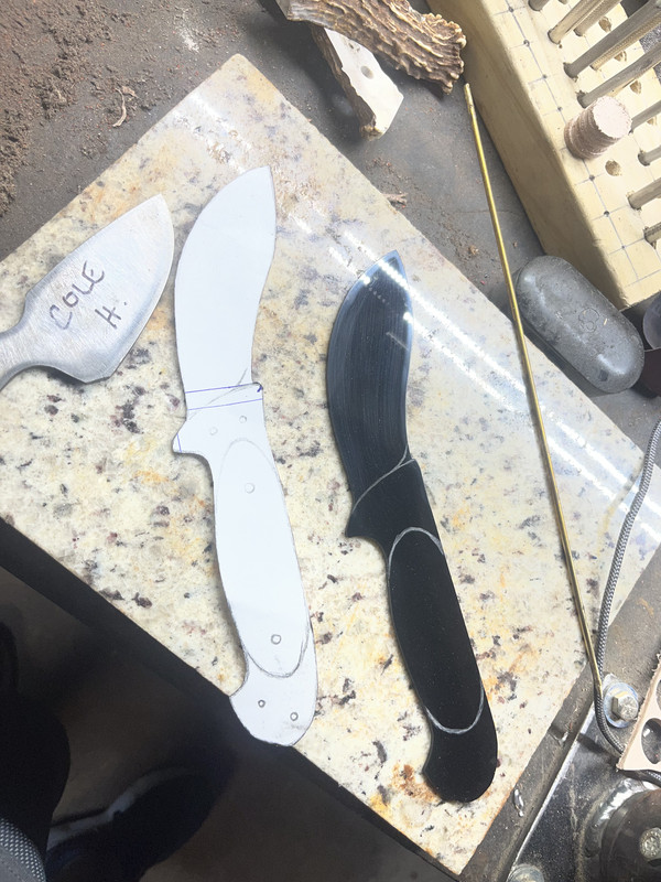

Roughing out some prototypes. I spend time in the shop or doing research/design every day but I think it’s been about 6 months since I’ve actually finished a knife… Hopefully before the year is over something will work out.
Ever thought of buying acrylic board off of amazon and cutting out those shapes to save wood, etc? I now use those sheets to make my most popular knives. You can feel it in your hand and visualize it. Then if it gains popularity, you can store it for the next time.
I generally use something like that or aluminum when I make my final template. I’ve been working out the handle height and angle on the chef’s knife so I’ve cut it out several times as I’ve tweaked it. I save scraps of plywood or anything substantial enough to help me get a feel of how the geometry will work while I’m developing a pattern. That helps particularly on things like chefs knives. It allows me to adjust things and make sure my knuckles don’t hit the table and it still stops solidly at the heel with a normal rocking cutting motion.
