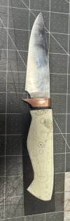

That is now a shop wharncliffe. Grain looks coarse to me from the photo.
It is coarse. That knife was never going to leave the shop anyway. That’s a piece of steel I couldn’t get to harden so I finally brine quenched it on the 3rd or 4th attempt. I wasn’t surprised it looked a bit coarse with that in mind. I didn’t do anything to refine the grain because I didn’t trust it at that point. I was just using the blank to practice guard/handle fitting and was going to keep the knife as a personal user.
The good news is I think I found a blank or two that I can fit to that handle so it won’t be a complete waste.
