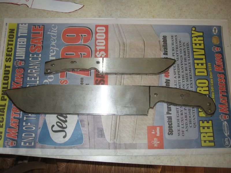

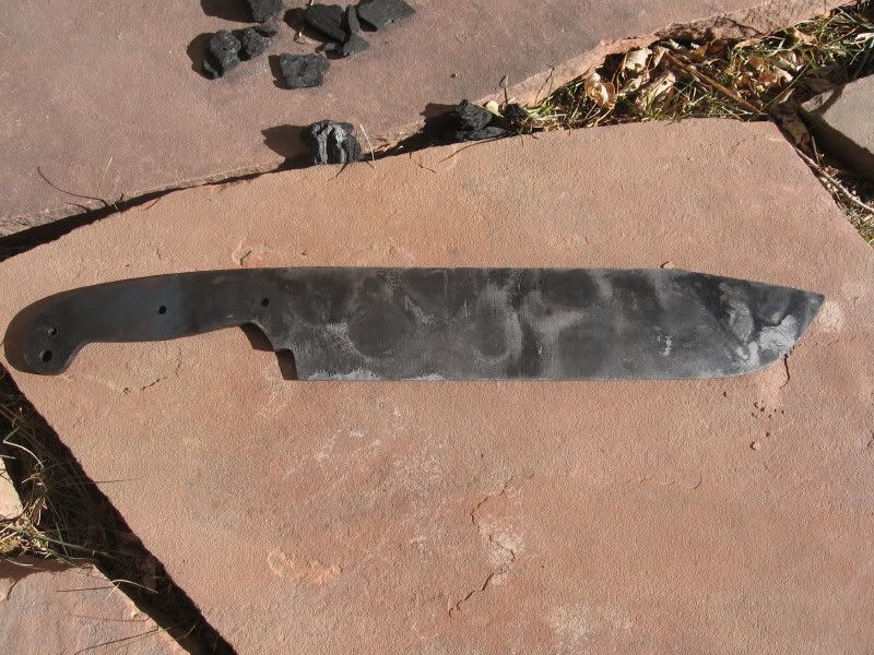

Said I would post some pics, so here ya go. These are both custom designs sent to me to be made. kind of standard stuff.
The smaller blade is a 6" blade out of 5/16" thick O-1. Going to be a tank and the larger one you have already seen. Just finished the rough cut out with the angle grinder. Now to finsh the shape and pregrind. They will be preground with a flat bevel, and then full convexed after heat treat.. I'll show ya.
It's going to be a beast that's for sure. I am looking forward to watching your progression. Thanks for the pics.

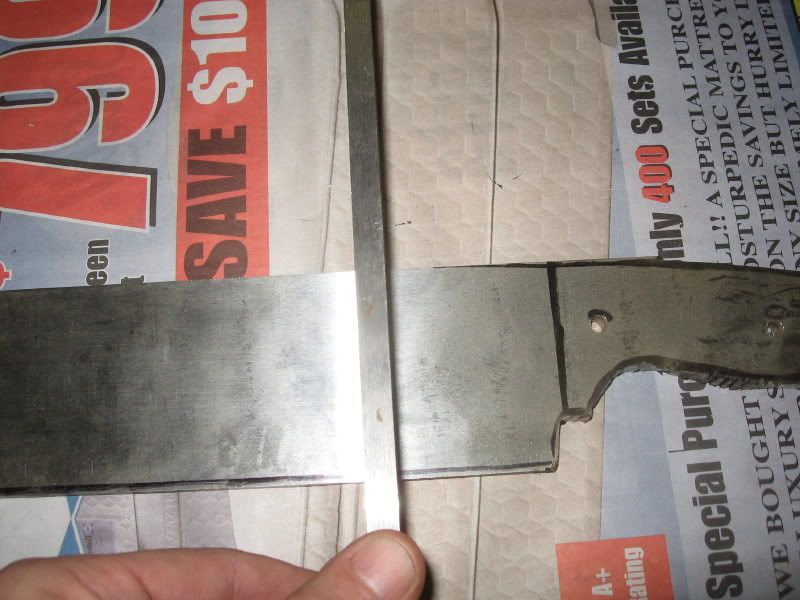

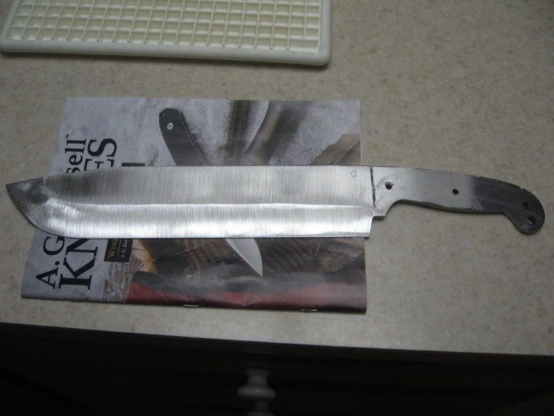

Arrrrrghhhh Pregrind done and ready for heat treat.. Were are the zombies????

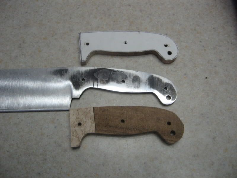

The fella I'm making it for wants Cocobolo bolsters, Mesquite scales with a white liner. It's part of a pair. If it comes out of the forge with cool scale, than he may leave the flats primitive. If not than it will be fully convexed and polished.. It's a monster at 12.5" blade length, 2.5" blade height, .25" thick O-1.. it has to be about 2.5lbs.
I've seen this done before, though why do you grind it partially like this before HT and then after HT finish it off if you want a convex grind? More specifically, why not just grind closer to what the final convex will be? Looks good though!

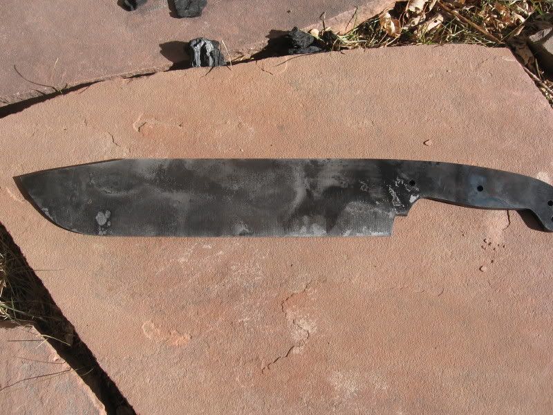

Update. Heat treat done and she is dead on straight. Tempering now!
The beast draws ever closer!!!!
I pregrind the knife to remove most of the stock that needs to be removed before heat treat. After heat treat the steel is hard and it takes twice as many belts. You don't want to take too much and have the grind too close to finished before heat treat, because of the scale that will need to be removed and to help the blade stay straight. They tend to warp more easily if they are ground really close to the final shape before heat treat..

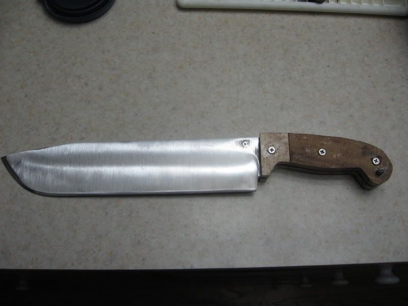

almost done!

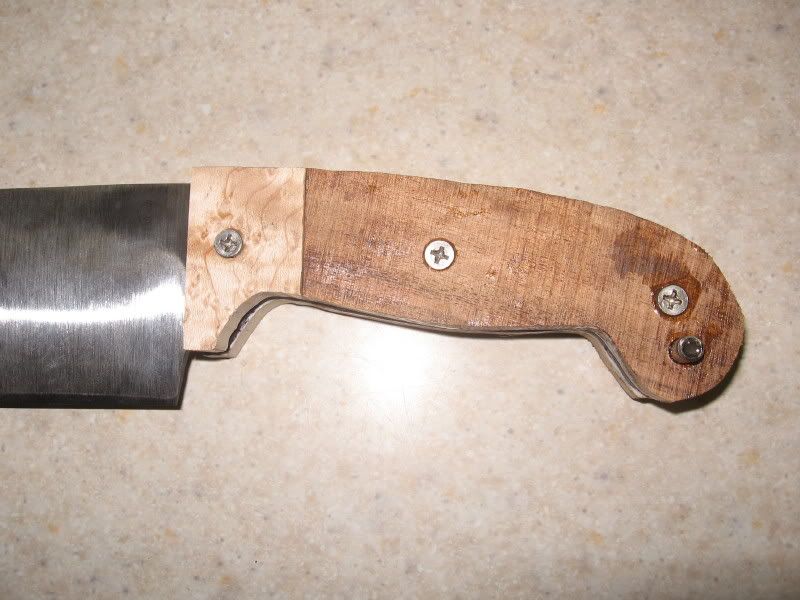

I will do the handle shaping today..
