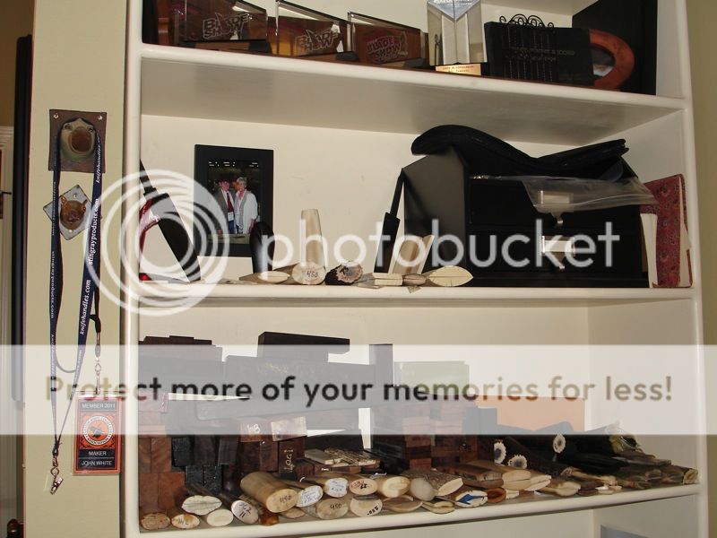

On my "acclimation" shelf are high density, stable woods such as African blackwood, desert ironwood, and ringed gidgee, as well as stabilized woods such as koa, bog oak, and claro walnut. There's stag, both "natural" and dyed, and horn.
I've got slabs of G-10 and old Westinghouse yellow Micarta, as well as my favorite black linen.
There is also Ivory, Walrus, Mammoth, and select Pre-Ban. (Way too much Ivory for the good of my bank account.)

P.S. Here's an up-to-date look at that handle material "acclimation shelf."

PS: John, that "acclimation shelf" is making me drool. ;)
