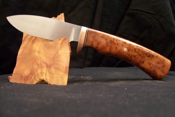

Nobody's mentioned the cheap man's workhorse, the Craftsman 2x42. It's wicked fast, belt selection is just OK, but it's a decent starter machine for $150 or so. It takes practice to get used to the speed, but you can learn to make some good blades with it. I've made about 70 so far on mine over the last year. Here's one totally done on the Craftsman.
