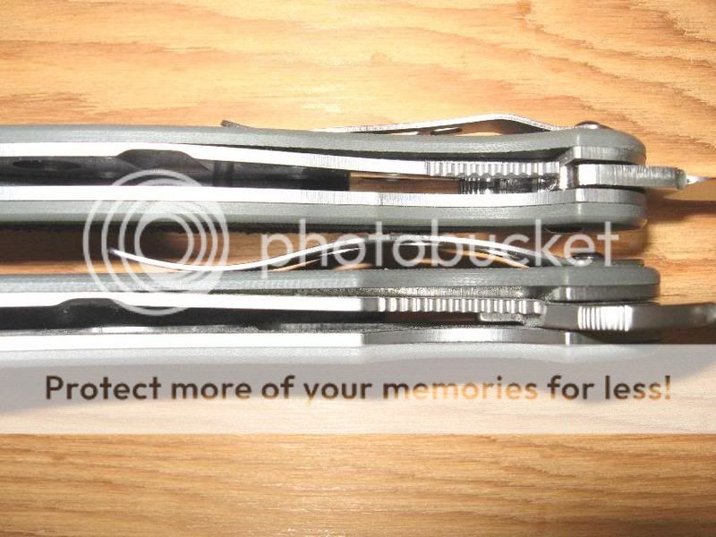

There was a long thread a while back about Liner Locks vs Frame Locks, I don't have the link but a quick search would find it. Anyways I have always heard something is "only tough as its weakest part." This said, all Frame Locks have a cut out in them. This allows the bar to act like a spring, and also not be to stiff.
My point is that most Liner Locks I have seen (and I have seen a bunch ;)) do not have this cut out.
So in theory Frame Locks are not that much tougher than Liner Locks. A well made Liner Locks that is. Not the crap you find at the flea market, or the crap they sell 200 knives for $50.
Here are some pics to help explain what I mean. :cool:
SnG (known for bank vault lockup), but do you see that cut out? Looks thin Huh?

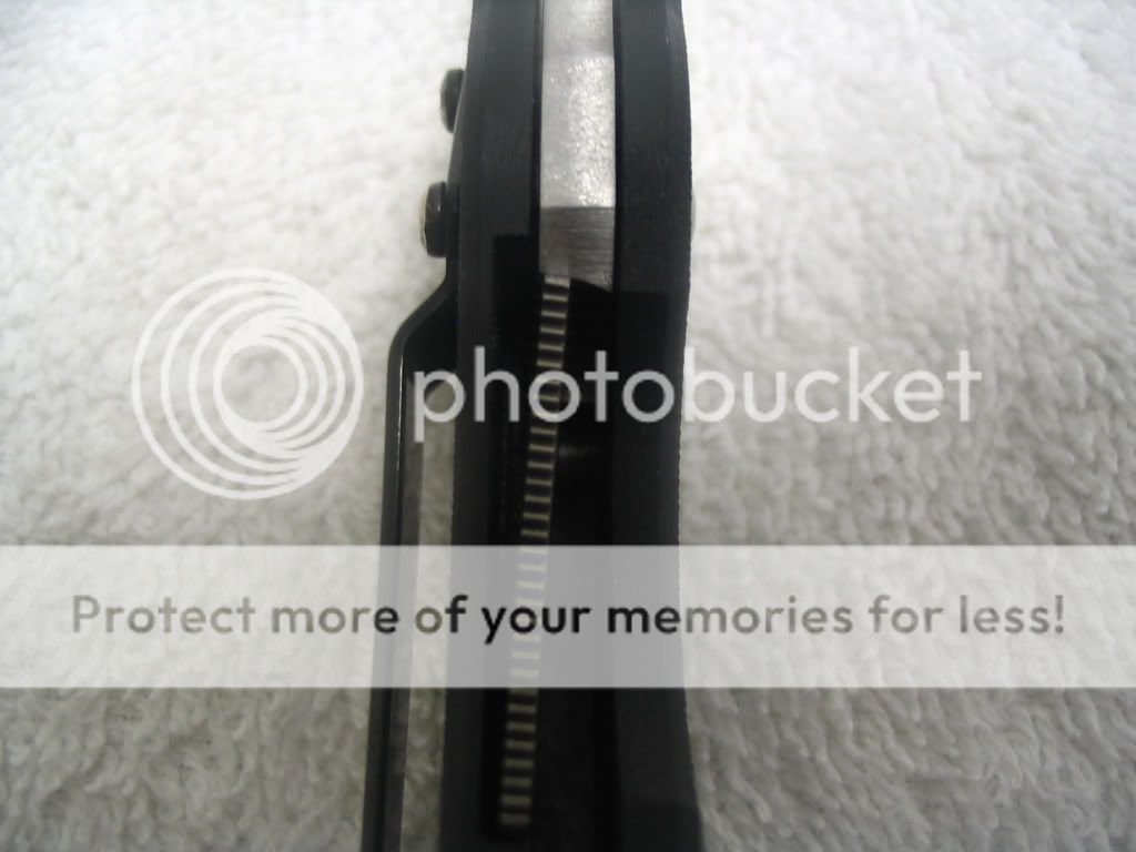

Spyderco Mili (see the thickness of that liner, its not much smaller than the SnG.) :cool:

Mechanically, a framelock and liner lock are the same thing, the liner has a scale over it. What happens in execution of the design for the part is that the framelock is usually much thicker at the lock up point, so wear is spread over the larger face. Framelocks are often made with Ti, which has a much higher friction in contact with blade steels than the cheaper stainless liners used on inexpensive liner locks.
There is some concern about the strength of the cutout in a framelock, but few have demonstrated it's a problem other than in their mind, as the rest of the leaf is full thickness and not subject to flexing as a thin stainless linerlock. As for the lock actually failing there, it would take thousands of pounds of leverage to overcome the material strength in compression - something else would give first, likely the lock interface, which is what happens to a cheap linerlock in a spinewhack test. Even liners don't crumple into folds doing that, they just bounce the leaf to the side and unlock, as widely reported.
Anytime you have a long cut such as that used to make this type lock which in effect creates a long bar you will be able to see that it can show some downward movement from leverage if you open the blade half way and just squeeze down on the lock. This movement is even more profound on some that are taken down to extreme thinnness and so much so that you can actually close the gap between the bar and the body of the folder easily by pushing downward on the lock. On others (the thicker ones in the relief area usually) you can't move them at all or only very slightly by comparison. In other words they are more rigid. It isn't the fold or kink problem that is so much a concern here with this cut out so much as it is the downward movement and double wear that goes along with it in conjunction with the sticking locks as a result of this added movement.
For examples, try moving the Cuda Max lock downward. Now compare that to one that is thin and you will see the difference. Without the lock stabalizer these locks will move down during use sometimes binding in such a way as to become quite sticky. Strider saw this as a problem and so did Rick Hinderer. I think it can be prevented to a large extent also by simply paying attention to how thick or how thin these cut outs are. Even the Sebenza can be made to move downward to some extent and its much thicker than most frame locks in the cut outs. So imagine how flimsy it would feel if Chris Reeves took his down to these rediculous thinnesses also. This is not in anyones imagination. It can be easily verified by simply testing your own knives. After .058 there is no real reason to go any thinner. This thickness seems to work just fine and even assisted opening knives can work with a .058 thickness at the cut out. I just did one and sold it in that Blur that way.
Some of these locks are thinned down to sub .040 thickness. Some of the harder use ones have been .033 which in my humble opinion makes the locks far too easy to bend downward unnessarily.
Sal has said in his own testing that this relief cut out is exactly where the locks defeat. I can vouch for that because I have seen it also and it does not take thousands of pounds of pressure to do it. Ask yourself why I converted my first Emerson liner lock to a frame lock. I tested it with free weight hanging through a cable through the lanyard. They don't hold the weight you think they will. In fact a strong liner lock can hold 100 pounds max. Don't believe me? Try it.
