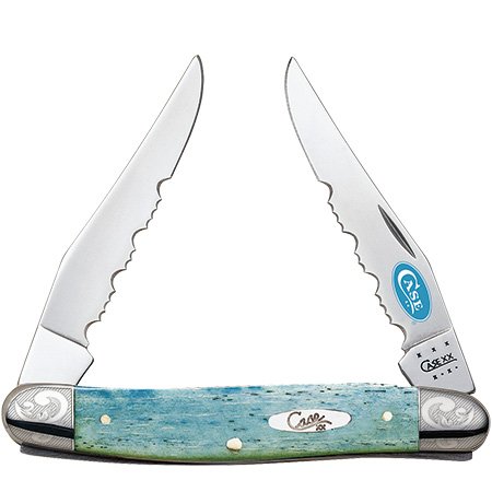

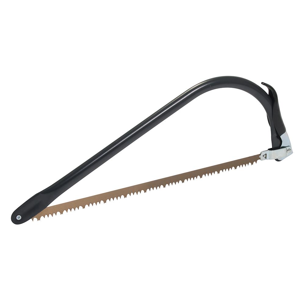

I am curious if the design is to actually use to saw instead of grab and slice. That was my thought when I notice the case knife serrations. They look more akin to a bow saw blade than a serrate knife blade.

Reminds me of the serrations of a case muskrat I noticed a little while ago, but worse than the case.
Is that really an attempt by Case to make some serrations that are "different" from the rest? The rest of the knife is beautiful......but that edge.......geez.
My initial impression was "that blade is badly chipped... oh... they made it that way?" Looks like someone just tried to use their case to baton through some rebar.
A saw blade is a completely different thing than a serrated knife blade, regardless of the shape of the serrations. A knife blade, serrated or not, is beveled, which means that the spine will be thicker than the edge and will never be able to pass through the gap that the edge cuts, if you want to go through a solid hard material. A saw works the opposite way, where you have relatively thin bladestock + teeth that are flared to the sides to cut a gash that is wider than the thickness of the spine. Because of this you can generally not saw through, say a piece of wood with a serrated knife, you can at the most cut a notch in it.
Maybe this is common knowledge to most people here, but I figured I'd explain the difference, since some people seem to sometimes mix up the concepts of serrations vs saw teeth.
