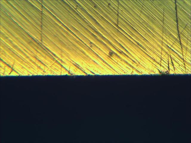

And for the heck of it, here is a series at 400x showing some of what I mean re blanket statements pertaining to stropping - first pic is off an India stone, second is the same edge following a few passes on Flexcut Gold on leather strop, last pic is a few passes on Flexcut on paper over the coarse side of the same India stone. Sadly I cannot accurately describe how hard the leather strop was, how much force applied etc etc...
And yet, I take it that the pictures aren't happenstance or accidental outcomes, correct? That, if you were inclined to do so, you can reliably repeat your results using some "method" and that you do so anyway - except probably for the documentation part, right?
(And I'm not doubting your integrity at all because I very much like that last picture) That last picture looks too perfect. There's also maybe a "touch and feel" part of the process that can't be scientifically quantified like a professional golf swing. They can try and break it down for you but, really, in the end there's a lot happening to be able to say, do this and that using whatever to get such a result.
I absolutely could, yes. In fact those pics are a few years old and my technique is improved including my micrograph taking abilities, so it would be even more apparent. I could also guide someone else to do so, but maybe not without detailed instructions.
The effect IS impressive, and edge rounding is very mild. The edge went from off the stone shear cutting paper and shaving a bit of arm hair, to shaving arm hair and crosscutting paper, to treetopping hair. Believe it or not I recall making a reference nick in the bevel above the image area, so all three images are essentially of the same region.
The unit pressure of the abrasive and underlying stone is so high if a piece of grit gets caught between the two it will deform the edge - push it out like a fold in a drape, with very little force. I get a similar effect on a Washboard but the abrasive presentation tends to be much more aggressive rather than the effect of the paper over the stone - which tends to make a very polished edge but with very little tooth left - as evidenced from the images. Also the Washboard has a uniform pattern that prevents "breakout" pressure spikes that can arise from uneven/singular points of contact.

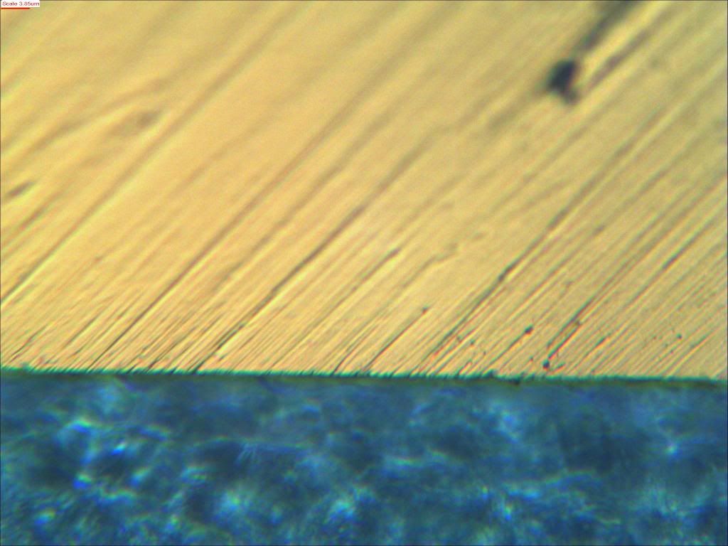

This is Flexcut Gold off a hard leather strop coming off the India stone. Note the finish is somewhere between the earlier softer leather strop and the stone over paper.
And this one is .5 CrO on paper over a Washboard - note how the abrasive tracks are more defined than the nominally larger Flexcut on paper over a stone, despite being a finer abrasive. Also note that some folks believe abrasives in that range are only capable of burnishing when applied to a strop - this also not true as the edge was done on 600 grit wet/dry prior to the compound treatment. To top it off, this is over two sheets of paper - over one sheet the abrasive tracks are even more pronounced. Scale upper left is just under 4 micron.
Also note there there is essentially zero edge rounding. In fact when the strop surface becomes hard enough the "failure mode" is microfracturing of the apex, with very little rounding aside from what is induced by the user, or what is revealed as the previous grind pattern is worn away.
