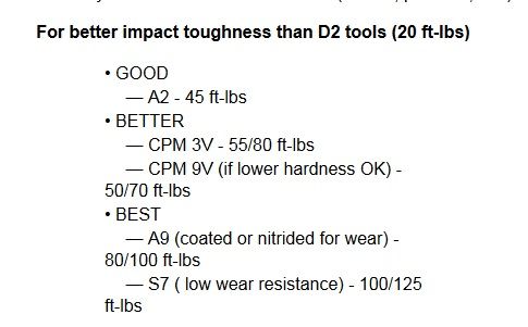

CPM-3V/Z-Wear/Vanadis 4E should be the top contenders, but you sacrifice corrosion resistance. If corrosion resistance is important combined with higher alloy content...heck I dont know. It becomes a gray area for me but I know carbide volume becomes important.
From crucible:
The main constraint to higher alloy content is the volume of primary carbides.
Crucibles patent information on CPM-3V shows the following graph:
Powdered/Particle/Spray formation improves higher carbide containing steels, however, in industry High Strength Low Alloy steels still have greater toughness than steels with higher percentage carbide volume. That is why L6 is still used for jackhammer bits and other high impact uses.
If you want stainless and toughness 12C27 (not a PM steel) is one of the best available IMO as it is a low alloy steel with small carbides. Most custom knife makers I have talked to run their 12c27 at HRC of 60-61.
