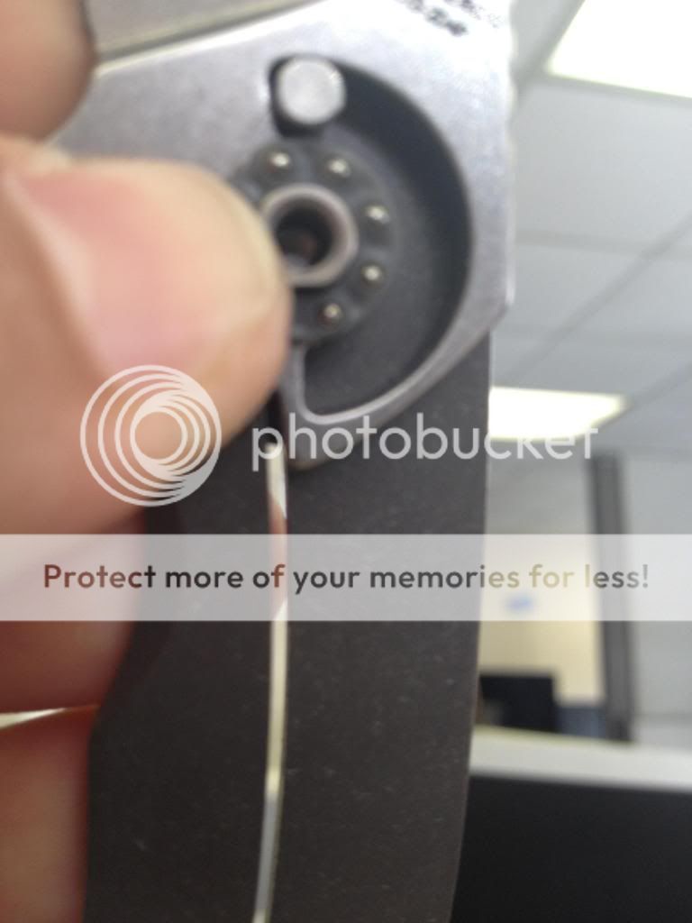

It only locks up in two positions, not three. One on the lockbar surface to prevent the knife from closing, and one on the internal blade stop which prevents it from rotating 280 degrees towards the back.
If you take it apart you will see a 1.2mm gap.
Yeah, I have a hard time believing that 3rd point of lockup. There is no marring on the blade (in that area) like there is on the lock face.
Yes - that's correct. However the design is neat, it is unlikely that the blade will develop vertical play, and that extra notch also probably makes it safer. Here is a quick diagram that explains the locking:
(Please ignore the second image uploaded by tapatalk - it does not show the locking clearly and looks like 3 point locking)
I don't see it. Cannot prevent vertical play either. It could potentially act as a safety feature of the blade stop ever breaks... but that's a massive if not to mention the force that would be needed to break the blade stop would not have a problem bending the lockbar like a lollipop stick.
The notch there has more to do with the channel extending close to the edge of the blade blank, thus needs the material there.
Here's an actual picture of the knife.
