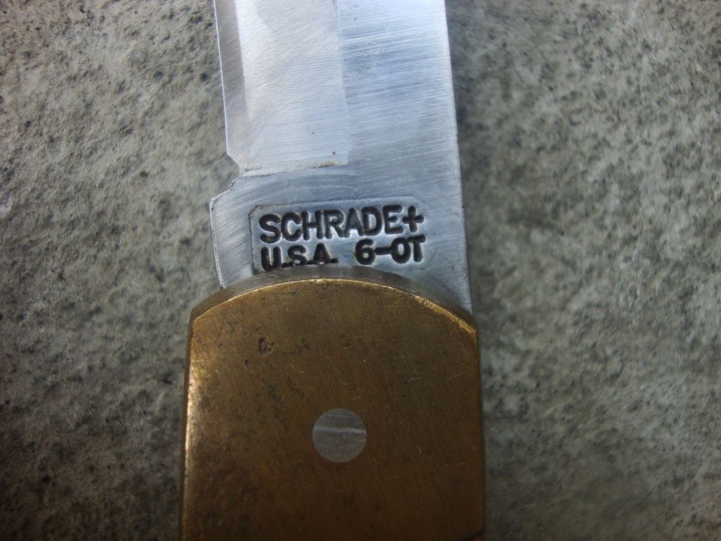

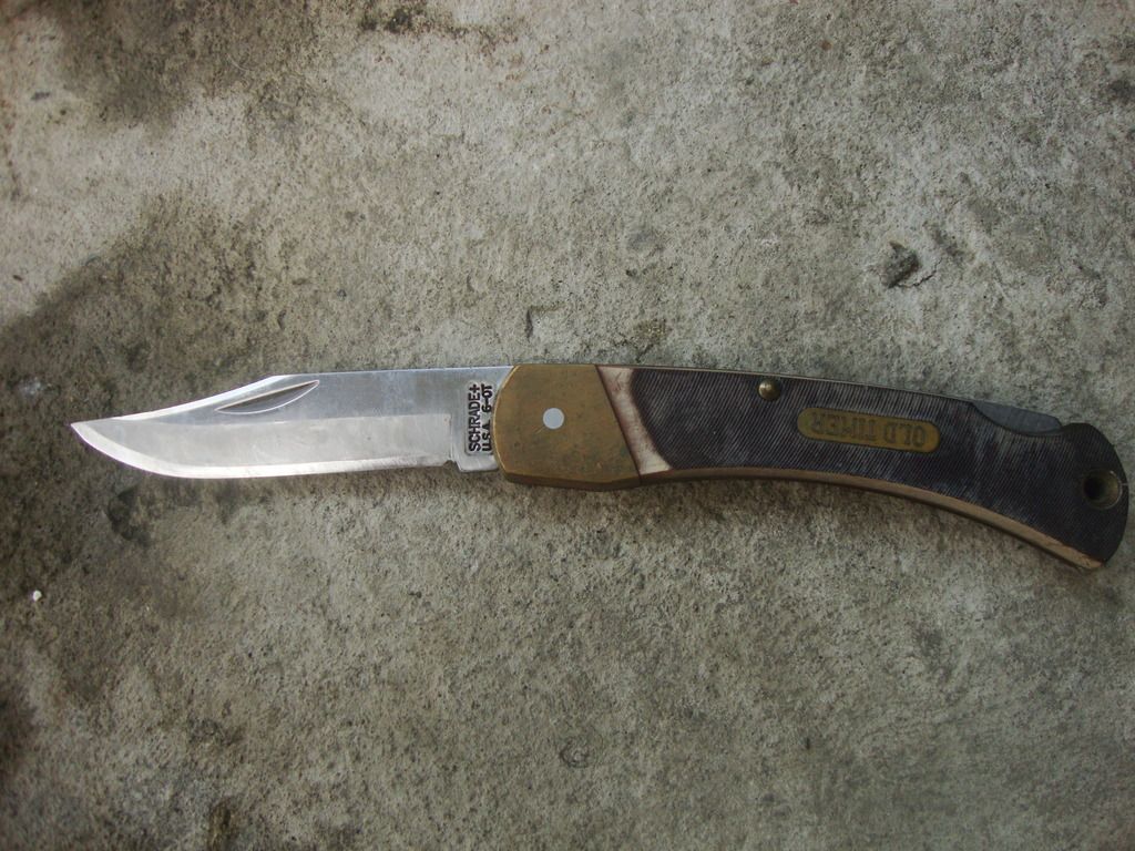

BTW, I wonder if anybody knows what steel those old schrade 110 K/O's used. I have one of those that I beat up on back in the early 90's(I think). Never let me down back then too.
The Old Timer 7OT used 1095, if memory serves, unless it has "Schrade +" on the tang, which would be a stainless steel.
Yes, it's stainless. That much I can tell.
