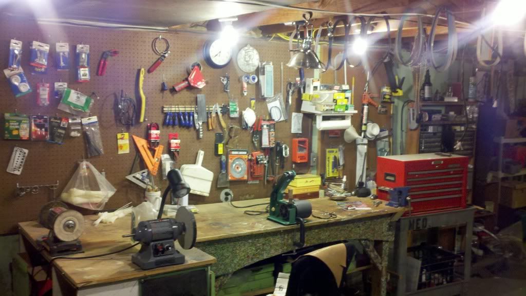

I've got a lot of stuff. I might set it up for a "family photo" to post, that sounds interesting. Nice tri-hone, by the way. Looks well-used!

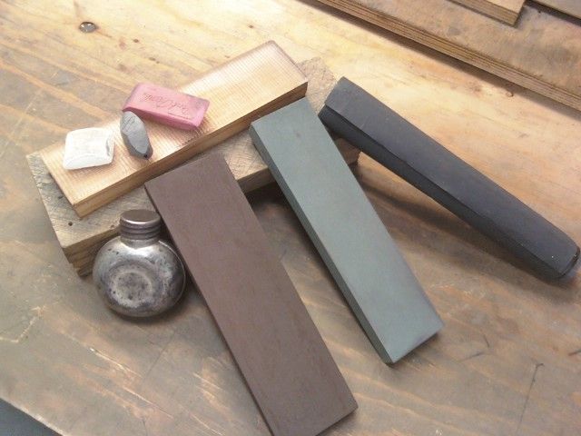

Here's my current set-up:
Hardwood base.
Oil bottle from Romy AK - mineral oil with hint of juniper.
Eraser for cleaning sandpaper.
Silicon carbide and AlumOx compounds for finer edges.
Washboard.
Several sheets of 320 and 600 grit sandpaper, and few sheets of copy paper rolled up inside, for final stropping on the board.
240 Grit SiC Norton Jointerstone (thing is great for heavier stock removal and working edges).
500 grit SiC Tyrolit Jointerstone (refines closer to 800 grit).
I use the sandpaper for convenience and quick touchups beyond what can be done on the board with compound - also handy for taking with me outside the home because it weighs nothing. I use the Jointerstones for when I want to grind with oil and mud, and backhone on a hard stone with a little more precision than the sandpaper allows - works just like a JWS. I do everything from paring knives right up to machetes with either set-up.
Not pictured, I also use a single cut mill file with oversize dowel for a handle when doing bigger repairs on softer steels - machetes, ditch knives, mattocks, root axes...
