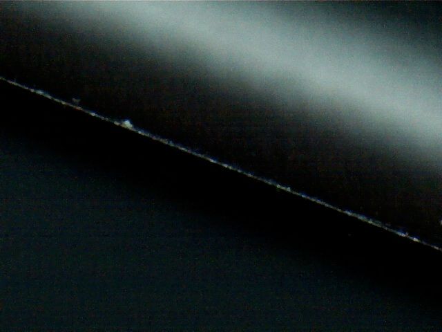

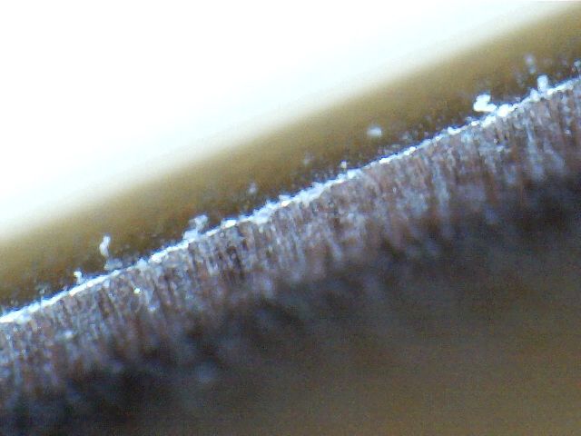

Thanks David, I do have USB Microscope that I can use to take pics. I'll do it tonight. Thanks for staying with me on this guys.
David

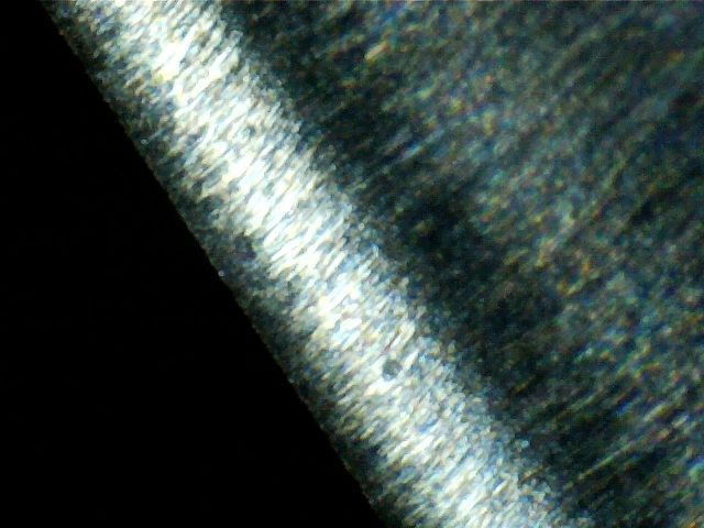

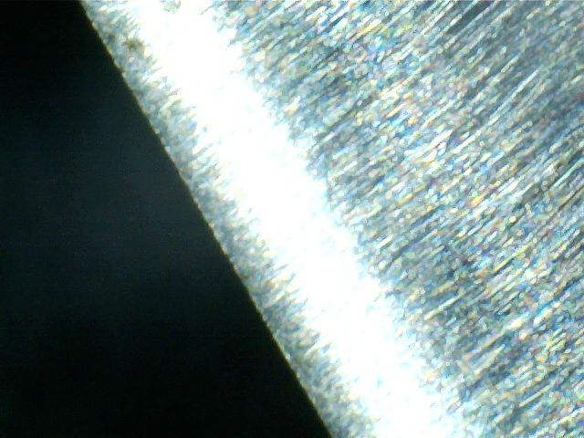

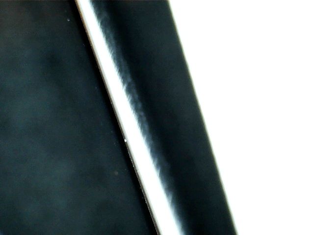

I really have a hard time using the USB microscope. I hope these pics help you help me. Some are at 20 and some at 400 mag.
Sorry for the poor focus, the control is really touchy.
David,
I think I am seeing a burr along a portion of your edge, in that bright reflective 'thread' in the first pic; that's almost a dead ringer for a burr. And in the third pic, it looks as if the edge might not be fully apexed (looking at the portion of the edge seen below the bright 'dot' of light along the edge). Think I see some more of the same (incomplete apex) in the lower 1/4 or so of the 4th pic as well. Depending on how the blade is oriented in each pic, and therefore what side I'm looking at, it's possible you've stopped a bit short of apex on one side, and generated a burr from the other side at the 'old' apex of the original edge. This would leave a bit of 'microbevel' (remnant of the original bevel) along one side, in between the convexed portions of your new edge. That could definitely present as a 'dull' edge, and it's very common; more so with thicker blades, as it takes quite a while to fully apex from both sides.
Your work looks very good and clean; it just looks as if you haven't quite reached a full apex yet, from both sides. I'd first focus on making sure the (apparent) burr on the one side extends the full length of the cutting edge; then work the other side until the entire length of burr 'flips' in the other direction, indicating you've apexed from that side.

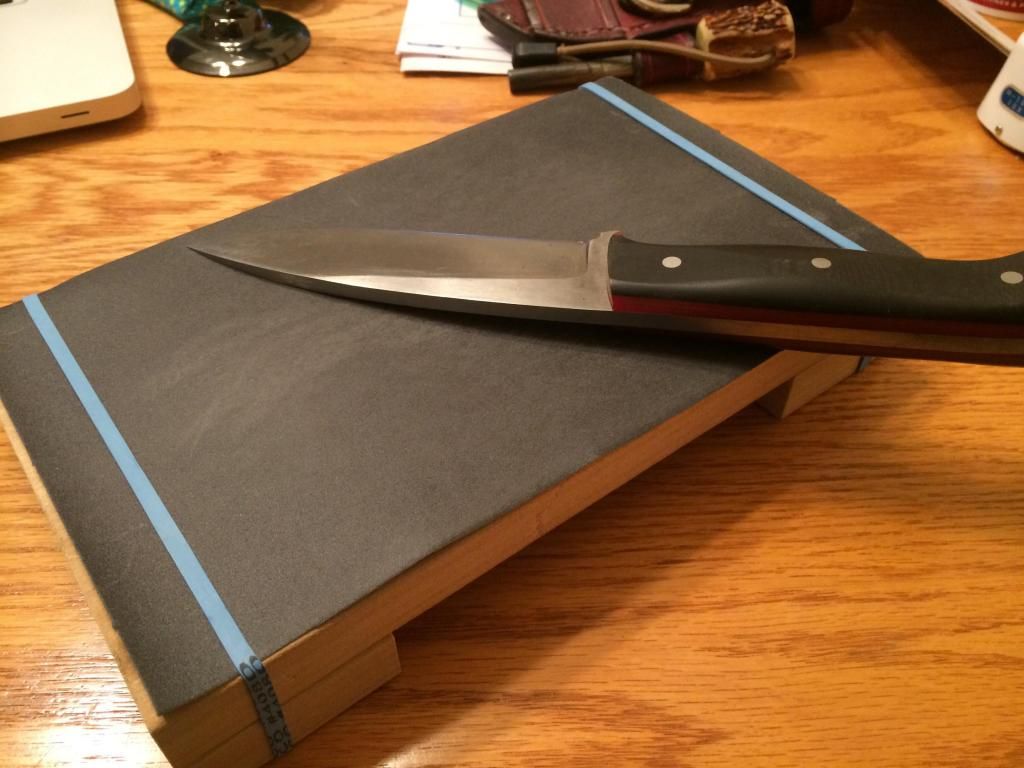

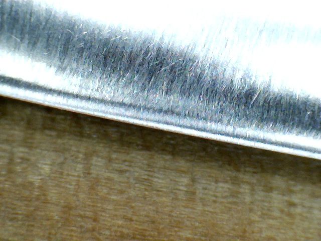

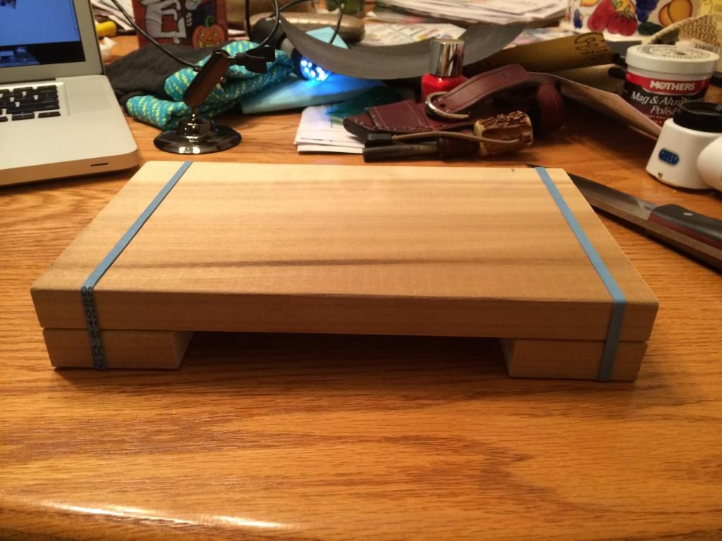

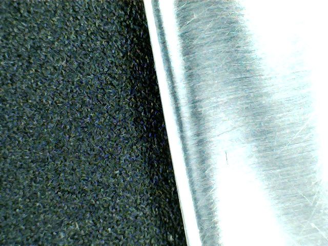

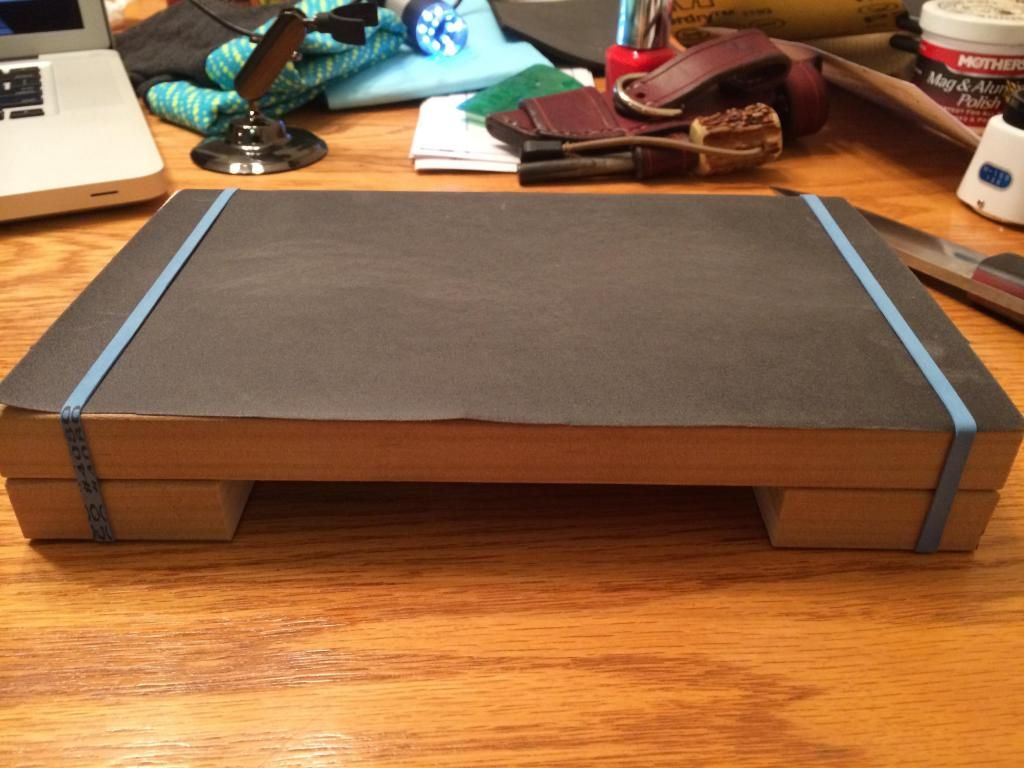

I made this block today to fit 1/2 sheets of wet/dry paper and have a mouse pad cut to the same size. Also here are a few pics after raising the spine a little more on the wood block with no mouse pad. The rubber bands hold the sand paper in place and keep the block from moving around also.

Using hard hones for thinning a 'thick' edge, before convexing, is something I've done frequently. Thinning to a fairly low-angle V-bevel first (aim a few degrees lower than what you're willing to accept at the finish), and following with the sandpaper can make the process much easier. As Martin has mentioned, sandpaper convexing can add a few degrees to the apex angle if not careful. My own habit would be to follow with sandpaper on a hard backing (over glass, or glued to wood), so as to minimize the conformability under the paper, and keep the edge angle low, or at least within reasonable limits.
I'm certain Martin is emphasizing keeping the spine LOW (closer to the paper), in recommending 'laying it over'. With a soft backing like a mouse pad, this is essential to keep the edge angle from getting too wide. With the harder backing of your block, it'll be easier to keep the edge angle under control. Gluing the paper down will also help, in preventing the paper from lifting or curling around the apex. Also makes the abrasive work more aggressively, if the paper doesn't move at all as the blade is drawn over it. Sticking the paper down also minimizes the extra scratches that'll otherwise mar up the sides of the blade, as would occur when the paper rolls or lifts under the blade.
