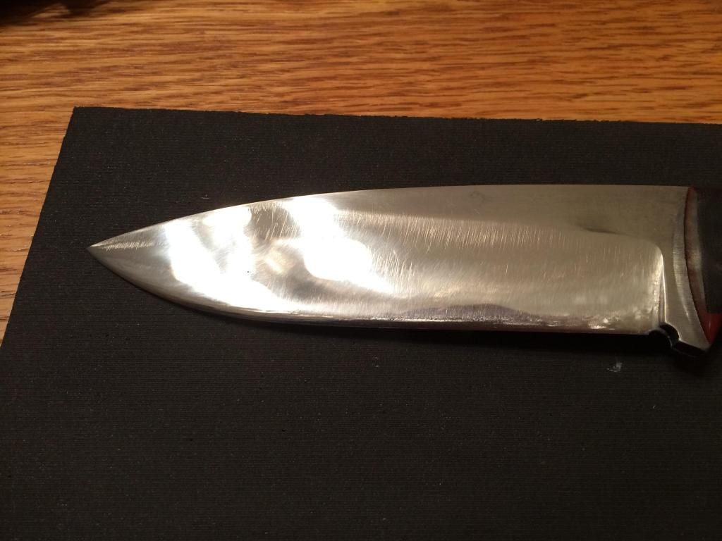

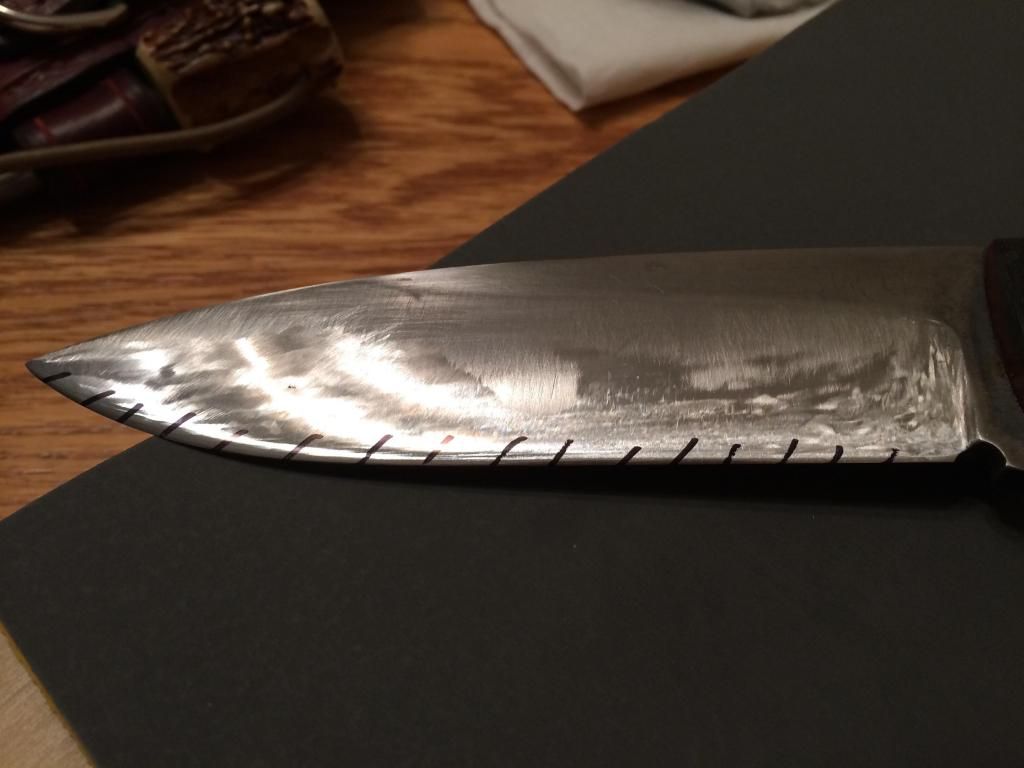

Worked on it a little more trying to get out the facets from sharpening. Taking HH's advice but instead of compound on paper I used 2000 grit sand paper, I put the radial line back on too insure I didn't foul my edge.
After a while I had most of the swirls and facets out. You can still see the makers grind marks but they will eventually disappear. Its not perfect, and honestly the swirls and facets didn't bother me I just wanted to see if I could work them out.
