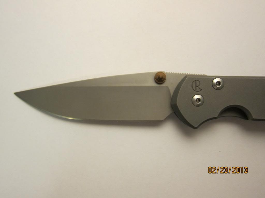

So I decided to take the plunge and send one of my sebenza in for a reheat treat. I did leave the thumbstud in just to see what happens and partially bc I need an excuse to have it sent back into CRK for double thumbstud instal. While it's there I may have them give it the spa treatment as well.
Does anyone know if they will re stonewash the blade if it's been reheat treated? Is that even part of the spa treatment?
Anyway I will post an update with photos once I receive it back form the heat treat. I am excited to see it when it comes back, hopefully in one piece haha
Update here:
The s35vn blade is sent should be done today.. He had to re treat it because after the first run through it was only up to 59.3.. He said usually it takes only one treatment but the metal often times have variants . even between blades from the same batch from crucible. This tells me that he a stand up guy and wants to do the job right for his paying customers. Also I'm glad I sent it in and i would be interested to know what the HRC was before it was re treated..
Also a few updates on Chris Reeve policy. They will not re-stone wash, sharpen, or put new thumb studs on blades that have been re hardened.. For that matter they also do not re finish handles that have been modified.. But they will re finish the scales if they have not been modified even of the blade has been. I just thought this was good info and would save some people a phone call.
Photos to come once the blade arrives!

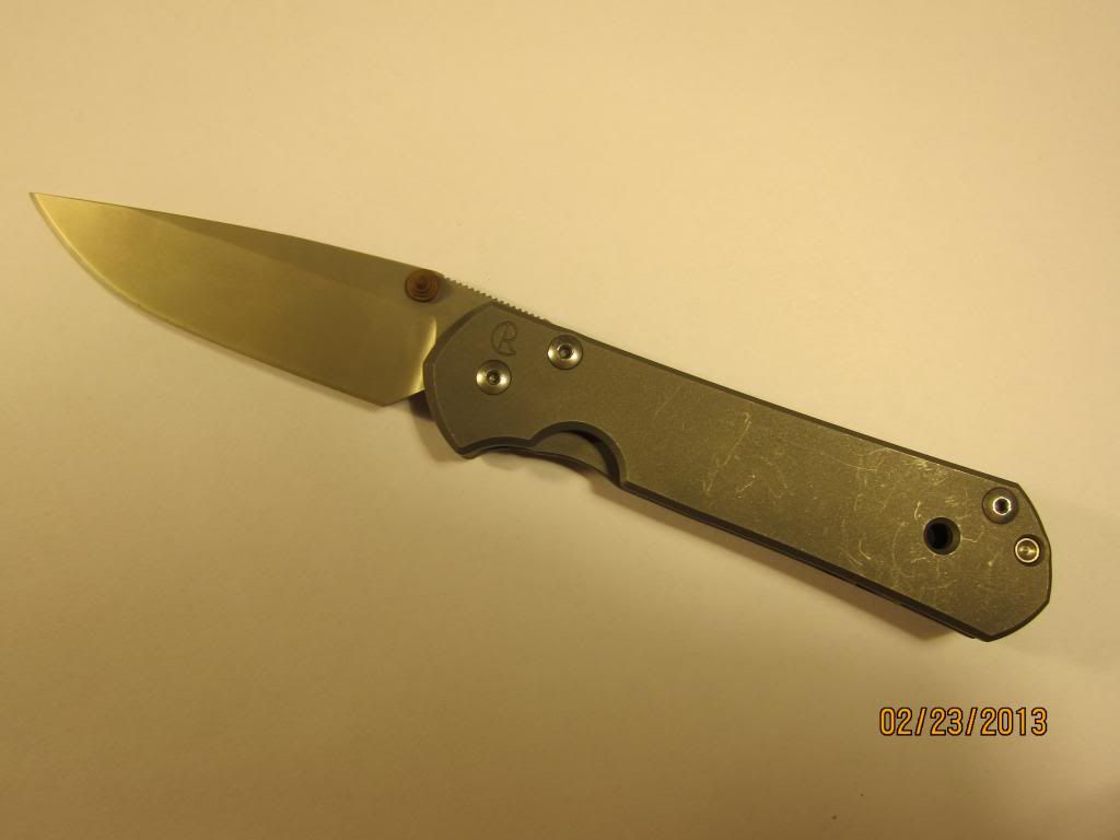

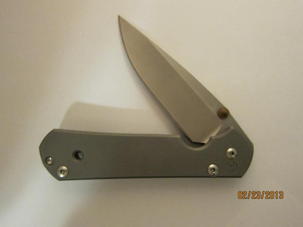

Here's with another update:

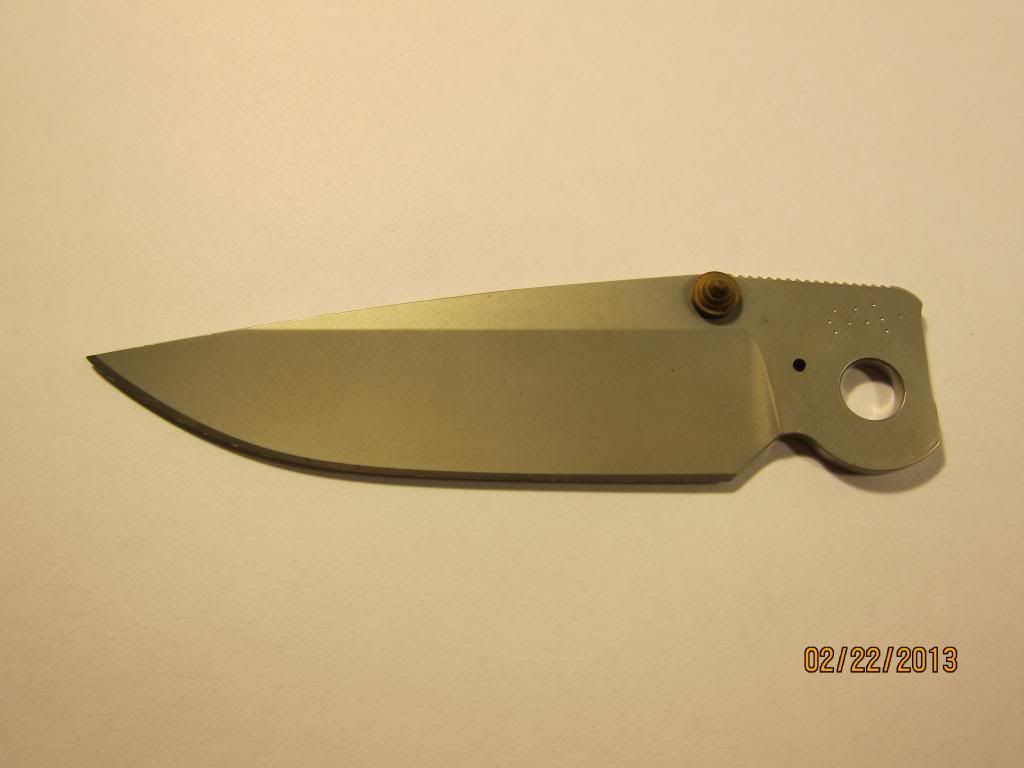

1. Got my blade back from bos today and had a nice little chat with him last night. After the second run of the heat treating and a good old cranking up of the oven he was able to get a HRC of 60.1. Sweeet!
2. He said he had a few other s35vn sebenza blades that he was doing this week and he was curious to see what HRC the stock sebenza's were, so he tested a few before the HT. Answer = average of around 58. Not a huge number so n=1 rule is in effect. Either way good info and you can make your own conclusions...
3. We got to talking (again very nice and friendly guy) and we were both wondering if Chris does his own heat treating or he if sends it out? We were both thinking he sends it out only because he always has a range like 58-59, either that or that is the variability in the heat treating, whoever does it. We also were wondering if he does do them himself, when what ovens does he use and if he oil quenches or uses water. You can use oil according to crucible but they have never done it at Bos, although he may do a test run on some scrap s35vn.
4. Thumb stud: Notice the color on the thumb stud...started out silver but now looks more acid washed copper color. I love it actually, it is very cool. The only thing is that it did become a little loose (not surprised). So I may just secure it with J-B weld or use one of the replacement thumb studs I ordered tonight....another update....maybe?! (Looking for suggestions or opinions)
5. Blade color: looks pretty good, almost like a light acid wash. I may keep it if I keep the original thumb stud because it fits pretty well together. Then again if I use a new thumb stud I may do a hand rub on the blade. Also I was thinking or a light scotch brite finish. Any thoughts?
5. Wondering what the little dimples are around the pivot? That is the sample he had to take to run the HRC of my blade. As you can see he takes averages and had to do mine a few times lol. This however doesn't seem to affect action and he was very careful and thoughtful to try to keep the divots where they would be behind the scales.
6. I will say that before I sent this blade in it the action was very smooth and well broken in. When I put it back together it almost feels like it needs to be broken in again. Smooth just a bit stiff. Nothing else has changed.
Again I had a great experience with Bos HT and would and probably will do it again!
The dimples are from the rockwell testing. One blade I sent only had a single dimple near the pivot, seemed he got 60 on the first try. The other one had about five or so, probably just had to make another go at it. Has no effect on the action or smoothness of the knife.
