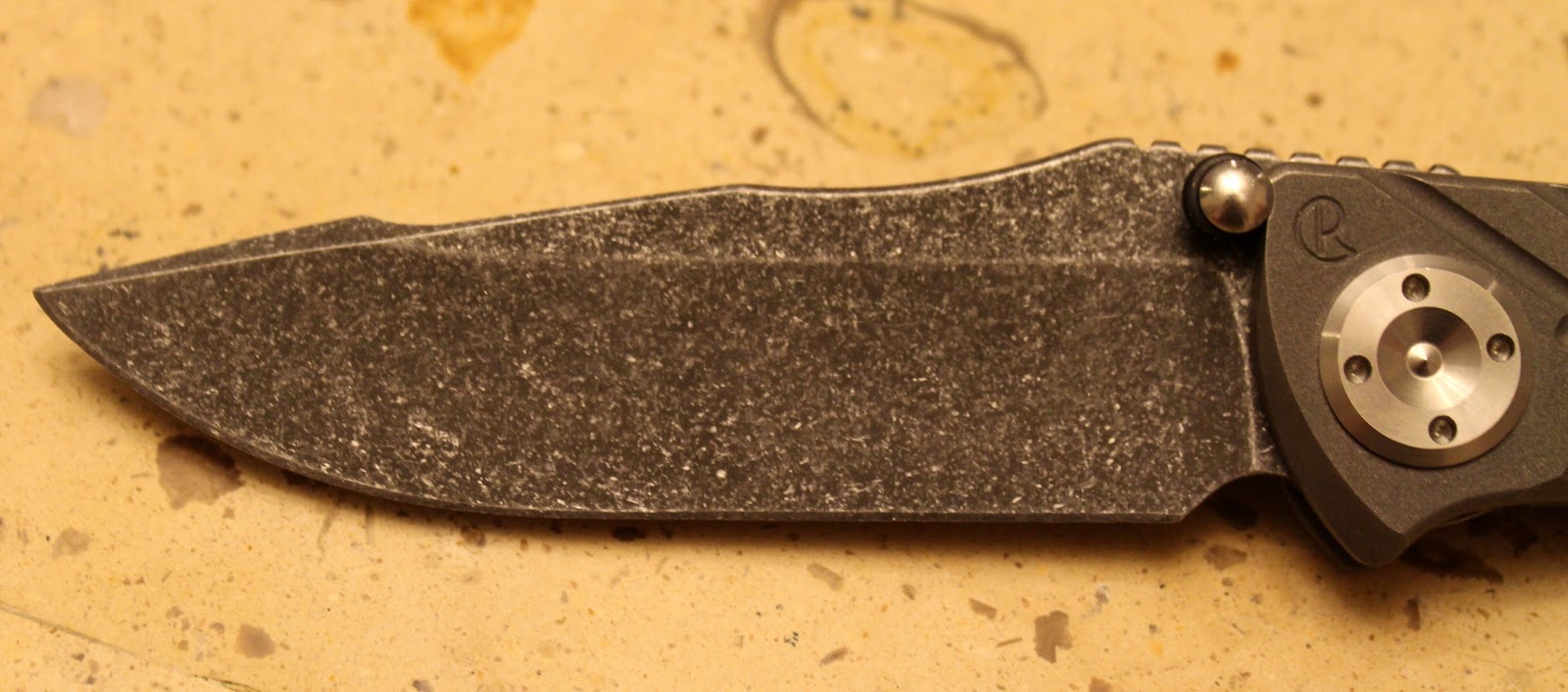

Got mine back today, note said it went from 57.8 to 60.1. Played with a few different finishes, settled on one I really like, and will send it out to Richard J. next week for one of his awesome convex edges. Can't wait to see how it'll be afterward!

I tried four different finishes before settling on this one. Went heavy on the acid, really like it. Second time I've acid/stonewashed anything, first time doing a blade.
Looks awesome man! I like the heavy acid wash for the zaan! Nice job. Wow that looks so incredible!
If you don't mind me asking what kind of setup did you use for your stone washing. Its an even and fine stone wash very impressive. I would love to know what you used!

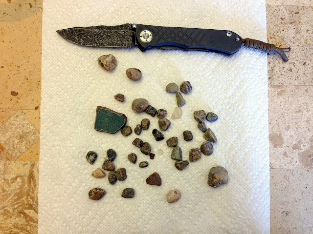

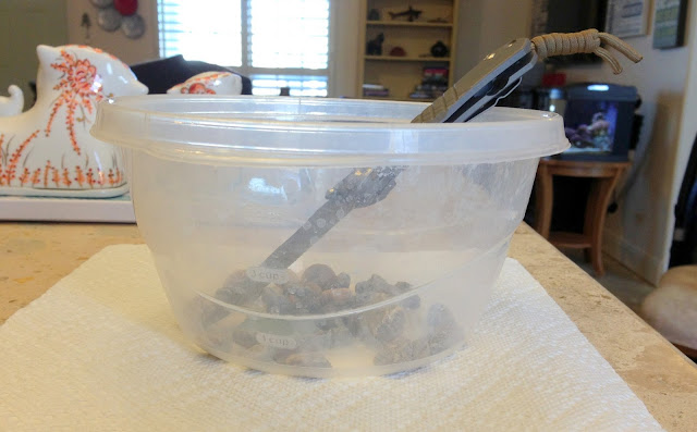

A handfull of smallish pebbles from the alley out back in a Tupperware container :p. taped it up real good, wrapped it in a towel, taped that up real good, then threw it in the dryer with a couple other loose towels (to keep the noise down) for 20 minutes on a no heat cycle. I can take a pic of the size of the pebbles and Tupperware container I used if you want.
NeverMore, how difficult is it to remove the thumbstuds from the umnum? I was thinking about sending mine to get reheat treated as well. Also, pics of the pebbles/tupperware would be appreciated.
The thumbstuds were easy. I drilled a hole halfway through a scrap of 2x4 to rest the stud in and just smacked it with a hammer a couple of times. I'll snap a pic of the stuff in a minute.

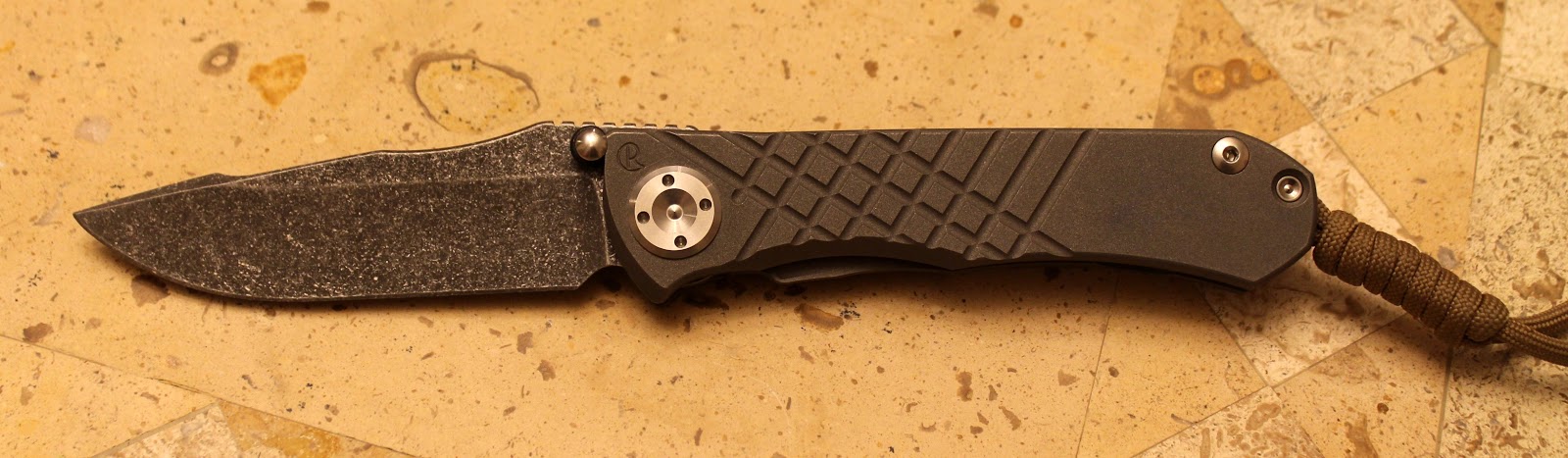

The lighting wasn't great and I took the pics with my phone, the blade isn't that dark. Much closer to the pics I posted of just the knife
I ll be damned nice job with modest materials!! Food for thought!! thanks again for sharing looks awesome!
Forgot to mention... the finish on that Umnumzaan blade is simply awesome! Where does the acid come into the picture in the stonewashing process?
The edge didn't really get damaged, just dulled. I had worse edge rolling from cutting a two foot piece of carpet (the final push I needed to get it hardened up a bit). The acid is what darkens the blade before the stone washing process, without it it'd end up looking very much like the factory finish.
