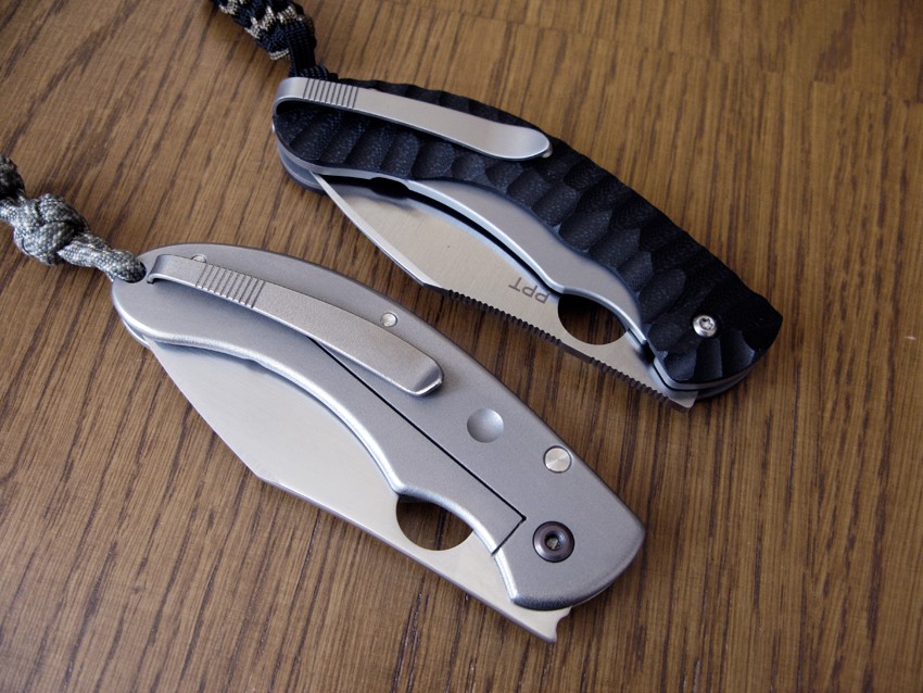

I wonder why makers don't put a curved section in the tang to wrap around the stop pin a little and increase surface area? I bet it would drastically decrease the amount of 'peening' of the stop pin that puts a flat spot in the stop pin and can increase lock engagement on a frame lock.
My custom CK&T karambit has that curved section.:)
A very nice feature.:thumbup:
My Benchmade 755 has flats to the stop pin, so the tang of the blade mates to a flat area. Also a cool design feature.
like that ?
this is a custom PPT made by Sasha Thiel. french custom knifemaker who makes some really incredible work. i believe that it may be a bit more complicated for an industrial to make such a refined detail. it may cost too much.
