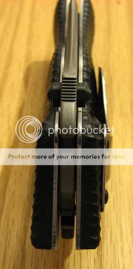

Which is the stronger stop pin?
I'd like CM to I.D. those 2 knives. They both look like pretty stout folders. :)
I think it depends on the diameter of the stop pin and how strong it is compared to the thumb stud. If the thumb stud is screwed together I would think a solid stop pin is always going to be stronger.
If you think about it, a stop pin is rounded and sticks in a curved hole to transfer forces to the liners. Just like the rounded thumb stud and the curved section it rests against in the liners. Yes the contact area is pretty small between blade tang and stop pin. But the contact area between the blade and the thumb stud is also going to be fairly small, at least in the thumb studs that I have seen that screw together. If it is pressed in then it will increase the surface area quite a bit.
I wonder why makers don't put a curved section in the tang to wrap around the stop pin a little and increase surface area? I bet it would drastically decrease the amount of 'peening' of the stop pin that puts a flat spot in the stop pin and can increase lock engagement on a frame lock.
Yeah, all they have to do is to grind a curve with same diameter as stop-pin. Small effort for large rewards :)
The first is a Daryl Ralph and the second is a Greg Lightfoot. Not positive on the model names though.
Yes those types of indentation are what I was talking about. When looking at the forces you can't just look at the thumb stud/ handle joint and the blade tang/ stop pin you have to look at all the joints that connect the blade to the liners of the knife. It doesn't matter if one has a very strong interface if it also has a quite weak one.
I don't think it really matters either way so long as they're well made. I've had BMs and Kershaws with frame mounted stop pins and Striders and CRKTs with thumb stud stops. No problems with any of them.
The Striders are a solid pin that's pressed through the blade but most of the thumb stud ones screw together. There is usually a shoulder machined into the stud to support it in the blade so it's not just the screw taking all the stress. I think to break the screw you would have to be doing something seriously stupid with your knife. It seems that this way would hasve less side to side flex.
If seen frame mounted stop pins get a flat spot worn in them from flicking the knife open, and that can effect the lock, but I've never seen one break off. Even if you do get a flat spot you can usually just rotate it and it's good as new. Benchmade uses a hexagonal stop pin on the Nitrous assisted opening knives. I think having the blade tang contact the flat surface might help to stop the problem of deforming the stop pin.
I personally prefer the thumb stud style but mostly just because of the cleaner less cluttered design you can get with the handle.
If the shape and diameter are the same, the thumbstud that is anchored on both ends (in the frame) will be stronger than the thumbstud that is anchored at only one end. Being anchored at only one end makes it more prone to torsional stress. It would be interesting to see what the yield strength would be, comparing a single thumbstud anchored at both ends with two thumbstuds anchored at only one end.

It should be noted that the Ball Bearing lock has a very large contact area for the blade stop as well. On the D'Allara the blade stop is the top of the steel back spacer that extends the whole length of the handle.

Here's another style. You can see the stop pin is the random hole near the pivot. There is a track on the tang of the blade on the inside which follows this pin. When the track ends, the pin stops the blade. So instead of stopping the blade from the back, it stops it from the front. I don't know if this is stronger or weaker.
