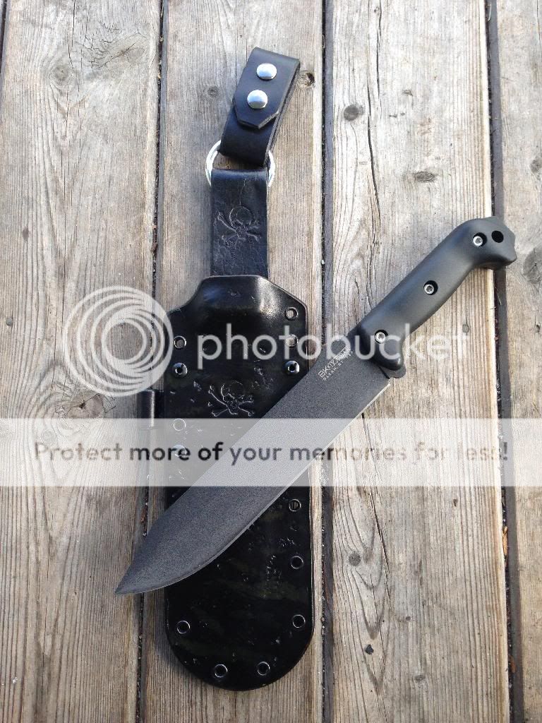

Man that 5 setup you got there is beyond sweet. Thanks for showing both. That 5 is looking so big and slicey though but the 9 is such a chopping power beast! I think i am developing schizophrenia over this descision. All last night couldn't sleep cause kept hearing voices saying" You can't not have a 9":) . My rebuttle was "leave me be specter i'm leaning towards the 5 but their both so good it's tearing my conscious apart!" This is gonna take awhile to make a choice. I really should get one just so i can sleep at night. If don't like the one choosen sell it and get the other. I'm probably just fooling myself not getting both. I'm sure i will within the next year. Might by the 9 new and 5 used since i see 5's pop up on the exchange once and awhile and never see the 9 show up. I got the 2 i'm getting on the exchange used still hasn't been shipped yet bought on saturday and he had stuff going on so won't get til this Sat or next week. So still waiting to make my a choice based on how it is. This Beckerhead think isn't some kind of cult is it?:) I feel a divine power persuading me to get more and more and i can't stop.:) Why do they have to be so good? I can't wait to get the 2 with a bigger handle than the 24. I predict comfortable grippy goodness.
