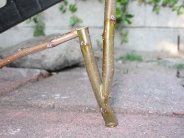

The Y is placed under the lifted edge of the trap. On the side of the Y facing away from the trap you need to cut a small notch. Into this notch is placed a support stick.
How far, below the bottom of the fork, is the notch?

The Arapuca is clear enough, except I'm interested in how far below the 'Y' the notch is cut in the 'Y' stick.

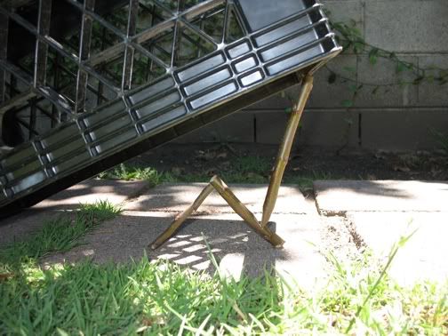

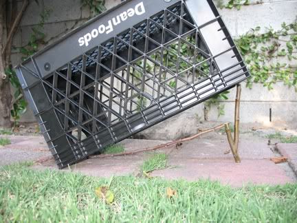

Doc, here is a deadfall I came up with, you might find interesting, it is similiar to the arapuca and promontory
As a matter of fact, i caught a squirrel in it this morning. of course, I was using the crate.
Alan

Hi Alan,
Yesterday, a buddy and I, among other things, went out and played 'trap triggers' :) We built your trigger, but had a problem with it (perhaps I'm missing something). When the trigger stick is hit sideways, no problem, worked fine, but when the stick was hit downwards, more times than not, the support stick caught the basket and stopped it from falling. Now if you're using it for squirrels and such, it works fine because the trigger stick is going to be hit sideways, in any case, but I was thinking about using it for birds. Maybe not a good application.
I guess you got your idea from the Promontory Peg.
We set up the Promontory Peg several times, and it worked fine, but my buddy, Phil, makes the trigger a bit different - he doesn't cut an angle into the support stick (despite admonitions to the contrary) but rather puts a bevel on the bottom of the lower stick, and it works great. It also negates the necessity of making a rough cut so that the upper stick doesn't slide out.
Also set up the Arapuca - works great!
And the San Bushman bird snare.
All in all, a very enjoyable day, but then again, what day outdoors isn't?
Doc
hey doc, try changing the angle of the upright here is an image. notice how it changes the support angle of the crate. also, see how much shorter the trigger is
I also, cut the notch on the trigger support a little low, try cutting it a little higher up.
let me know if I can help
Alan
