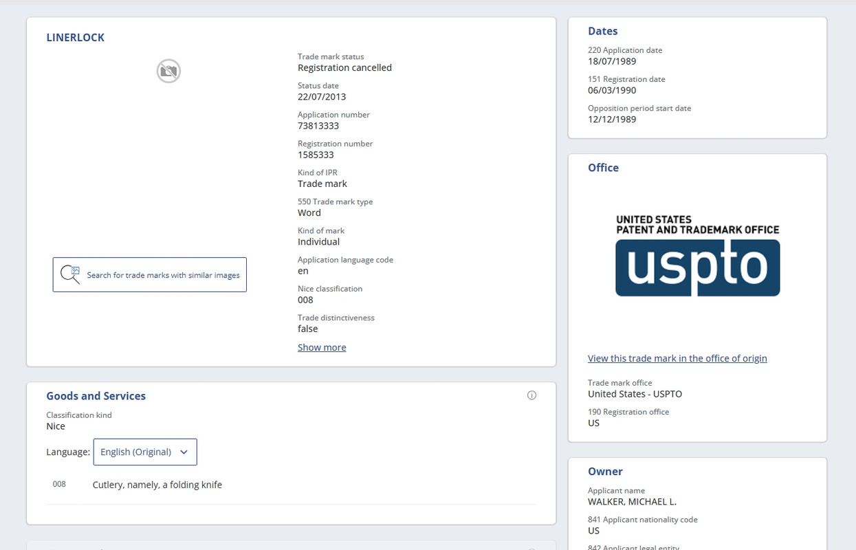

2. Knifemaker Michael Walker is credited with inventing a different type of "liner lock", the one most commonly used today, in the early 1980's. Although Walker never patented his liner lock design, he filed for a trademark in 1989, and it was granted in 1990 (trademark number 1585333). One major difference between Walkers liner lock and the Watson liner lock is that Walkers actually holds the blade open.
There is a lot of inaccurate information on the internet about when Walker applied for and received his trademark, but if a person were to look up the trademark number they could find official documentation at the US Patent and Trademark Office and see the dates I provided.
