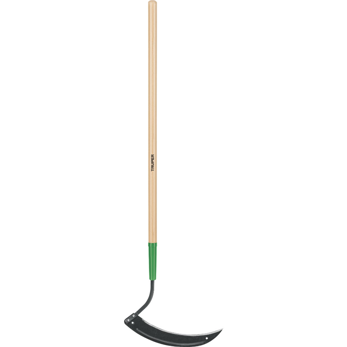

A light scythe alternative is the "grass hook." Seymour makes a decent one, and a nib can be attached to the handle to make it resemble a straight-snathed single-handled European scythe.
ImageRequest.aspx
I bought one of these a few weeks ago and I love it; super light weight, silent, and effective. I ordered one of the Seymour aluminum snaths and a couple of blades, since that should blow away the grass hook. Weeds and grass are exploding here so it should be fun.
