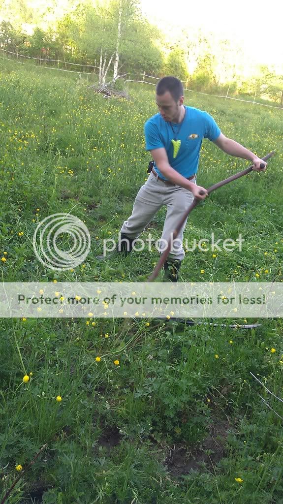

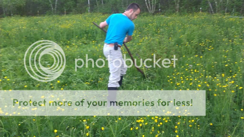

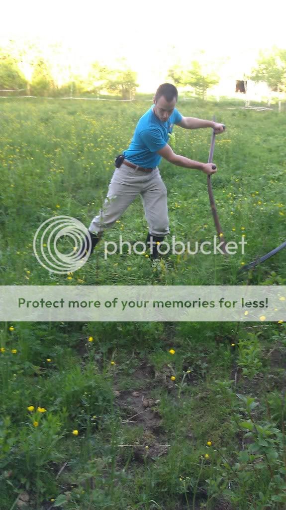

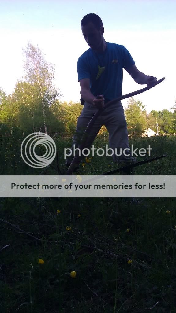

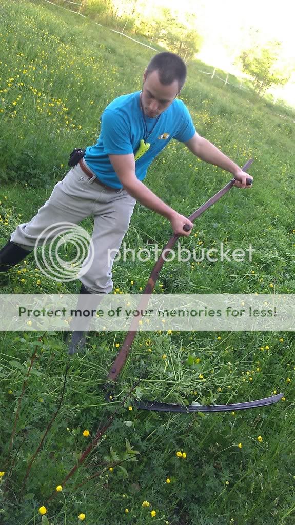

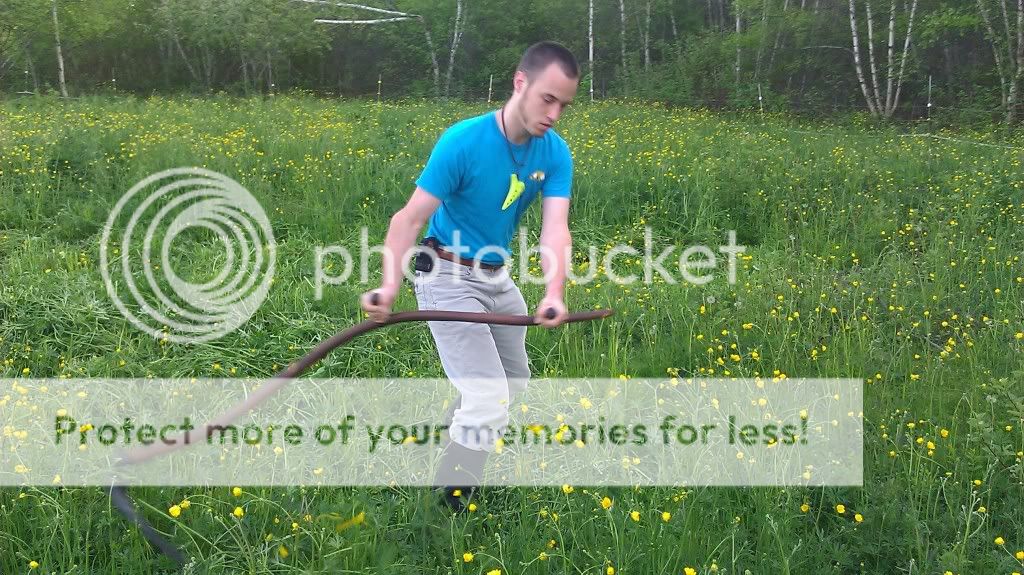

Got some good mowing done over the past few days. Buttercups (toxic to horses) have been spreading like crazy in the back pasture and choking out grass growth. They had to go! My lady was kind enough to take a few simple vids/pics for me.

Photos next. Not many, since the blackflies were bad, but they show stages of the technique well.

Photos. Sorry for the low quality of the pics. My camera's sensor died a little while ago so my lady had to use her phone for the pics and video, which doesn't fare well in low light and the sun was setting. :p

The trick is multi-fold. The first key is to make sure the edge is nice and sharp and thin without dings or dents. The second is to make sure you have it fine-tuned to your height and the nibs are rotated to properly balance the blade so it's easy to keep level. Lastly, practice practice practice is what it'll take to get the swing down. once you get all three factors working together you've got an unstoppable mowing machine! :D
Look great 42! I sure do miss it. A good day of relaxing with a scythe always brought me back to smiling and being more approachable.
Thanks! For those not able get a hang of the stroke, this ought to help with understanding what you see in my videos.
The key is that the stroke and the step are linked as part of the rhythm--as I step forward with my right leg I open the swing. My weight is almost all on the right leg at the start, and as I close the stroke I bring my left foot up to square with my right as I almost let my weight "fall" onto the left leg. It's like the right leg acts as a pivot for your weight and you fall forward and back, anchored to that pivot. Almost all of the muscle I use (other than the forearms which mostly support the weight of the scythe) is in my shoulders, hips, and a bit in the biceps.

I see in the video, your hips do not move, and all the reaching is from the arms
Where your step and hip are opposite to your arm's reach
And the scythe is high off the ground
I do not know if that is because it is an american type scythe
Also I do not see a clear and defined windrow
It's because it's an American pattern. The method of use is completely different--I'm well aware of the European method, though I thank you for taking the time to type all that out!
If I were on completely level ground I could rest the scythe on the ground, but if I were to do that I'd be constantly chopping through hillocks and dulling my edge. I'm not looking to manicure the place so much as just cut down the majority of growth.
There IS actually a slight rotation of the hips though it may not be clear in the video, but I do rotate from the hips as I both open and close the swing, and it does, indeed come mostly from the arms in terms of my reach--however the FORCE of the cut comes from the back-and-forth shift of weight from the right leg to the left and the "relief" of the tension from the slight twist of the body. I actually am making windrows in the videos, but because of the springy hollow stems of buttercups they have the tendency to "jump" from the windrow a little and scatter. They're all still mostly in a neat row, though!
