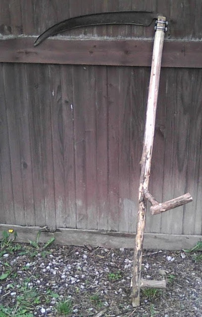

Today, however, I decided to see if my son had grown into his "wildwood"/hillbilly snath with hybrid blade. I made it for him last fall with a strange blade I found for maybe $4. I think it is a "hybrid" blade, i.e. half-euro design but made like a "US" type blade. It is marked Sweden, and is about 26" long, so reasonable length for a sub-5 footer. My son and I are different enough in size that he can't use my setups, so I made him a snath out of wood we had on hand to see if I understood sizing and to last until he outgrows it. It seems to work very well and he was cutting a pretty good swath when he focused, but he'll need some more practice.
I used two u-bolts for a clamp:
The main shaft is a very dense cedar branch that had been in the barn for several years and had a useful bend; I don't know why I saved it originally. Probably not that durable, but he'll outgrow it in a year. The handles are ash I believe, from bean poles/tomato stakes.
Probably an hour of "work" to put it together, so it isn't that fancy and maybe a little sturdier than necessary, but it works well for now.
Looks like it's a Banko blade, and indeed a hybrid form but not as you perhaps envision. It's an American-esque Swedish/American hybrid. From what I understand, the Swedes not only produced more true-to-form American pattern blades but also borrowed the American manner of build for some of their own production with the pattern somewhat altered to suit their own stylistic preferences. That one looks to be one of that sort.
