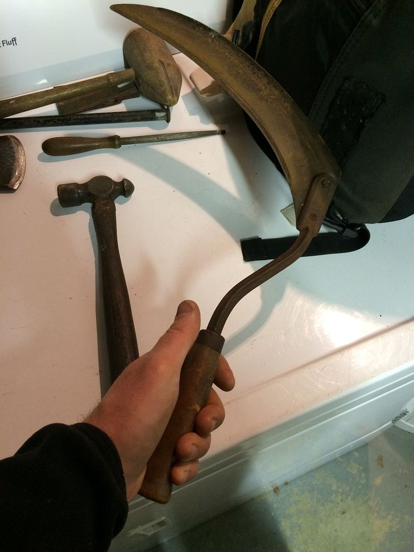

That's a scythe-type grass hook, as distinct from sickle-type grass hooks. A No.9 Little Giant by the North Wayne Tool Co. of Oakland, Maine, most likely made in the 40's or 50's. Not a scythe, but included in the thread topic and made by a famous scythe company. :)
