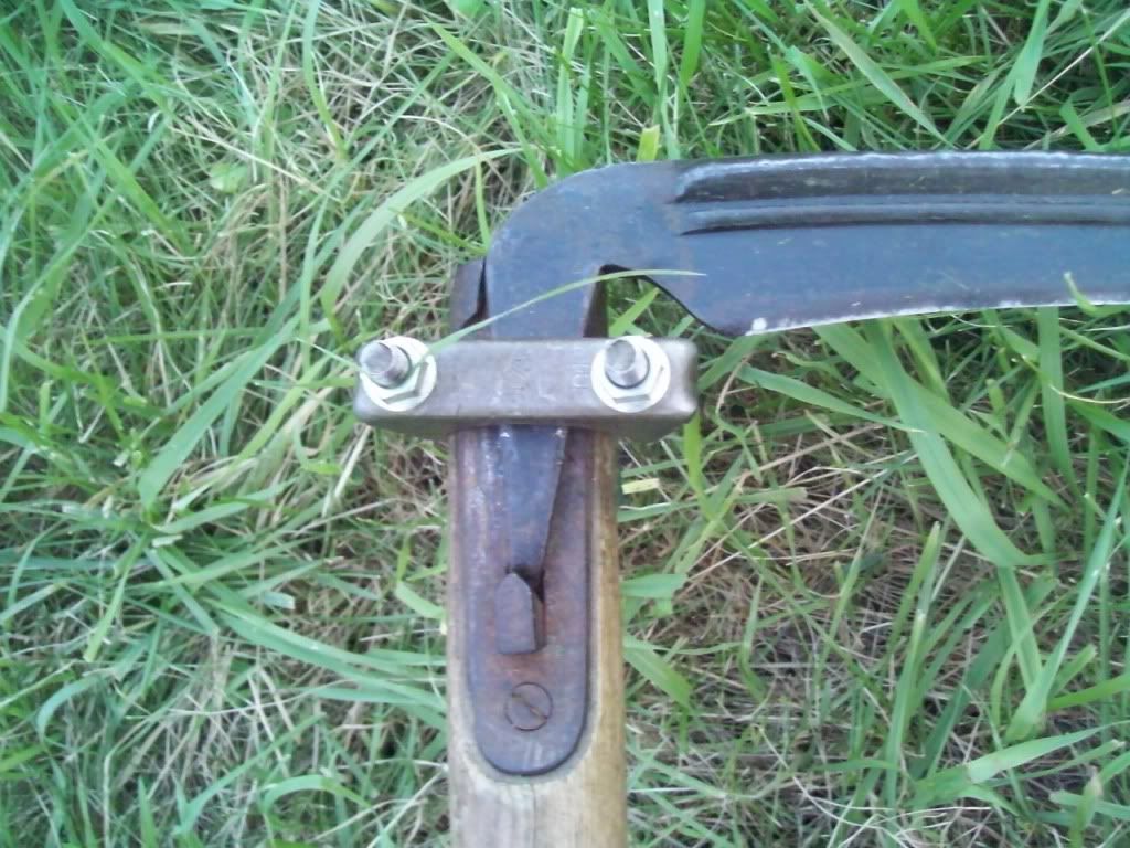

Pics, sorry for the delay.
Attachment, it's worked great.
Looks great! To help snug up the attachment try sticking a piece of scrap leather or rubber in between the tang and the U bolt. Helps keep everything locked tight after extended use. :cool::thumbup:

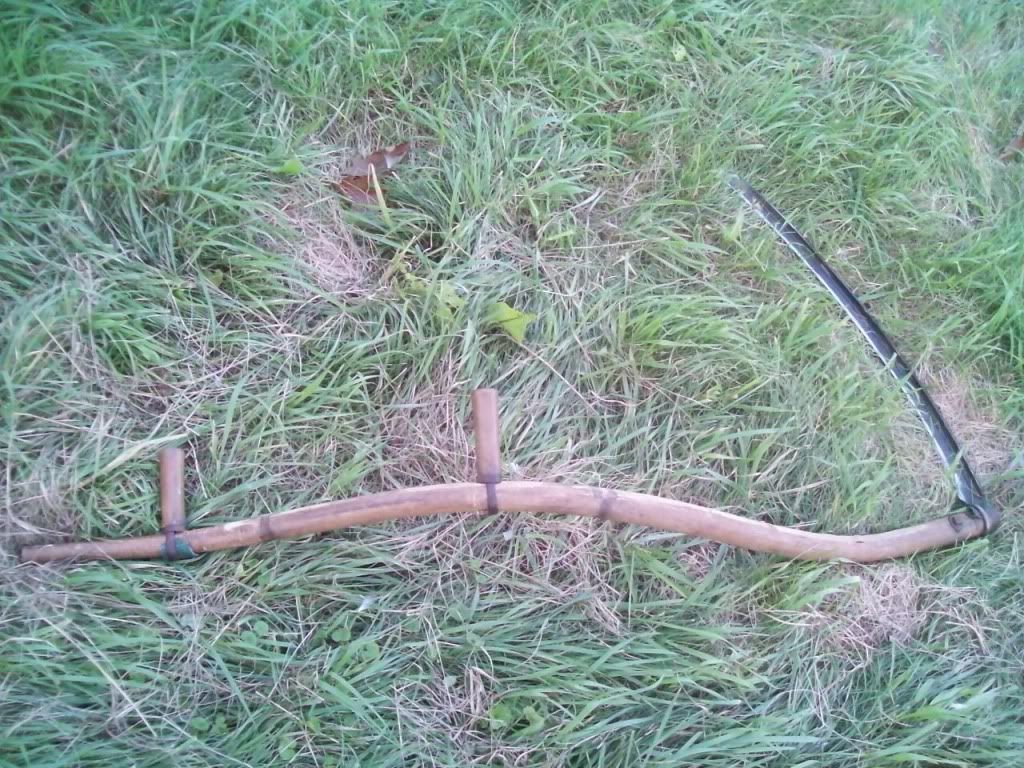

Picked this up off of craigslist today. $5. Needs some attention for sure, but everything seems to be sound.
Stamped "Austria"
Looks like an old Seymour snath. I imagine their current replacement nibs would still fit that one. Just use a wire brush to clean up the rusty fittings and then soak the crap out of them with penetrating oil to loosen it all up and get moving parts working again. You'll also want to oil the crap out of the snath so it won't be so brittle from having dried out. Nice snag though--that blade looks to have a very nice shape to it!
