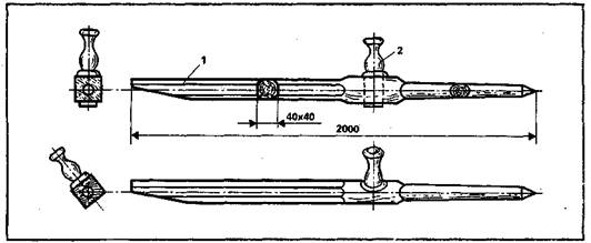

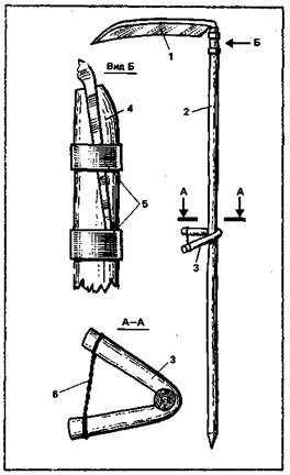

As far as tang steepness goes, the bend in the neck minimizes how much of a bend is required in the tang. It's the whole reason why bends exist in snath necks at all. ...
But as you know, the Russian one-grip snaths are still typically straight, avoiding the need to steam-bend them. The accommodation for steepness is usually done at the blade attachment, with a taper and/or wedge (in addition to whatever angle the tangs have from the factory). Some tradeoffs are involved, of course. (From your earlier posts, I know that you have that induction heater, which is why I asked.)
Thanks for sharing your prototypes with us! I think it's great that you're working on these developments.
For those who aren't familiar with the Russian (or Slavic) snaths:
from http://scytheconnected.blogspot.com/2013/12/russian-variations.html
Yup! This isn't a Slavic snath, however. It just superficially resembles one, since it's mostly straight and single-gripped and happens to be shown here with a Russian blade. The angled cut on many Slavic snaths only works with a cut that runs the full length of the tang, which generally requires a thicker shaft than I'm using here (1.25" diameter) so they usually would use a light wood like poplar for it instead of ash, like in this example. :)
