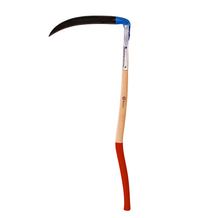

How long are those two Norwegian blades? Some time back I (with help!) posted a link to a Norwegian using a short scythe on a hillside. Is a scythe like that one available in the USA? I ask as I am using a serrated blade on what looks like a golf handle to do the edge of my lawn, and would like something sharper, but a full sized scythe would not work. I have a Stilh weed wacker, but do not like to use it, noisy and figure the exercise with the human powdered device is more beneficial, certainly to me. John
You mean like this?
These are short-ish but definitely full scythe blades. Arti of Russia makes some short-bladed weed cutters, too. A little too heavy and with the removable blades to be considered as "long handled grass hooks" but too small and light in build to be called full scythes either.
Click on the image and it'll take ya' right to the item page. Arti's offerings in a similar style are here and here.
