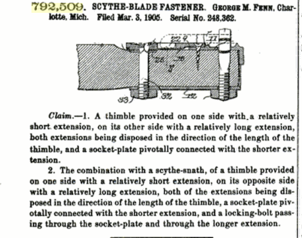

That patent has nothing to do with the blades nor snath in question, from what I can see.
Incidentally, Horatio S. Earle -- the patent holder in the link you posted -- was a salesman for (and eventually became head of) the famed North Wayne Tool Co. Many products bore the name "Earle Special" after him. He also patented a great many tool improvements and had an active political career.
!@#$%^& links! How's this? It matches the provided patent date in the ad.
Yes, that one seems like a possible match. The diagram is garbage, but based on my knowledge of the hardware I'm thinking of that phrasing could be used to describe it. The "thimble" description is used because the collar has a fully enclosed end, as if you had a thimble on your finger and your finger was the shaft of the snath. The longer projection is the top strap that extends off the collar ("thimble") and the short one you can't see, but it's a short loop coming off the bottom of the collar, and a single-holed swing socket heel plate is held in place there by what seems to be no more than a wood screw, while a carriage bolt holds the heel plate in place with nothing more than clamping force. The overall design is one seemingly destined to shift if the blade ever snagged, and the heel plate is made of stamped steel, rather than cast malleable iron like most snath hardware at the time. A mechanical means of locking the plate in place like Derby & Ball did with their serrated heel plate and recessed bed plate was overall a sturdier mode of construction.

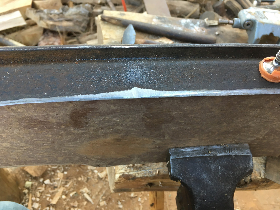

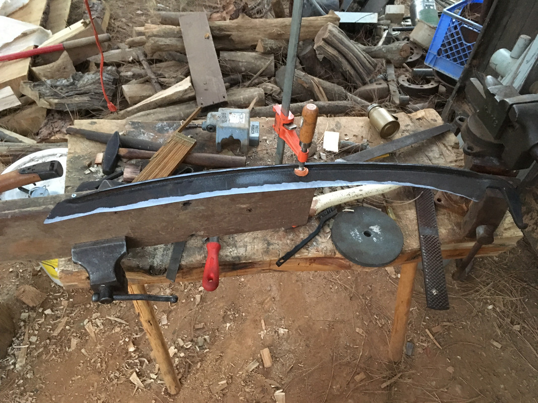

I spent a good portion of the afternoon working on thinning the bevel on my grass blade. My right arm is kinda sore but it should cut way better. The only problem is I'll have to wait till next year to find out. A comparison pic and the final product.
I think the !@#$% bevel angle was why it sat in the attic of a barn for 20+ years and probably in a shed for who knows how long before that.
Yeah, pretty universally blades in as-found condition are thick as hell in the bevel. I'll usually start grinding one at the proper low angle and take a look at how far back from the apex the grinding it occurring. I've usually got at least a solid 1/8" in front of the grinding marks that are still untouched rusted surface after the first pass. :p
