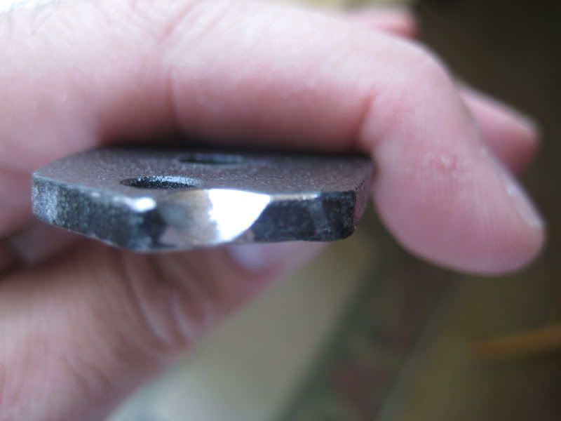

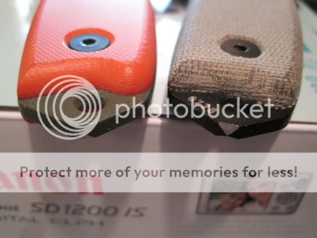

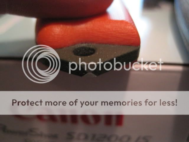

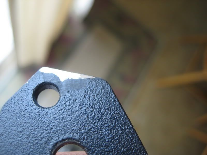

Here's one I put a shango notch on - still deciding whether or not it was a good idea :)
I used a dremel tool.
The half round notch on top helps to direct the shavings down and then striking with the back of the notch will shower sparks. I don't carry my sheath on my belt, but in my front pocket so it is pretty convenient for me to strike with the sheath on.
Here is the videos using the notch. I like it!!!!
That works pretty good. You could also put a notch on each side of the top of the blade (next to each other), just forward of the thumb serrations. That way you could use both notches without flipping the blade over, whether you are right or left-handed.
