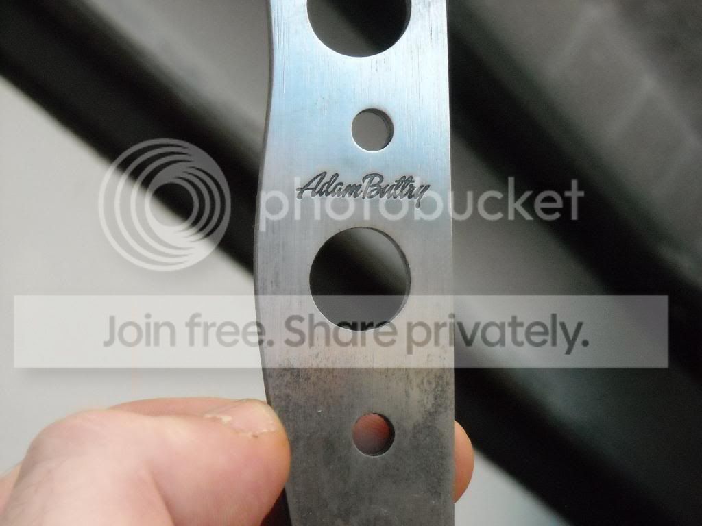

Another vote here for the Personalizer Plus. It's a solid unit with variable voltage output (0-24 volts at 3 amps). It comes with a carbon block applicator pad and a good supply of pads. You also get electrolyte for carbon and stainless as well as a bottle of cleaner/neutralizer. Pretty good deal for what you get in the box in my opinion. I was having some trouble with it at first producing a clean etch and mark, but after experimenting with different settings and hold times I think I've finally got a mark worth putting on my blades. Here's a shot of my last practice etch and mark.

I don't want to sound argumentative, but I strongly disagree. While I am new to using these machines, I am already seeing the benefits of selectable output voltage and I think there is a reason you find many professional makers using machines that have that feature. I've quickly realized that there are many variables when attempting to etch and mark steel. Having the capability to fine tune the output based on those variables is never a waste in my opinion, even if it's rarely used. I would much prefer to have a machine with variable voltage if needed, than to need it but not have that capability available to me.
