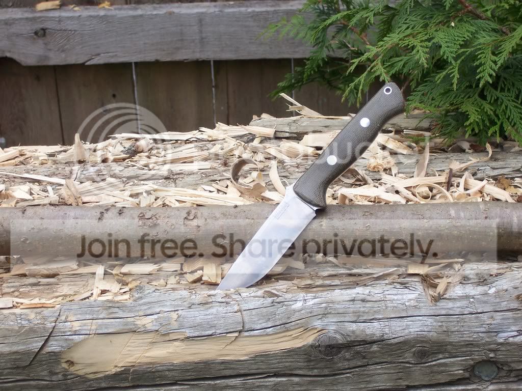

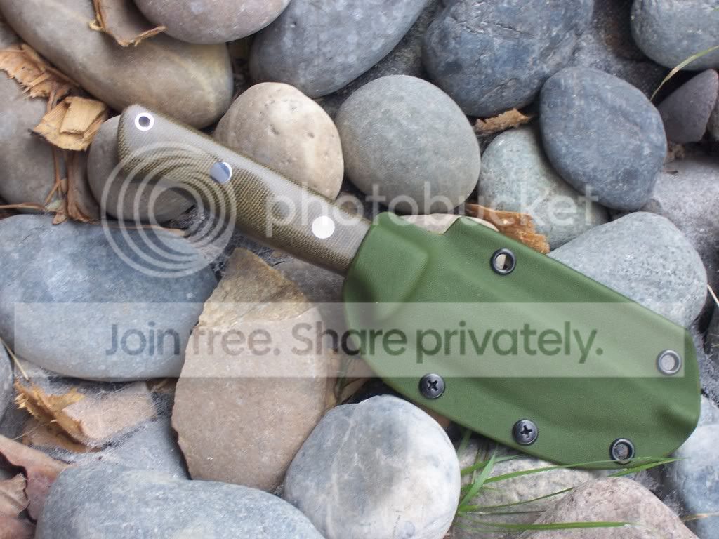

After using the Bark river bravo-1 for several days I am ready to give my expert opinion.:D

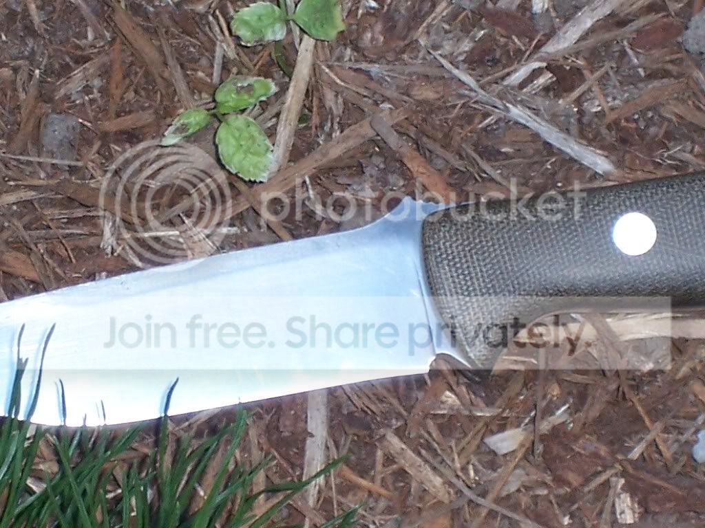

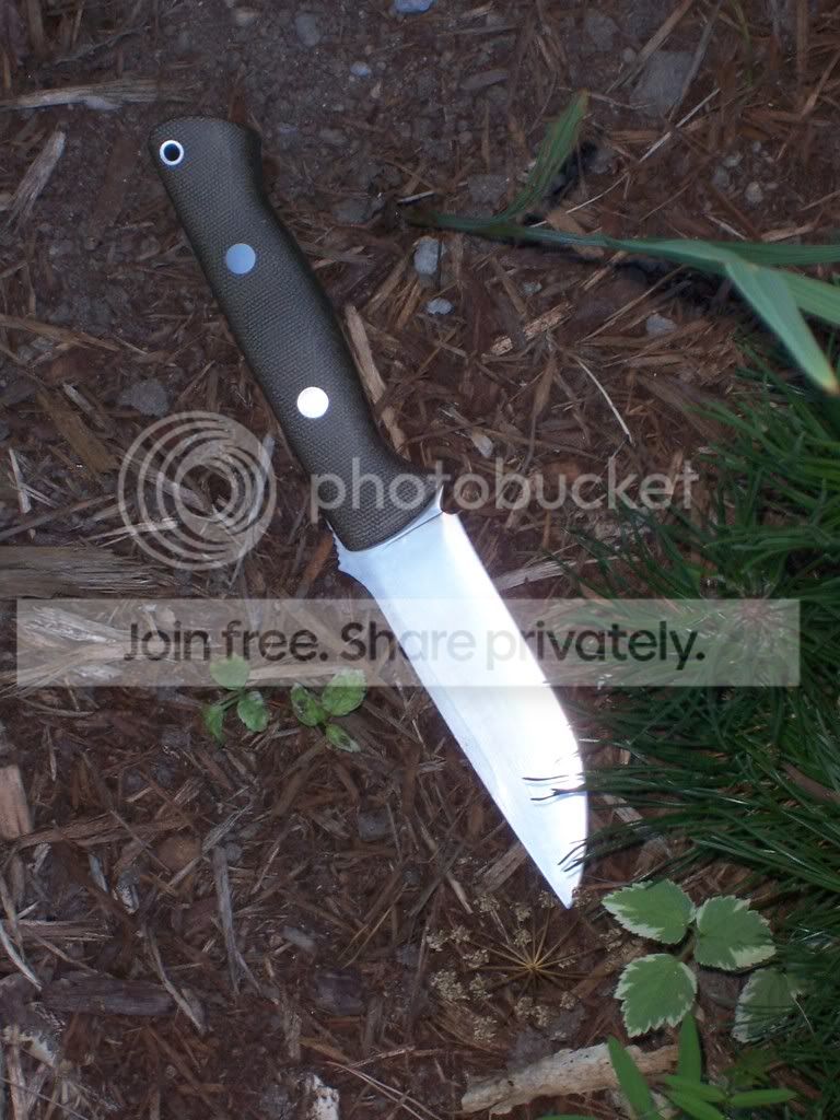

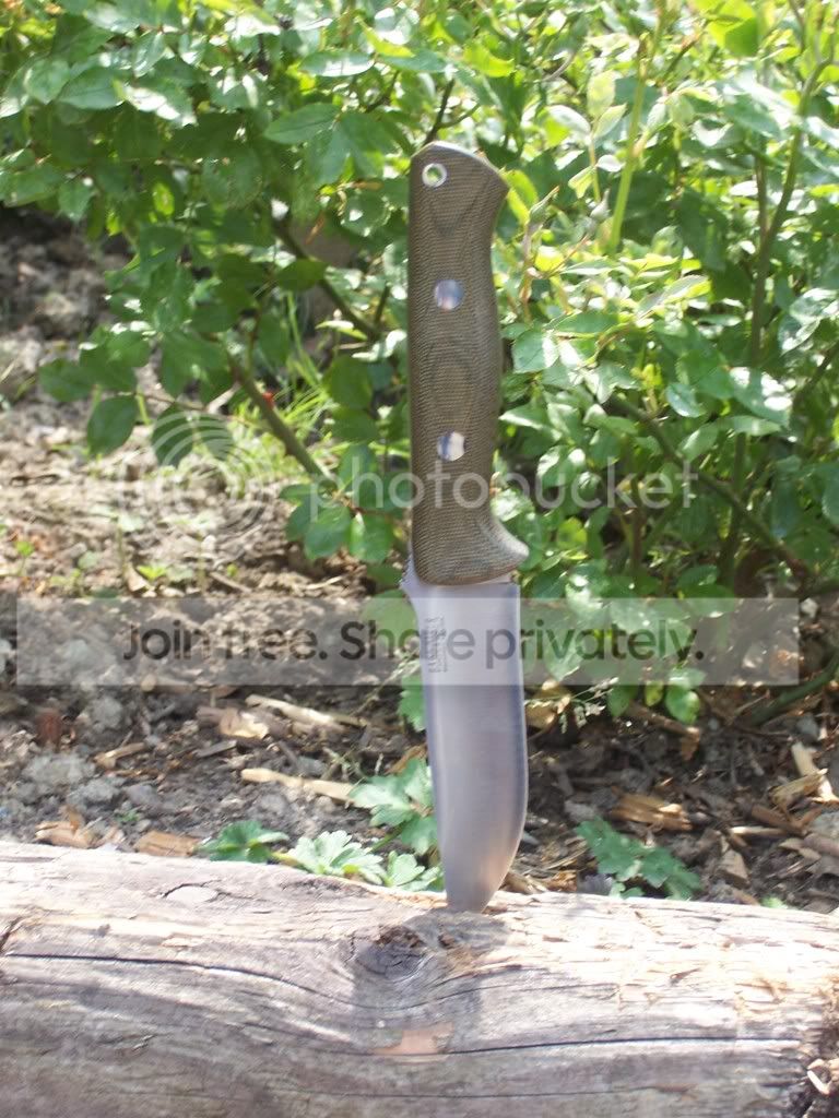

Initial impressions- It felt great in the hand and incredibly solid. It feels bigger than it is and is about 1/4" thick at the spine. I was at first worried about it not being a good slicer but I was very wrong.
some pics of it all new and shiny,

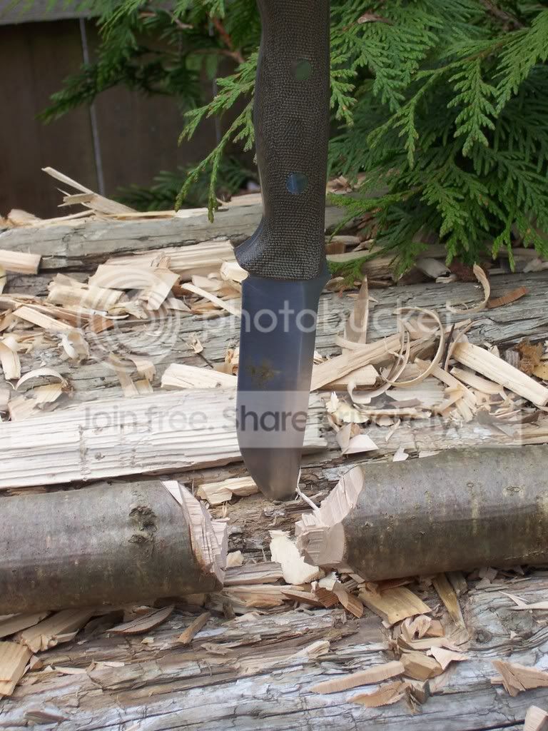

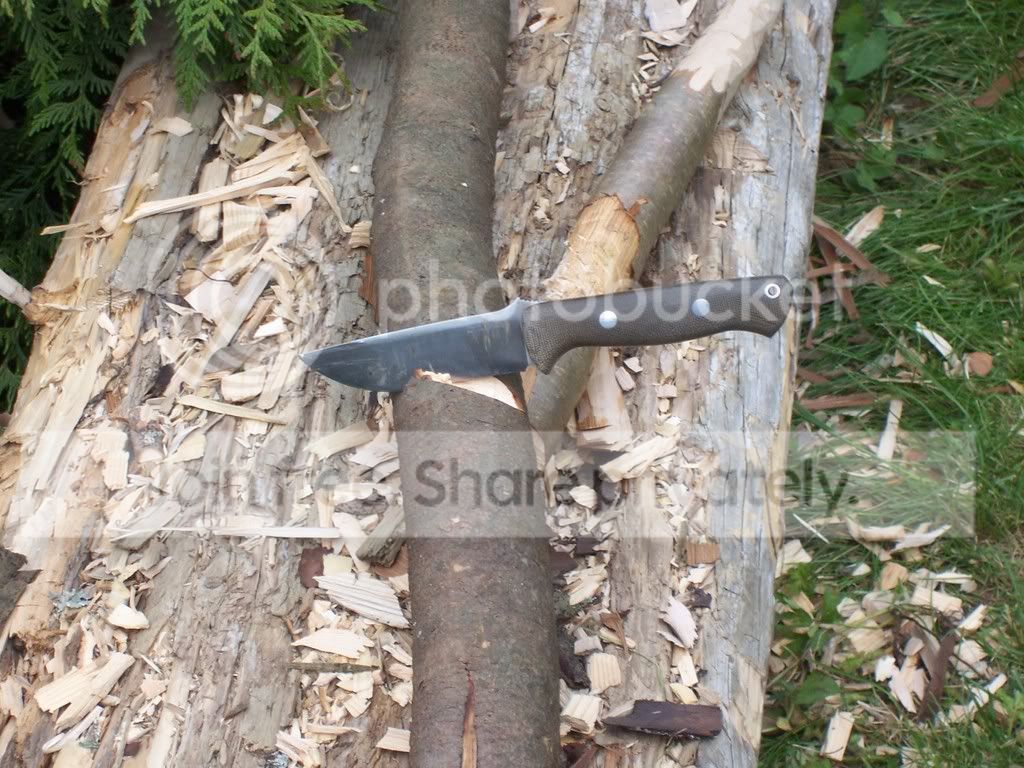

Chopping,
Altough with a blade of this size, batoning in usually preferable, you might need to chop a little to actually get the baton. Now amazingly, the bravo-1, though being a small (4.25") blade, is heavy enough for light chopping.
I chopped through this rougly 2.5" in diameter dead log (either buckthorn or cherry, can't say for sure) in 1:12 minutes. :eek:

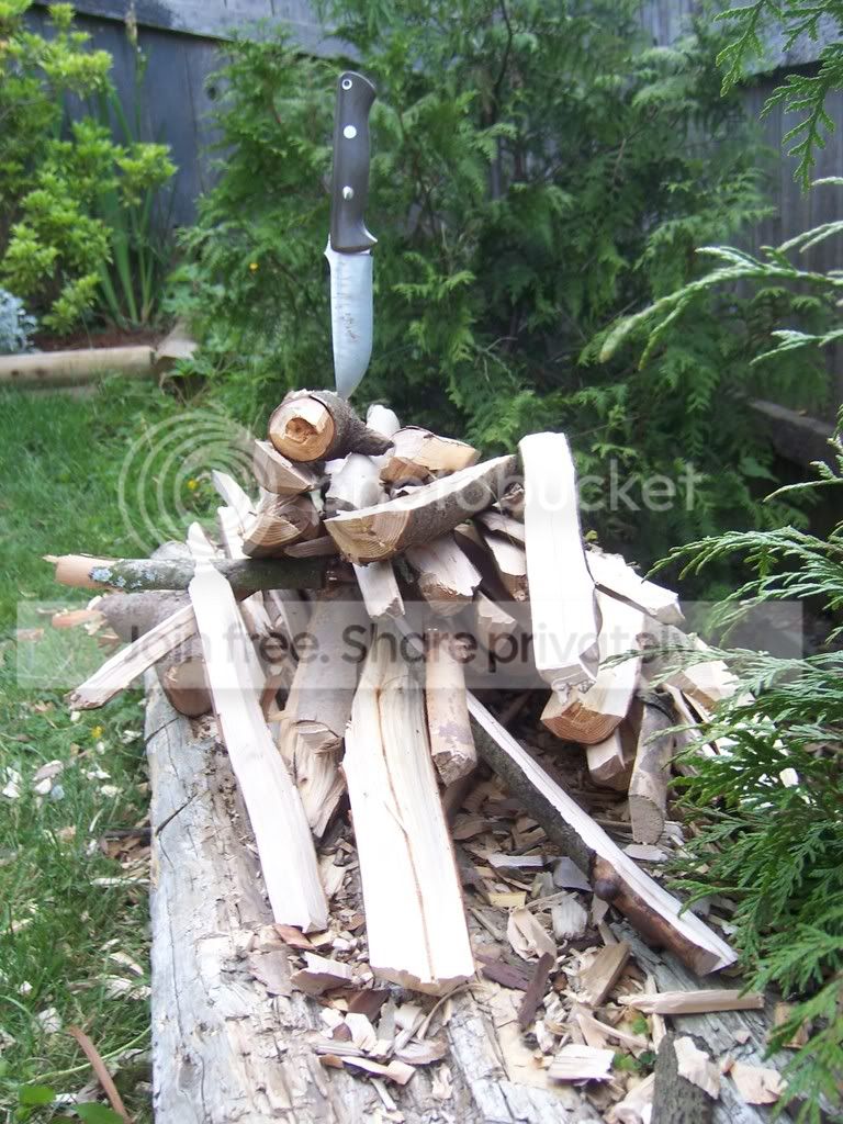

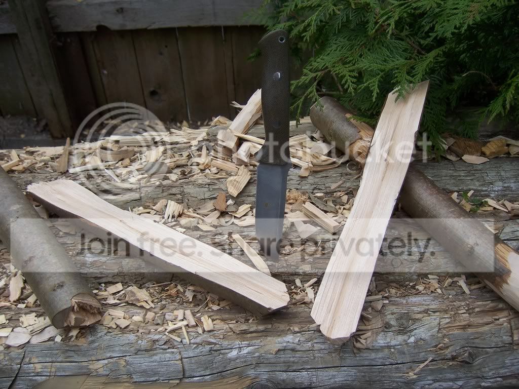

Batoning
Not much to say besides it does a great job, went through knots and all that without a hitch. Among the woods I battoned were cedar, hazel and the cherry/buckthorn. The cedar was pretty thick with alot of knots too.
I now had a nice pile of wood for fuel

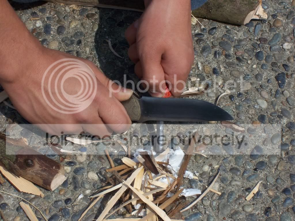

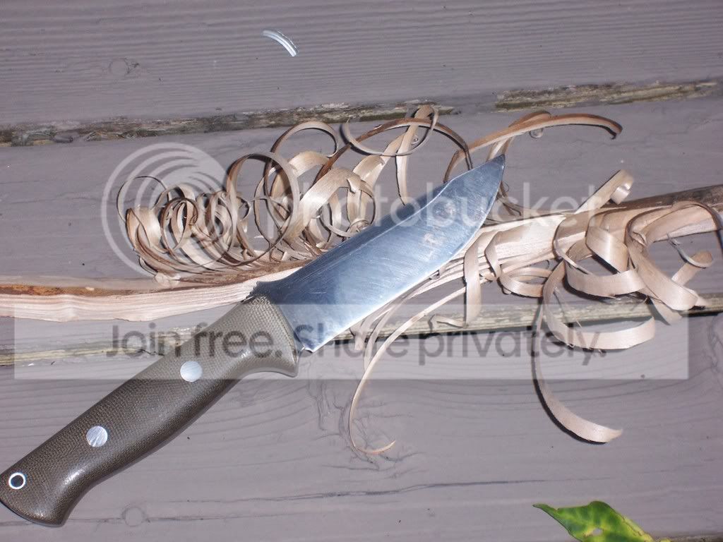

Fuzzsticks/kindling
The bravo-1 was also good for fine work, I made some really nice fuzzsticks and split wood into toothpick sized pieces.
Continued......

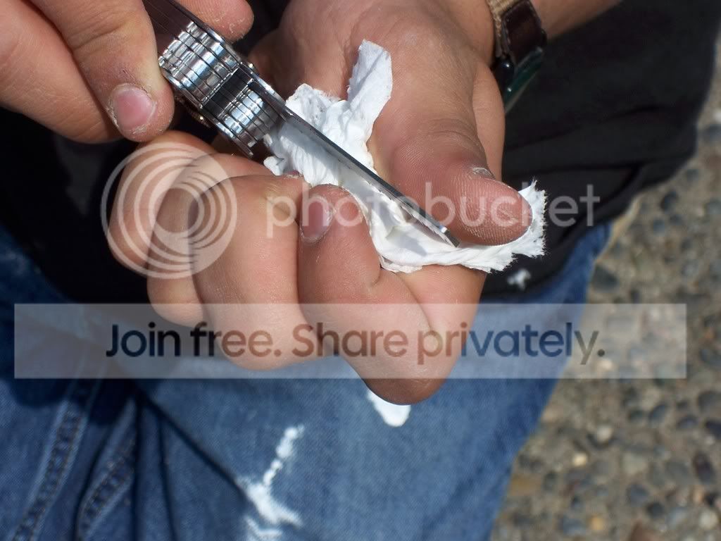

I cheated a little by using the saw on my swisstool to fuzz up the tissue so it would catch a spark easier,
And the spine of the bravo-1 threw great sparks,

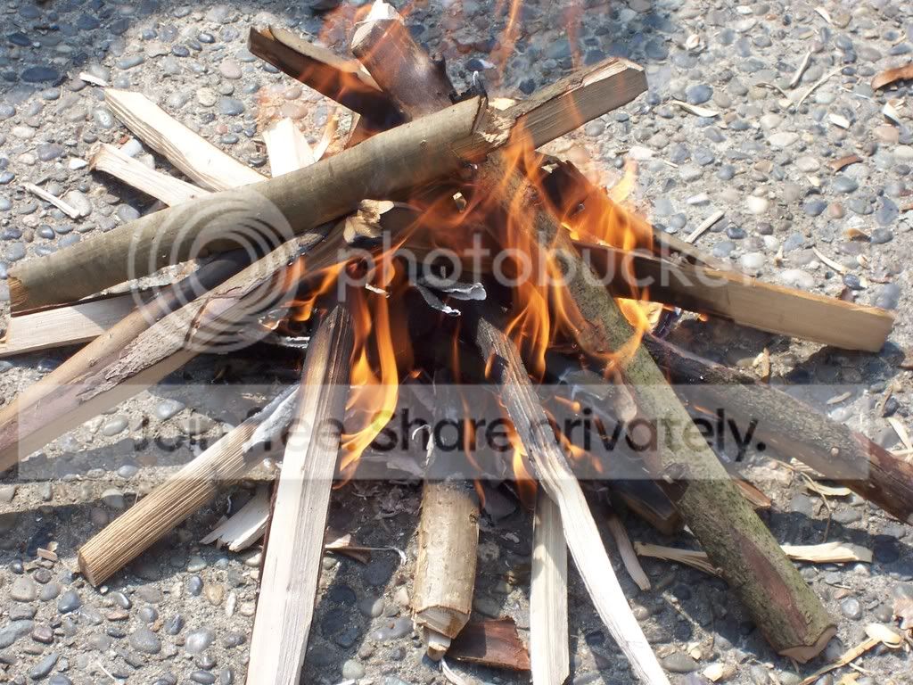

Soon, I had a flame going,
Which turned into a nice steady fire.

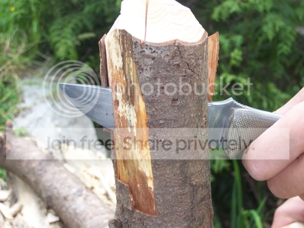

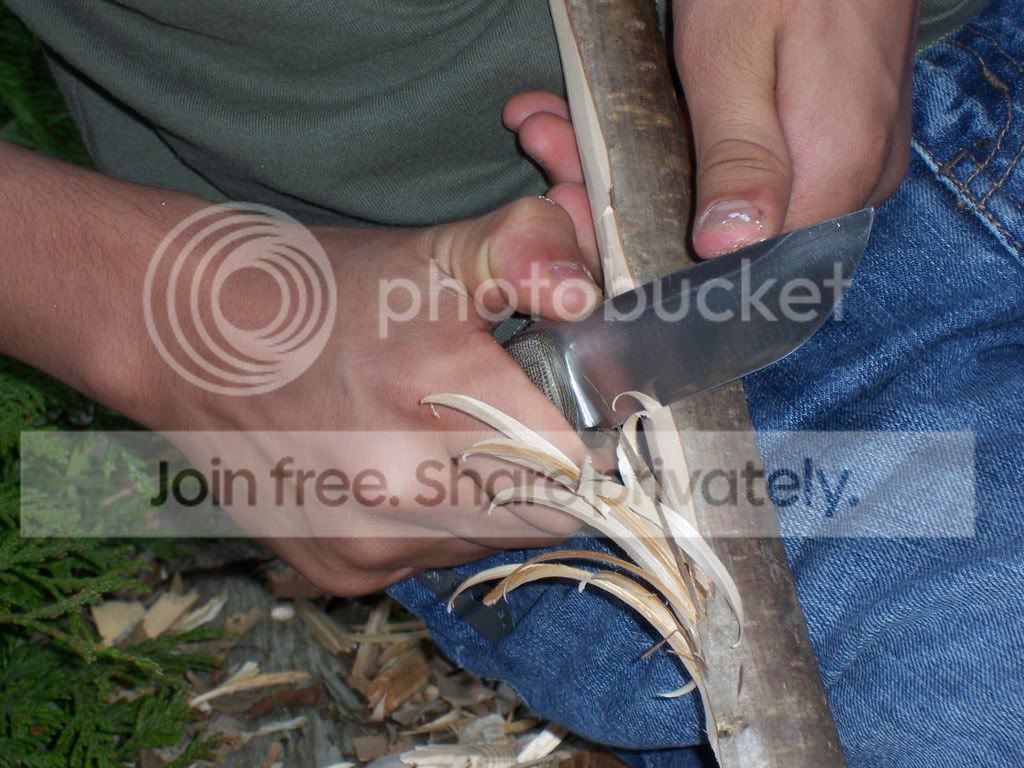

Whittling/Carving
Once again, it performed really well for such a thick blade,

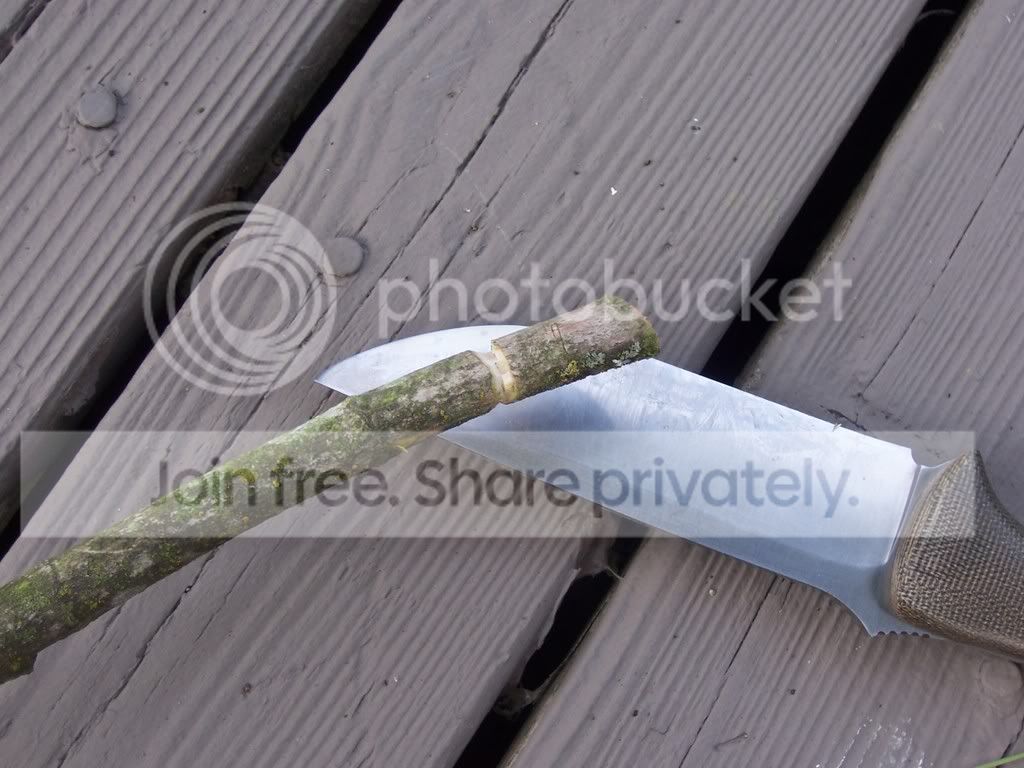

A nice notch,

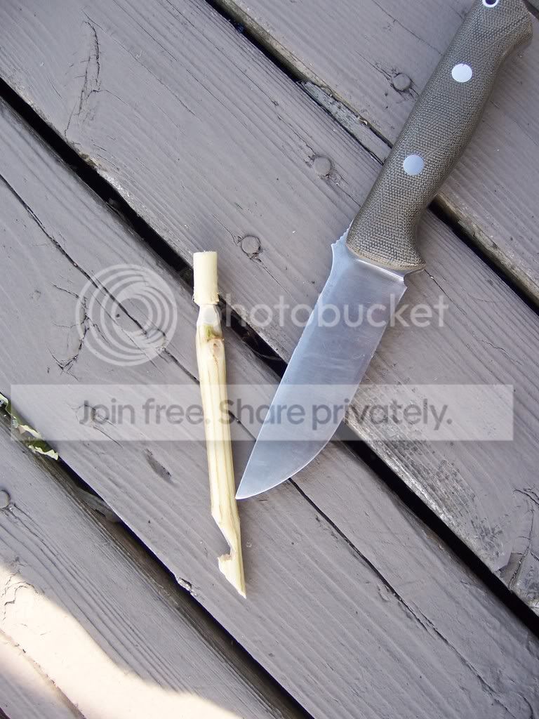

A trigger for a spring snare,

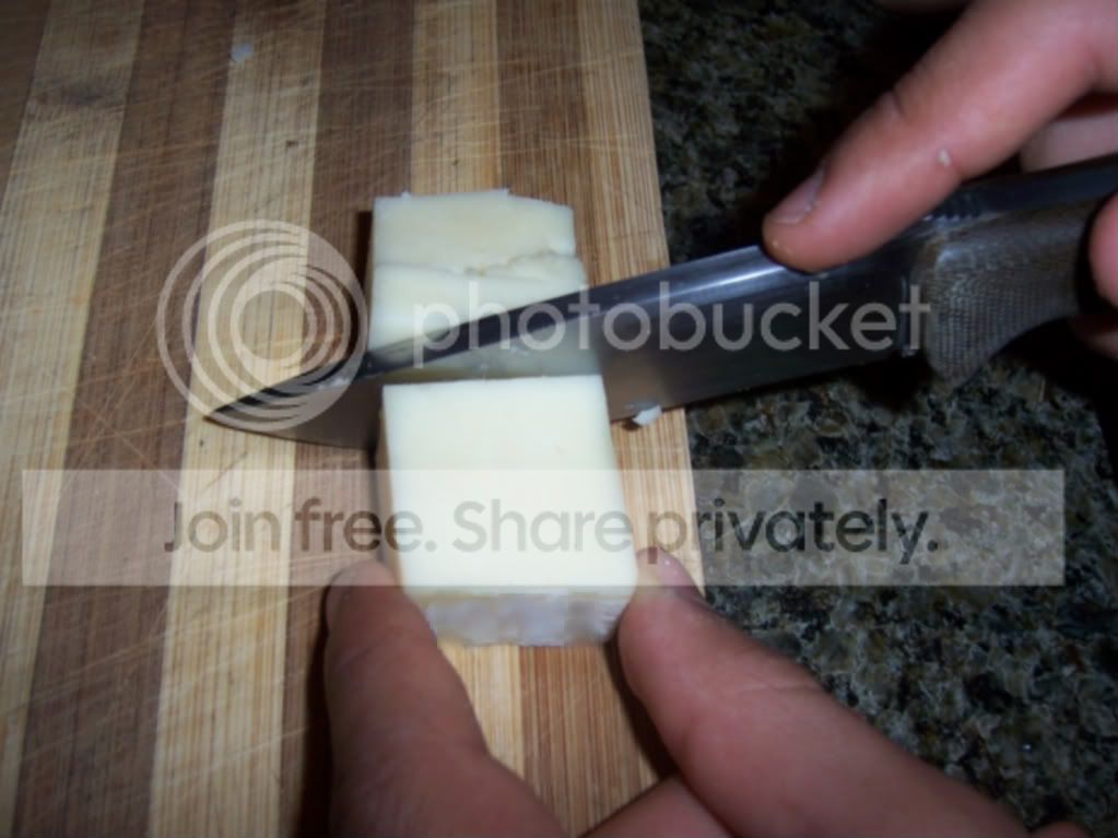

I didn't take many pictures because I used it over the course of a week and didn't feel like running to get the camera every time. (plus they would be pretty boring:o) It sliced almost as well as a dedicated kitchen knife, no complaints at all,
Cheese is a good test for edge geometry, hollow and saber grinds are the worst in my experience. The convex edge is great, just zips through it.

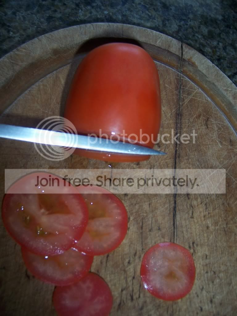

Tomatoes are a classic test and I could get very thin slices with the bravo-1,

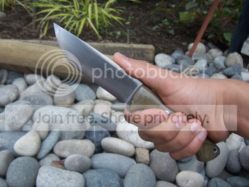

It fit my hand like a glove, the micarta was really shiny and smooth when it was new but after some use it became a bit rougher and dull. Im guessing its coated in some sort of wax but I could be wrong. I find that handles with grooves, checkering etc. like CS kraton creates hotspots and give blisters and the barkie handle is great for that, no blisters or sore hands but a great grip.

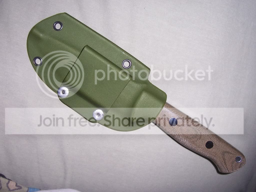

Sheath
Yep it's the only part of the knife I don't like. It's made of OD green kydex and can be set for vertical or horizontal carry. The problem is that it rides way to high for vertical carry and sticks out too far for horizontal. I will have to replace it with the leather one.

That in-hand shot is a big help, I didn't know it was so hand filling (always a big plus for me). I'd like to handle one of those some time.

As far as the sheath, two thoughts: first, the leather sheath BRKT makes for the Bravo1 is very nice, you'll probably want to get one; second, for the kydex sheath, you could remove the loop and thread it with paracord, in which case you could carry it horizontally and it wouldn't stick out nearly as far.
Great review, 3. You did a great job reworking the tip, BTW.
Buy the leather sheath - you'll like it.
