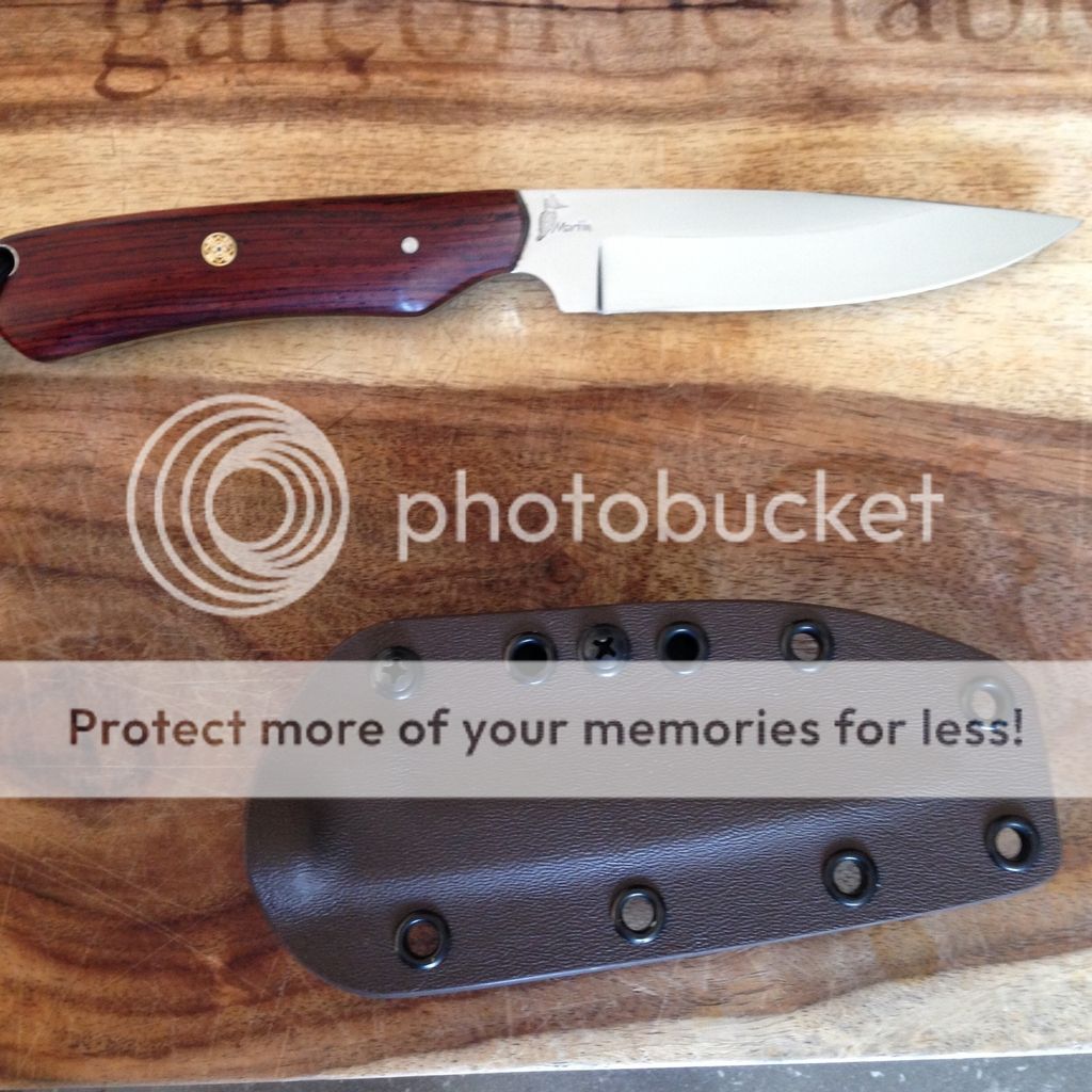

There is nothing wrong with GOOD 440C. The problem is there is so much of the chinese poor quality 440 out there that people assume that 440C is bad. I have some German Boker stuff in the store that is wicked sharp and performs great. I also just got in the Boker Saga kitchen line and it is all 440C as well. Outstanding stuff.
440C is good....as long as you watch where it comes from.
But hey....I am not telling you guys anything you don't know.
