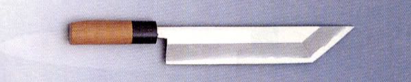

Traditional japanese knife for preparing Unagi
This example does not looks like traditional Japanese knife to me. Handle shape just way different then what they doing in Japan. To me this is bad imitation.
Here shot I made in Kukihide shop in Yokohama - nothing like this.
As well as www.dick.biz do not have anithing like this.
I really doubt this is real Japanese knife.
Now if you check any Leuku you may see same tip strong for penetration without this silly sharp corner, which make blade useless.

oh and about that "traditional japanese knife"...
why does it have an american Tanto tip?
real japanese Tantos are shaped much differently.

1 simple google search will come up with this:
http://www.mizunotanrenjo.jp/shop/search_e.cgi?&file=E.01&strings=EDOSAKI
http://www.japanesechefsknife.com/HSSeriesHonyakiGyokuhakukou.html
http://itkitchenknife.com/japanese.shtml
and finally...
http://www.practicallyedible.com/ed...s!opendocument&keyword=Unagisaki+Hocho+Knives
Unagisaki Hocho Knives
An Unagisaki Hocho Knife is a special knife for filleting eel.
The blade would be rectangular, except its nose is a straight 45 degree angle from top to bottom. This creates a sharp tip or piercing the head of an eel, and then dragging the knife along its body to slice it open along its entire length in one continuous motion.
The blade style varies slightly in Kyoto, Nagoya and Osaka.
Next time you doubt it, use google;)
Thanks, Vassili.
Just because the handles on santouko, deba and yanagiba knives have the same handle..doesnt mean ALL japanese kitchen knives are.
I'm sure you won't find his at that store either:
http://www.mizunotanrenjo.jp/shop/search_e.cgi?&file=E.01&strings=UDONGIRI
Thats used for cutting udon.
