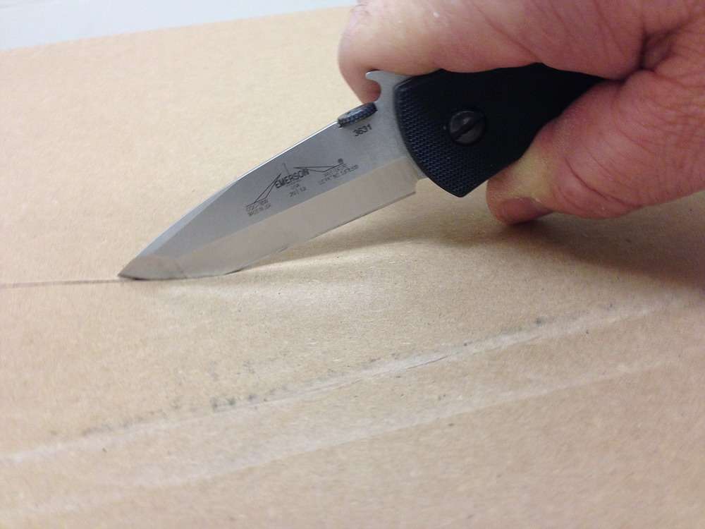

If you allow me, I like to share my point on the tanto thingy, without pushing it too much... :D Most of the blades I owe are tanto. I like to carry knife that was designed as a weapon, but I like it to be also functional and to allow me to use it for my edc task. Coming from probably 25 and so years I carry folders, without knowing too much of the facts how the "American" tanto was created, I am a strong believer that most people who are criticizing it never actually used one of those and never had chance to compare what one can do with it in regard to a normal folding knife with well pronounced belly or to the traditional Japanese tanto style.
The way I look at knifes is usually as a collection of elements that determine the intended by the designer function of this tool. One more time: It's a personal opinion but I think that the "American" tanto was designed to be a edc fixed blade knife with clearly "tactical", weapon like properties.
It combines the beef up element of the razor geometry, that gives you excellent slashing ability in the same time the thickness of the blade by the secondary bevel provides for heavier use. This part of the knife will slash, rip and chop easily and will still retain some decent sharpness in case you are out in the elements and have no ability to properly sharpen it.
In the same time, the tip between the razor edge and the triangular point is one of the most useful instruments for cutting stuff, especially placed on table, or on the ground, when your hands are straight and not much bent in elbows.
The interesting thing that nobody really pays attention so far in this thread is that when you use the knife in this way, you actually not touching the edge of the tip, with all the every day's tasks, you have a tip section of the edge completely preserved fot the time you need to stab something...
Perfect example of hard use on daily bases of a knife designed as a weapon with the Americanized tanto tip would be this picture, even it's not the "classic" American tanto outline you will find in most of the CS fixes and 2nd gen folders as Voyager i.e.
So this is what makes those in fact "westernized" not labeled by some "Americanized", new tanto breeds, so useful. I was using those for years, including really thick blades as CRKT's J. Williams's series of Hissatsu, Heiho and so on, I was heavily using my combo edges Voyager and BM 553, they all performed very well for edc tasks and at the same time I could use those for SD if needed.
